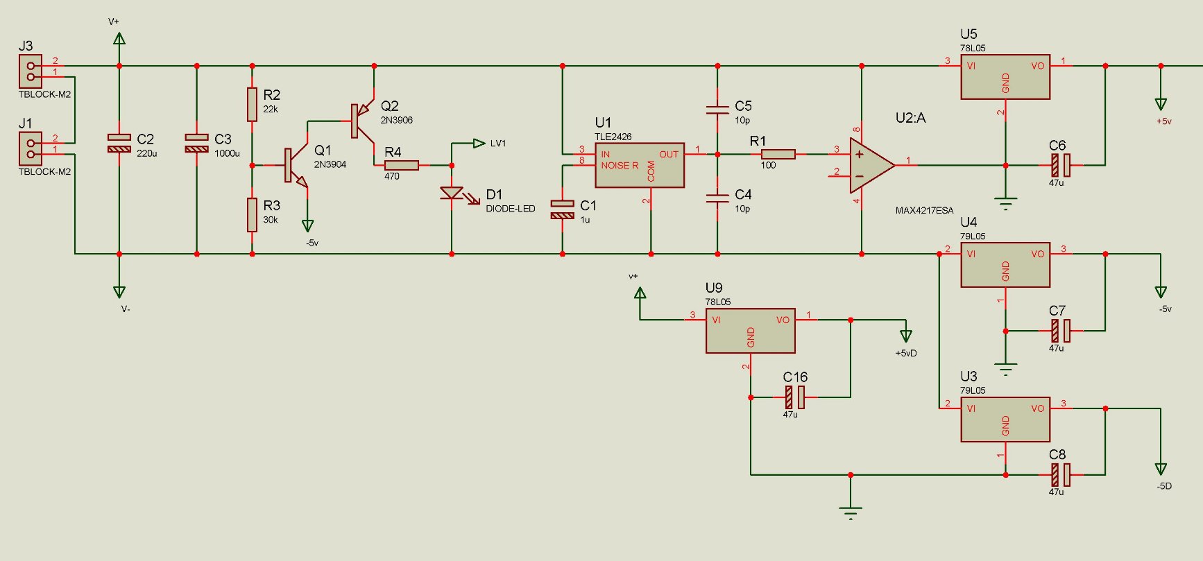

    OK...I'll play (even though I am probably the least qualified ).
    How about starting with that PWR supply? Here's my virtual ground version....
    Thoughts?
    You left pin 2 of U2:A floating. The 78/79 series of LR are getting old, have you consider using a little bit more efficient regulators? Put some small caps in parallel with the polar capacitors, say 47~100nF would do fine. Large capacitors like those you have chosen are no match for fast transients and spikes, a ceramic cap in parallel can give you cleaner power. A precaution though, when using aluminum electrolytic capacitors together with ceramic ones you have to test the combination. Sometimes that magical duo can cause more problems than it solves, and only testing the brands you are going to use can give you a clue on whether to use them or not.
    A final thought, have you consider not using intersections of more than three wires? I know that nowadays is difficult to miss the dot, but still it happens sometimes. I you don't use crossing wires then the problem goes away all by its own. I'm not that young anymore, but when I started drawing schematics that was a big "no-no". I think even Winfield Hill preaches about that.

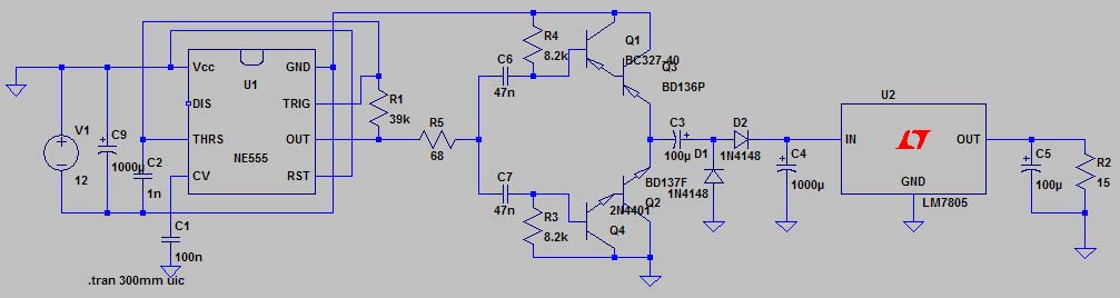

      Here is another power supply. I want to use the higher voltage V+ to drive the coil from -12V to V+.
      Since I am using an IB coil, the RX coil can be on GND to +5V.
      5V-VDD to drive the PIC
      Will this work?
      Any suggestions to improve the circuit would be welcome.

        Tinkerer,
        I don't think the inverter pump will supply the current you need to drive the TX. The HFE (~50) of the pump transistors is too low.
        You might want to try driving the in a darlington-like configuration (effective HFE ~10,000) like this:

          Thanks for the help.
          With the Darlingtons there will definitely be enough power. It has been mentioned that the linear regulators are old fashioned and have low efficiency.
          The modern switching supplies are much more efficient, but what worries me is the noise factor.
          How does the noise of the capacitor charge pump compare with the noise of a switcher regulator?

            Tony, I honestly do not know. I haven't explored the switching regulators. I would think that any noticable noise caused by the charge pump would be on the -12V line. The +-5V lines should be relatively clean as long as their input voltage is >6.5v. I haven'y noticed a noise problem from them. If you load the output of the regulators to the point that they draw down the inverter output lower than 6.5v, then you will start to get noise.

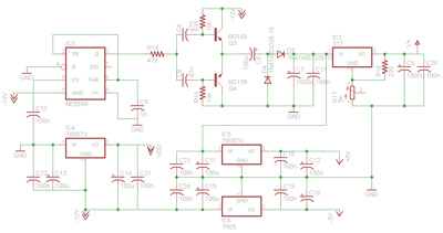

              Will this work?
              Tinkerer

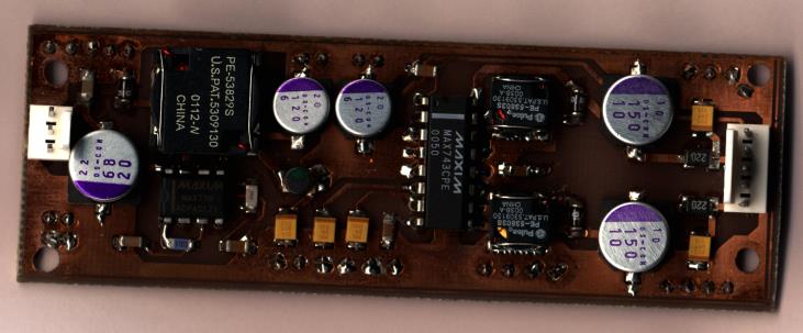

              A few years ago I needed something similar to what you need now +5, -12 and +12VDC. I only had 7VDC available, so I made the little board in the picture to test how could I tackle the problem without having to get a flyback transformer. This little board happily delivers +/-110mA (Tested) on the +/-12Volts rails and 500mA on the 5Volts rail. I must have the schematics and the gerbers somewhere in one of my backup disks, if you want I'll search for them, if this is too much for your MD then I'd rather not search anything. Oh, the output capacitors are rated only at 10Volts, but that is at 105C and I didn't have others and my board was cold, so I used those instead of the 16Volts intended in the schematics.

                Originally posted by gwzd View Post
                My eyes are not what they used to be! Can you post a bigger/clearer picture?
                Thanks for the offer. For my present need, the charge pump supplied by KingJL, will do just fine, specially since I have the parts on hand.
                However, I would like the help of experts, to design a complete, efficient power management for the new generation of PI detector.

                              Some good ideas on supply design. I spoze the first thing to decide is whether to support a mono coil, as that puts some limitations on the supply configuration. My preference is to ditch the voltage doubler charge pump, which means no mono coils.
                              The next decision is whether to use any switchers at all, or to use linear regs. I think for a first cut go with linear only. Later try switchers and see if they cause a problem.
