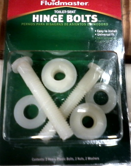

        For the fixing bolt and nut for coil, I noticed in the plumbing section some of the hardware for toilet seats is made out of nylon. Nice response on the scope shot.
          Hi Thomas
          The bolt nut and bracket for the arm i am finding the hardest to track down ,i would need to bolt the bracket down as well so thats a problem ...
          I looked in the plumbing section of Mitre 10 and i did see the toilet seats plastic bolts nut but i have not seen a nylon one if they are about we do have other hardware stores to check .

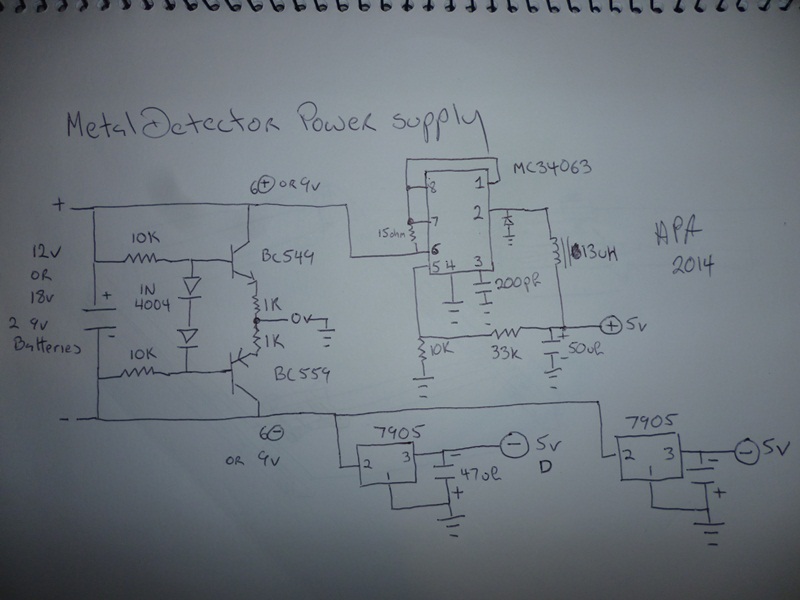

                  I spent the weekend redoing part of the power supply i stuffed up on the positive ground side of it ,i checked the dual supply side of things across the ics that use it and i had got it wrong no other way of putting it .
                  So i tried this idea the the transistor rail splitter but i lost voltage after the regulators .

                  I then tried another more simple floating ground with just 2 4.7k resistors 2 caps ,that seems much better .
                  I have tested it on the circuit replacing the the transistor version in my drawing and it seems ok now but have not tested the signal outputs of the ics that use that dual voltage part of the power supply .
                  If it gives me any more grief i will just use 2 batteries .
                    Simple is the way, with regs following, when the battery(s) get weak, everything stays close to balance.
                      Yep Thomas i suppose you are right there ,trial and error seems this was the way to go .
