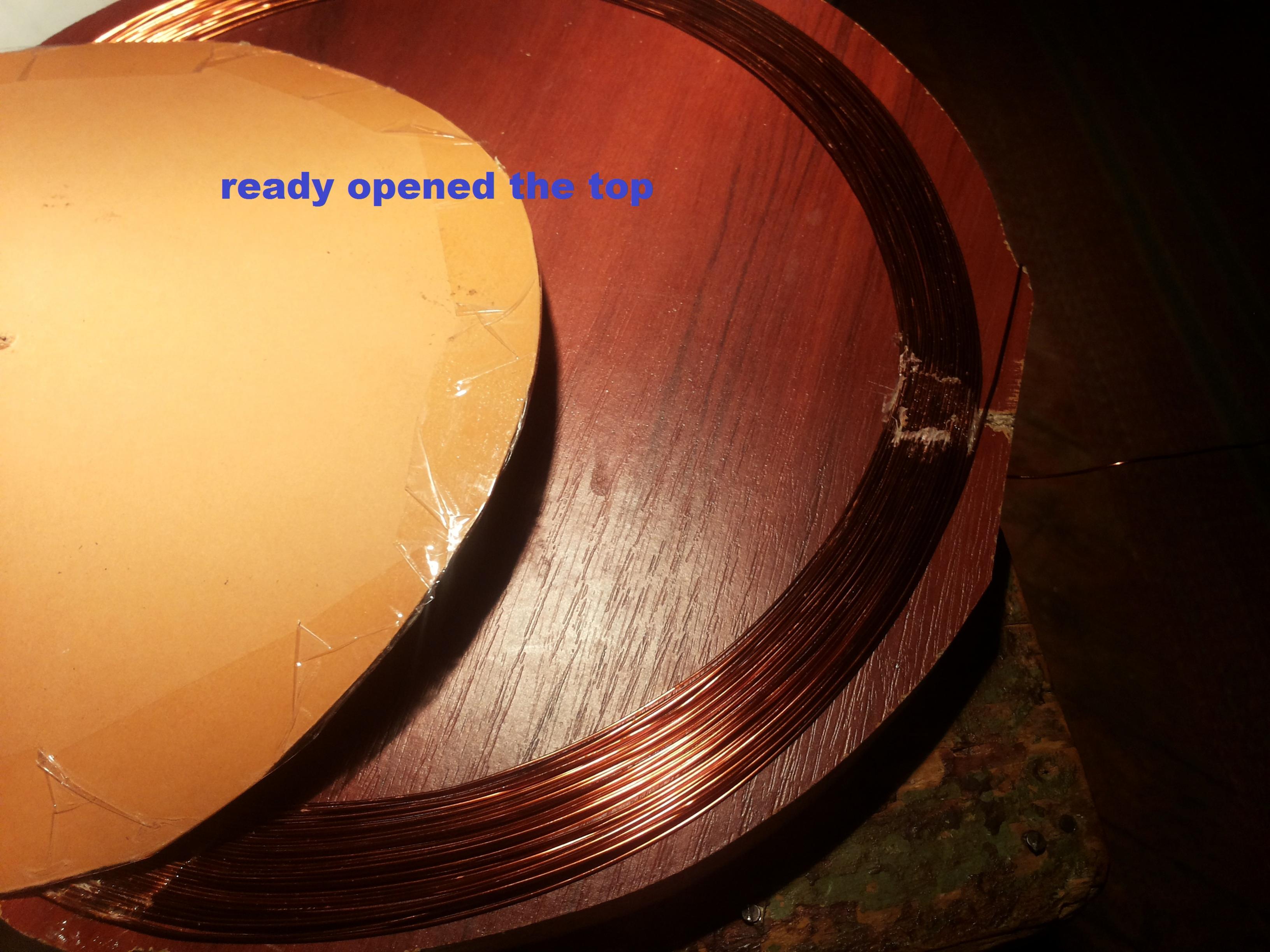

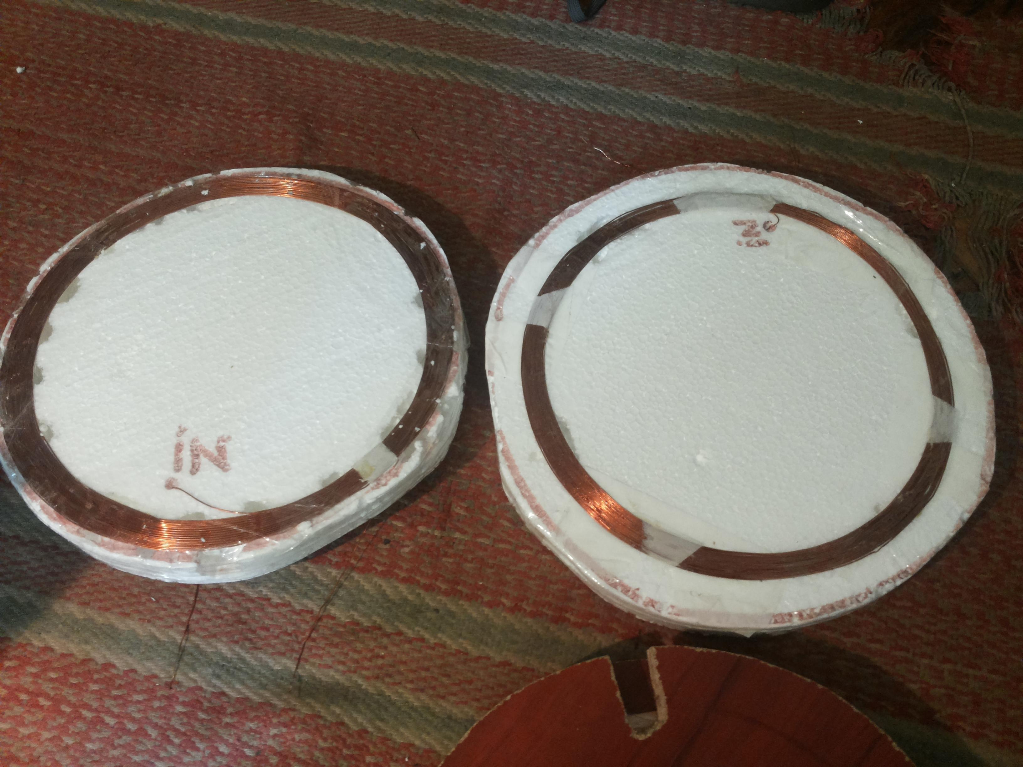

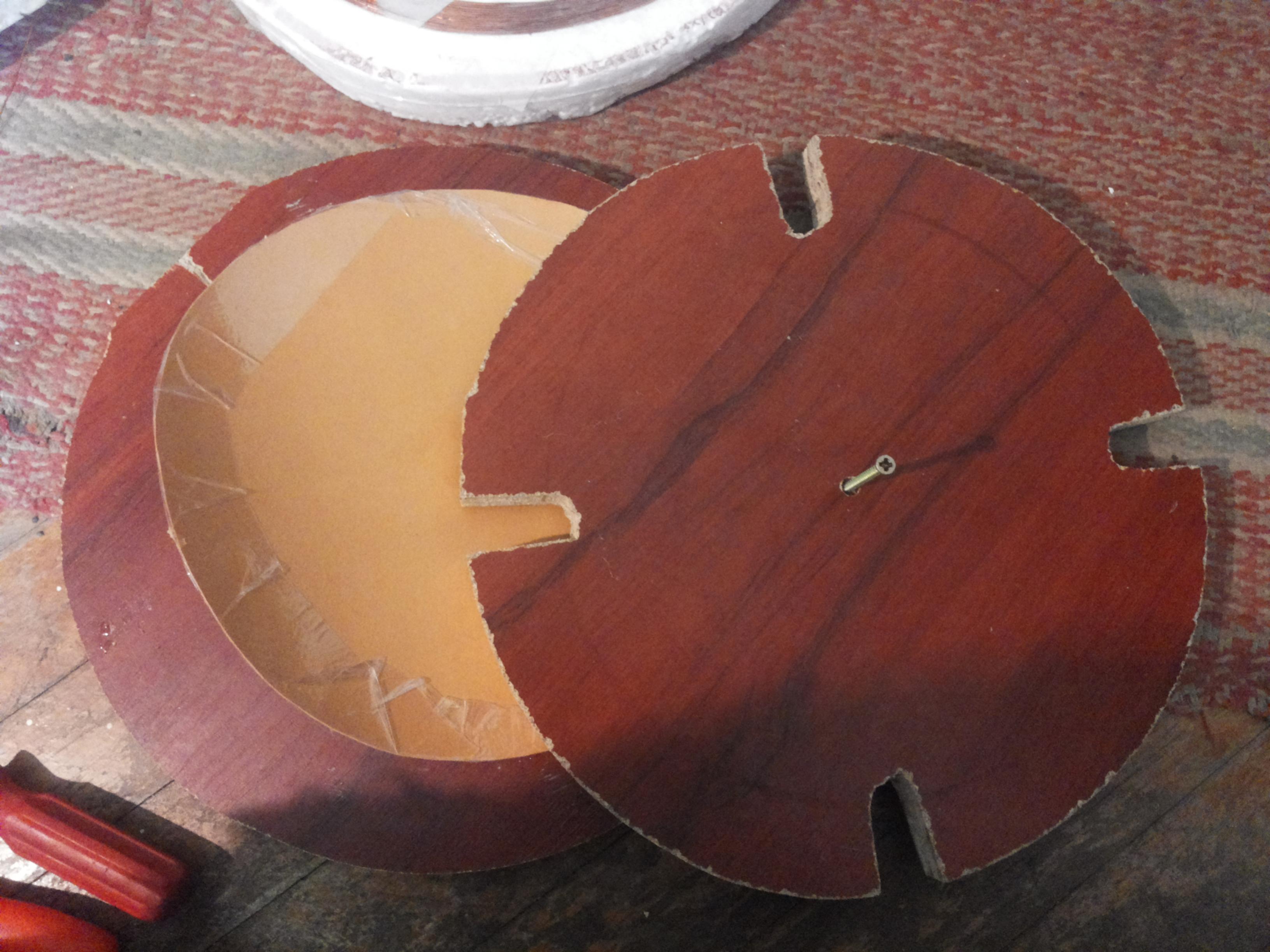

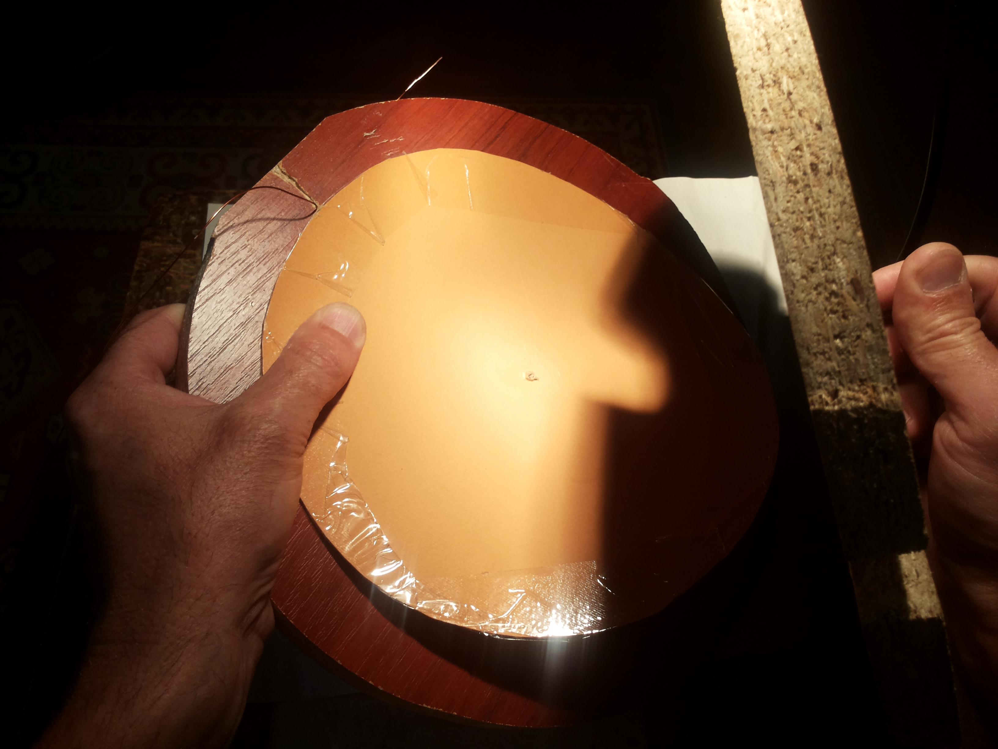

    my winding device for coplanar coil,and coil ...
      Should be good, but 99,99% invisible. At least for me.

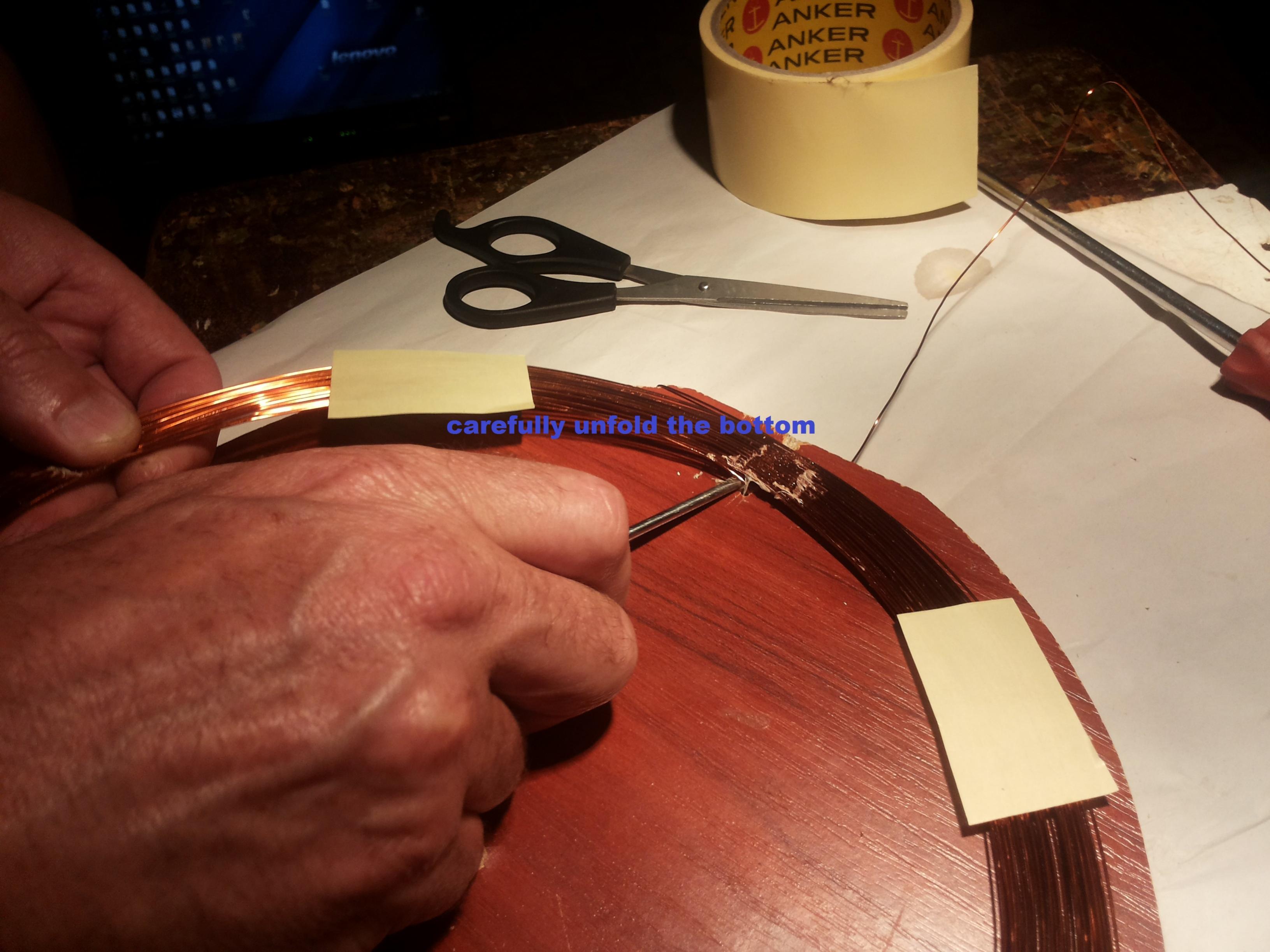

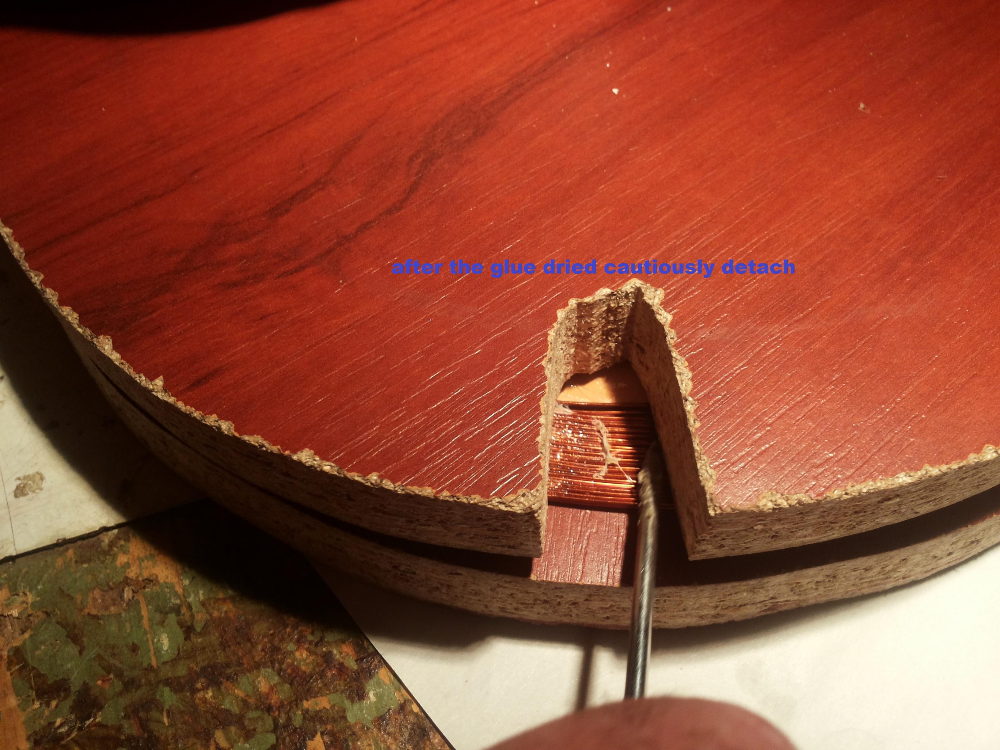

          Thanks. Must say, that from those photos, your winding procedure is not very clear for me. Can you post some more photos about winding procedure?

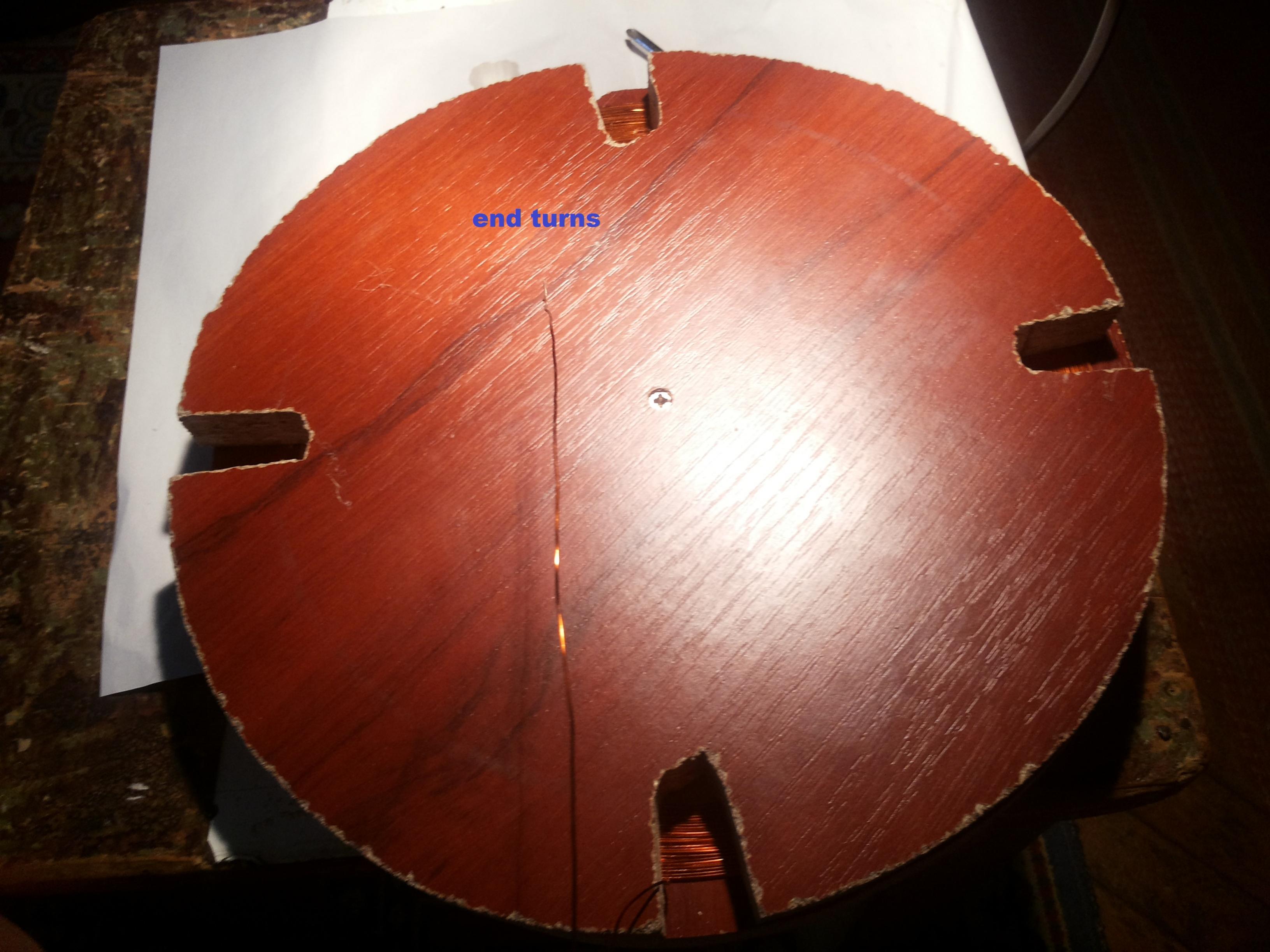

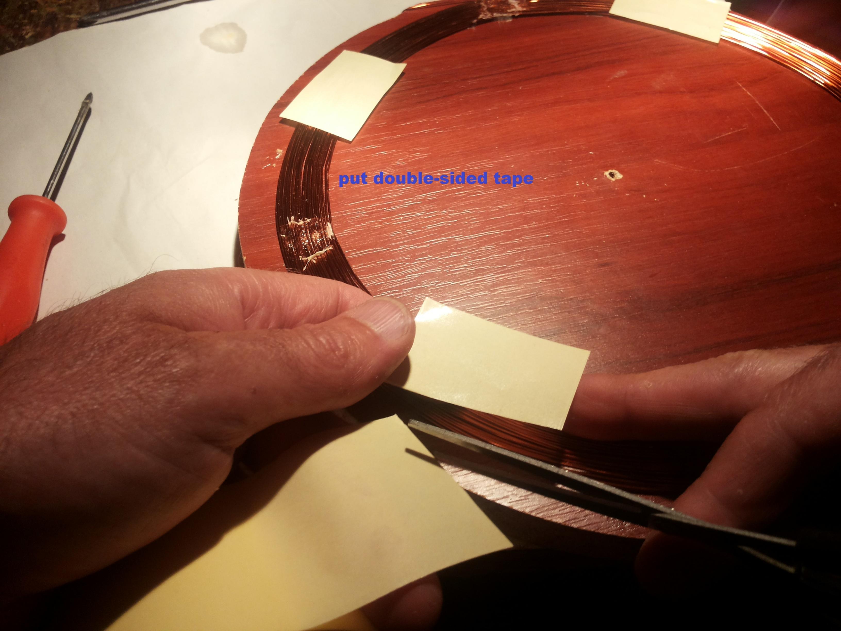

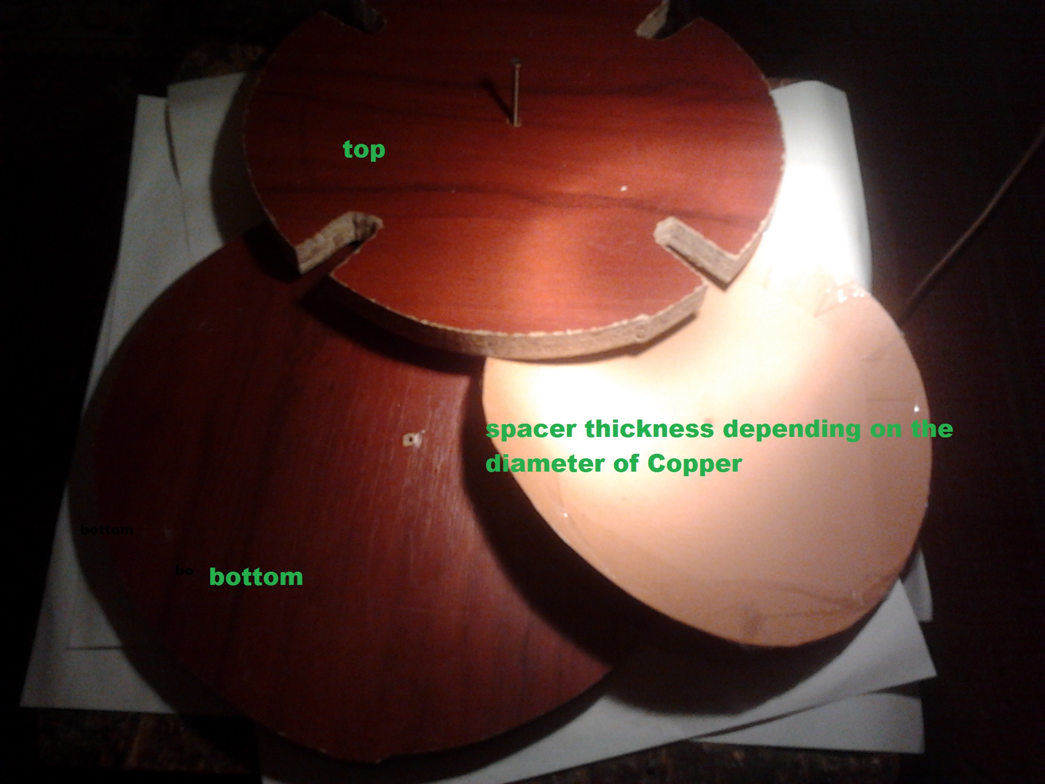

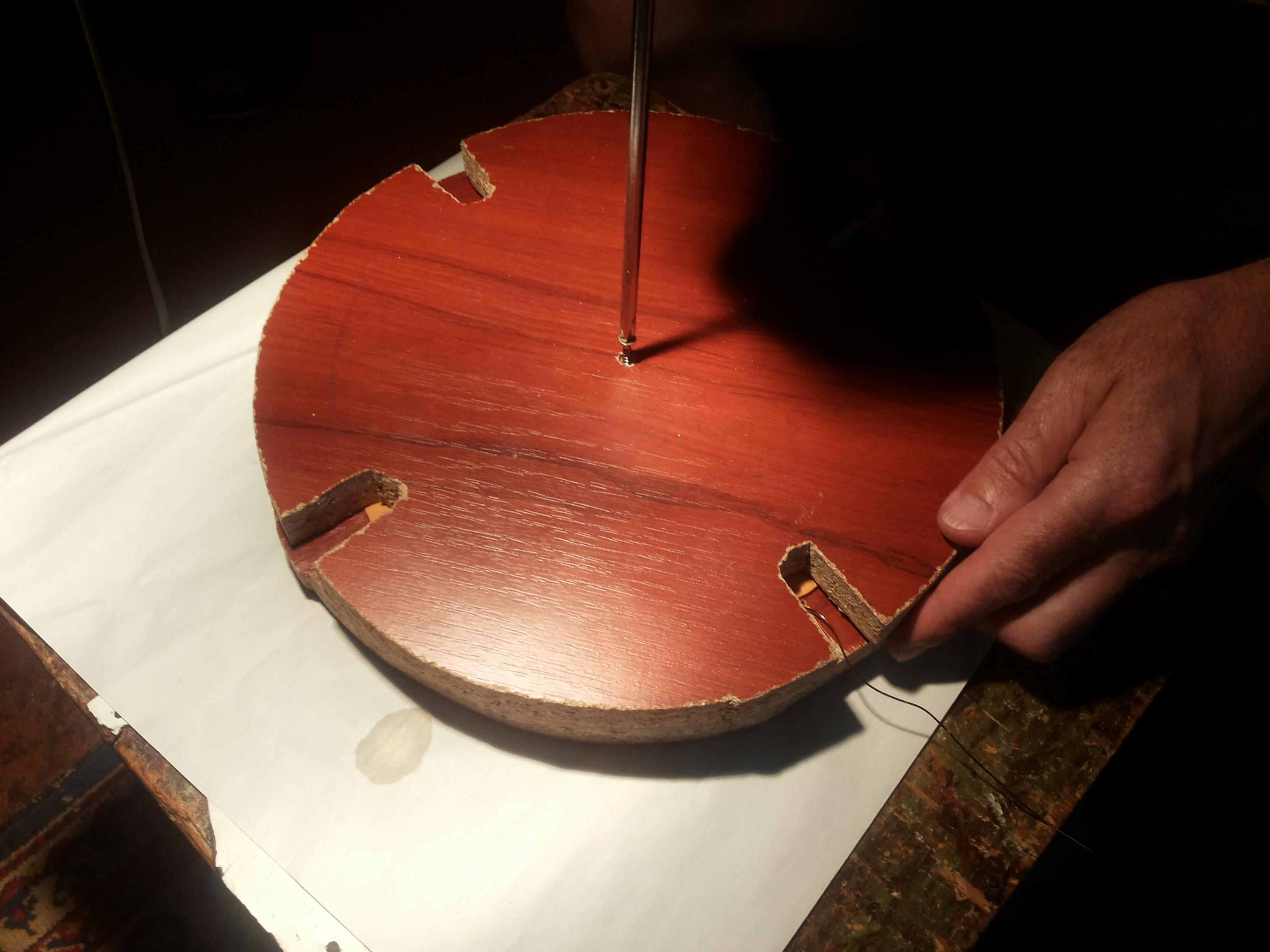

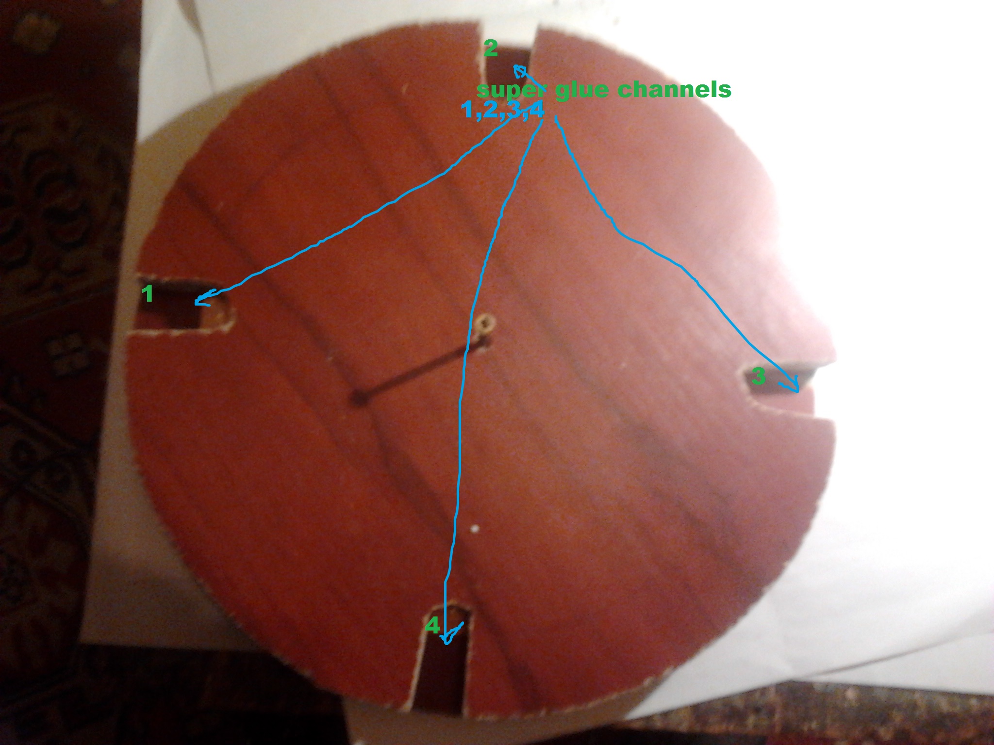

            explanation winding procedureClick image for larger version
ID:	340905Click image for larger version
ID:	340906Click image for larger version

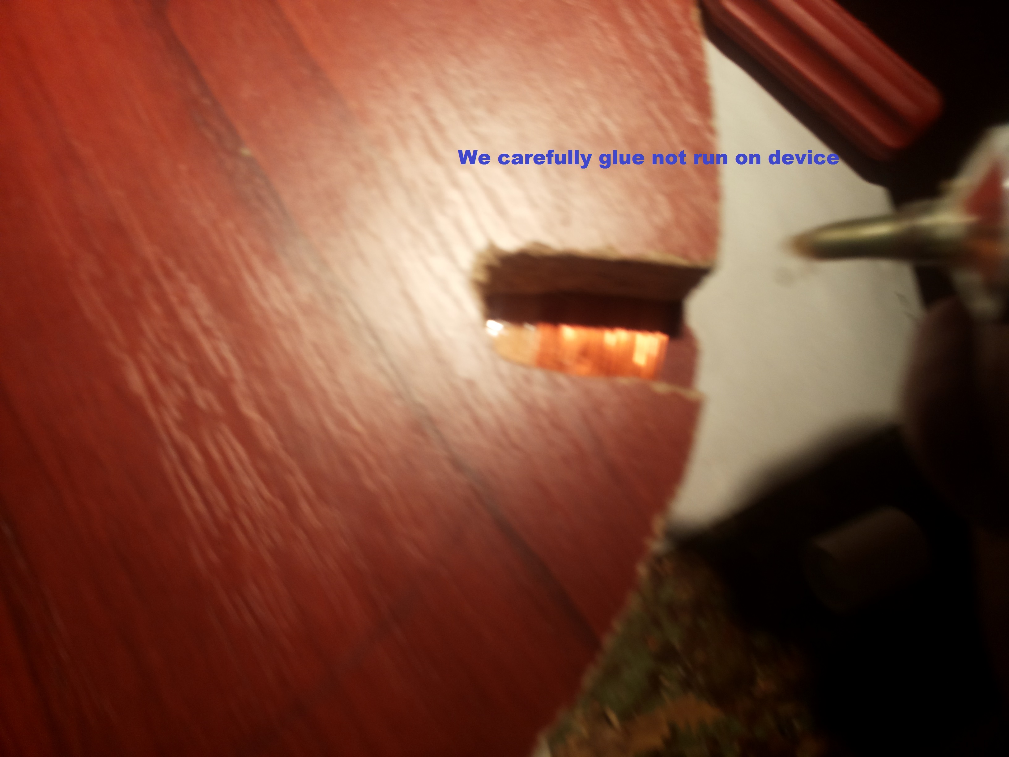

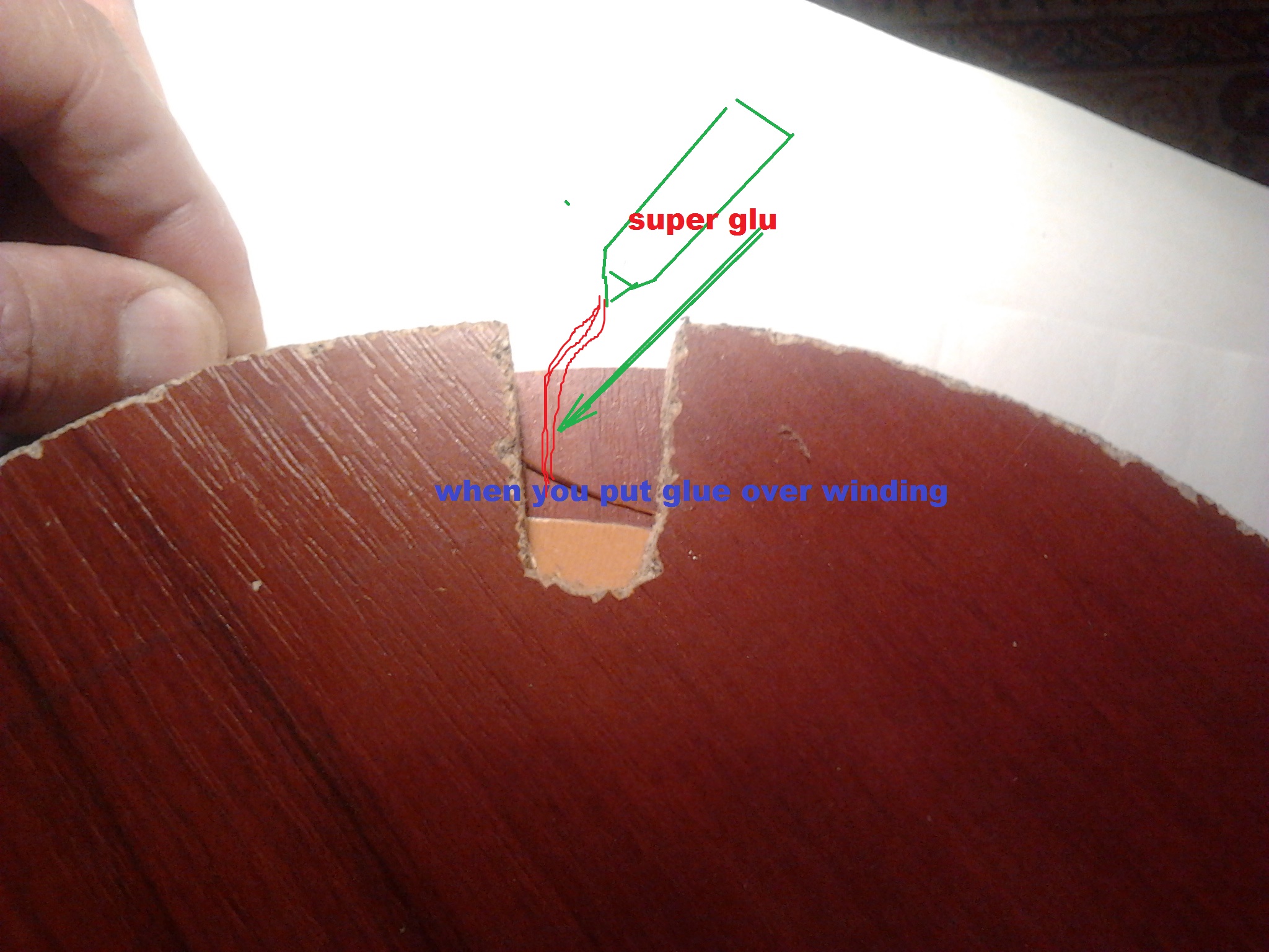

              Thanks for the explanation, I made something similar, but no channels. I wound the coil then I realized, how do I get it out in one piece?
                How do you stop the super glue sticking to the wood ?

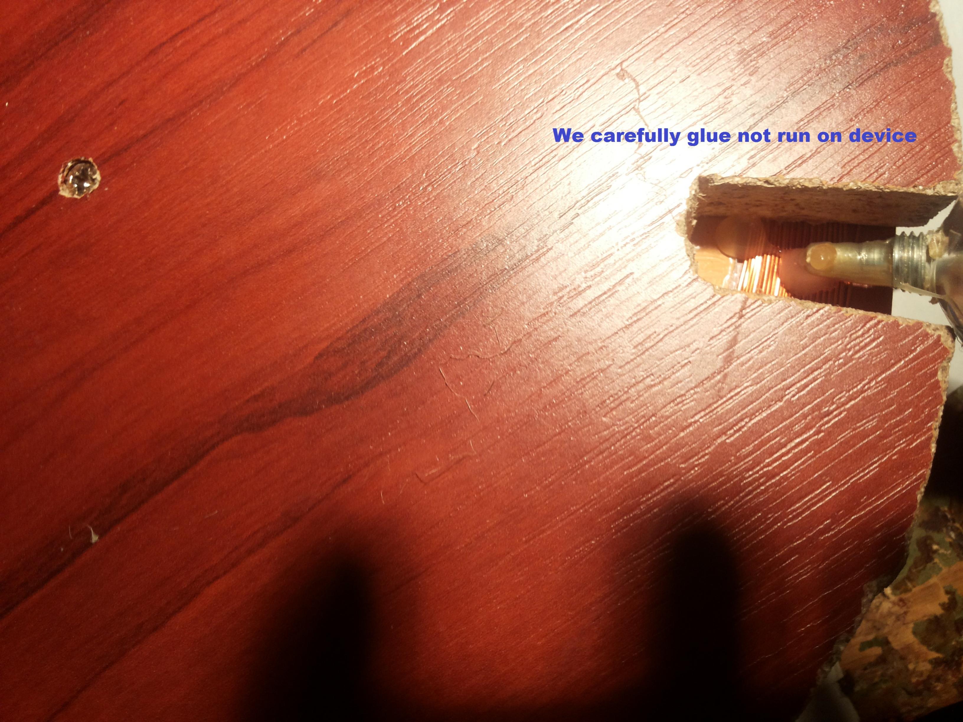

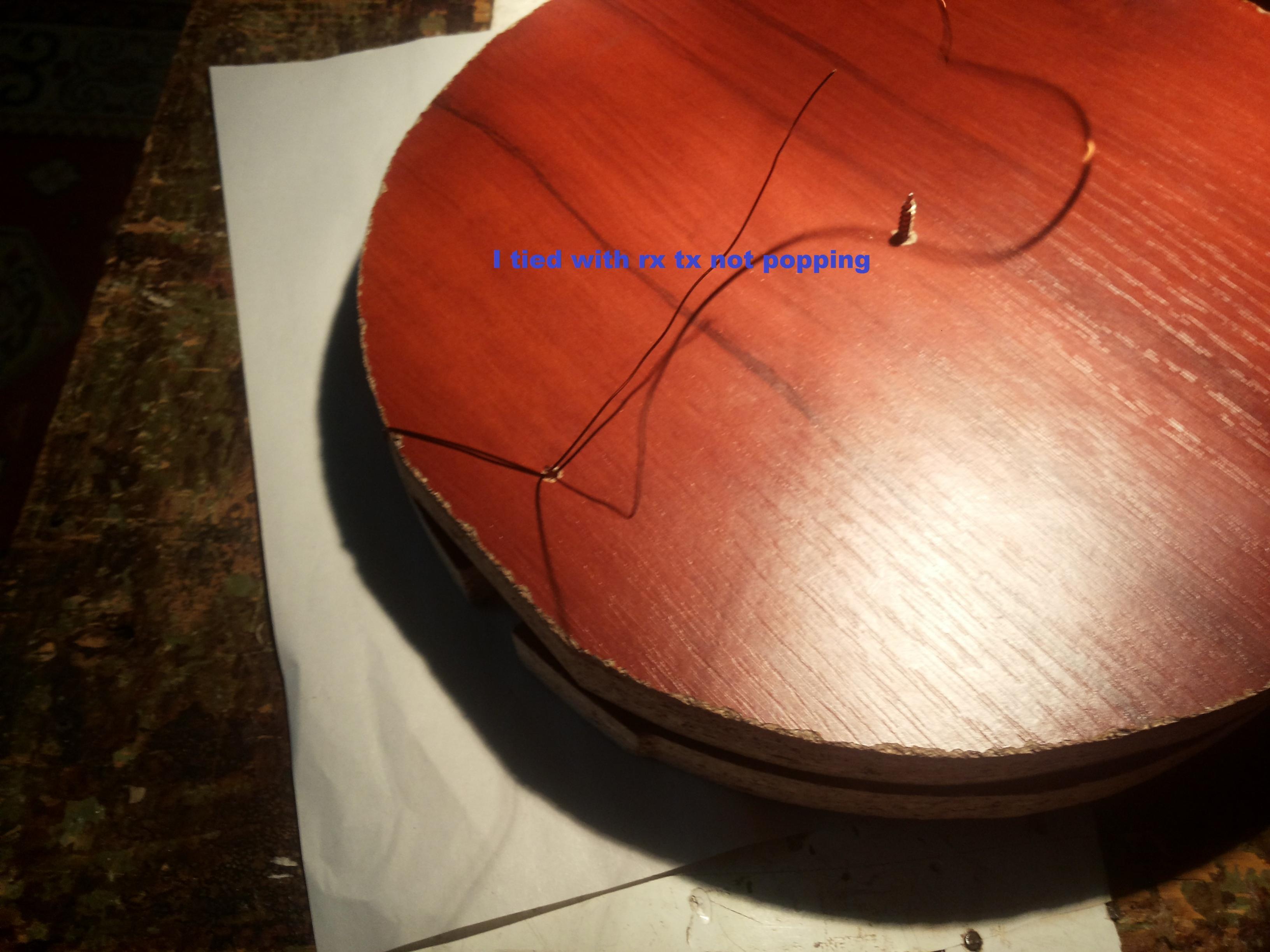

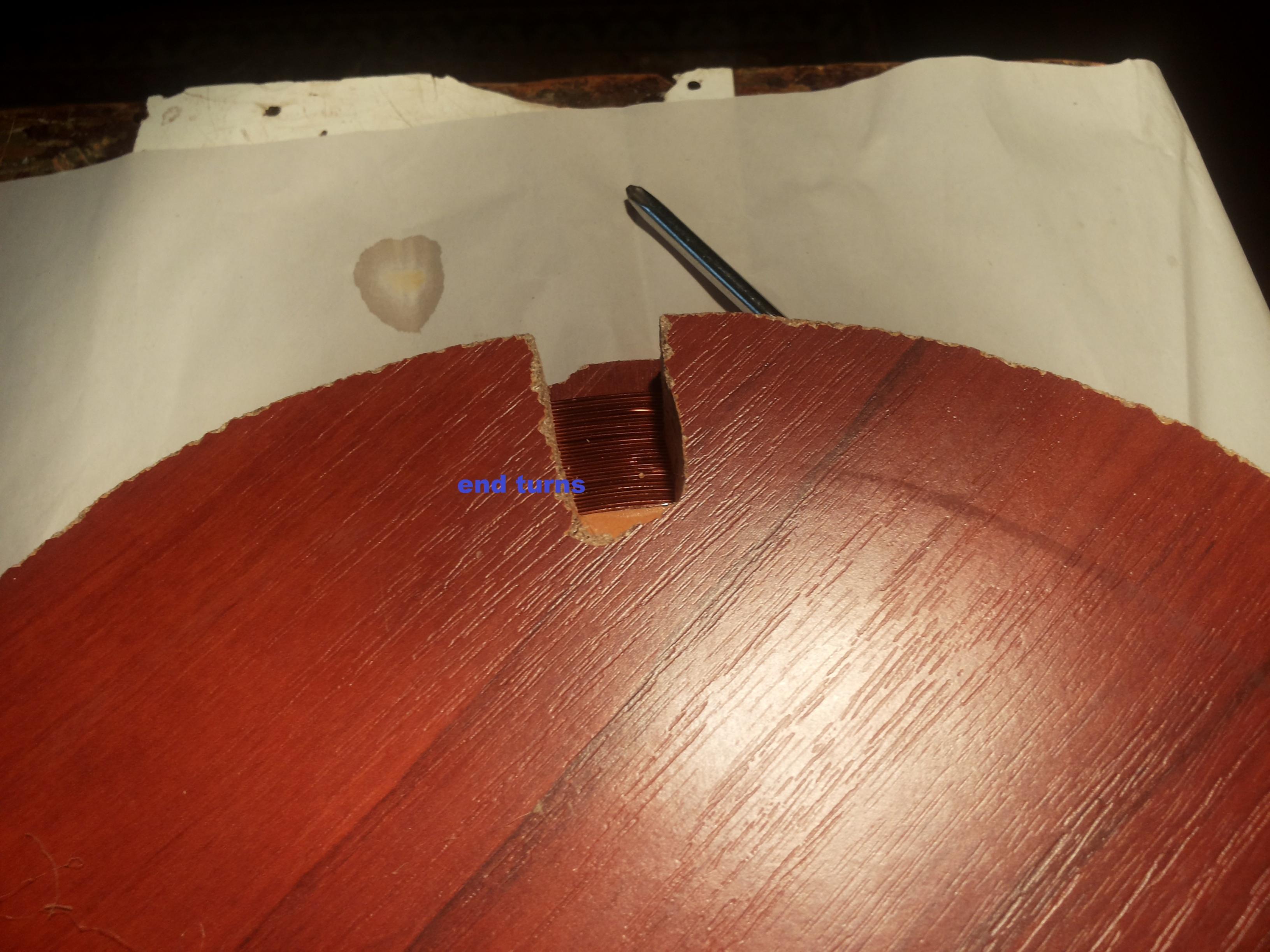

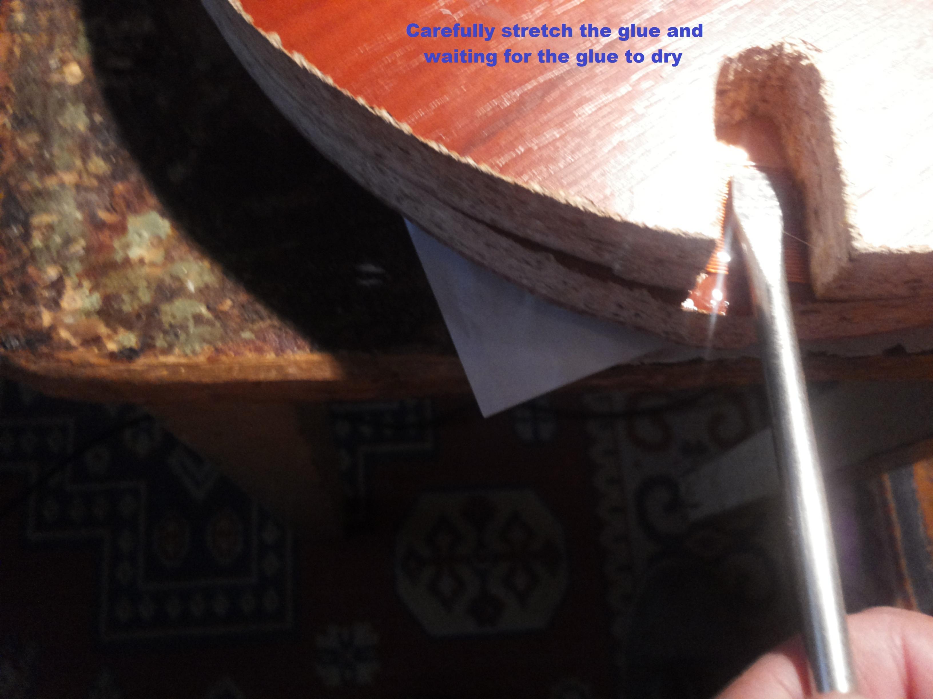

                  I'm back with photo when i do a coil to understand better, All the best

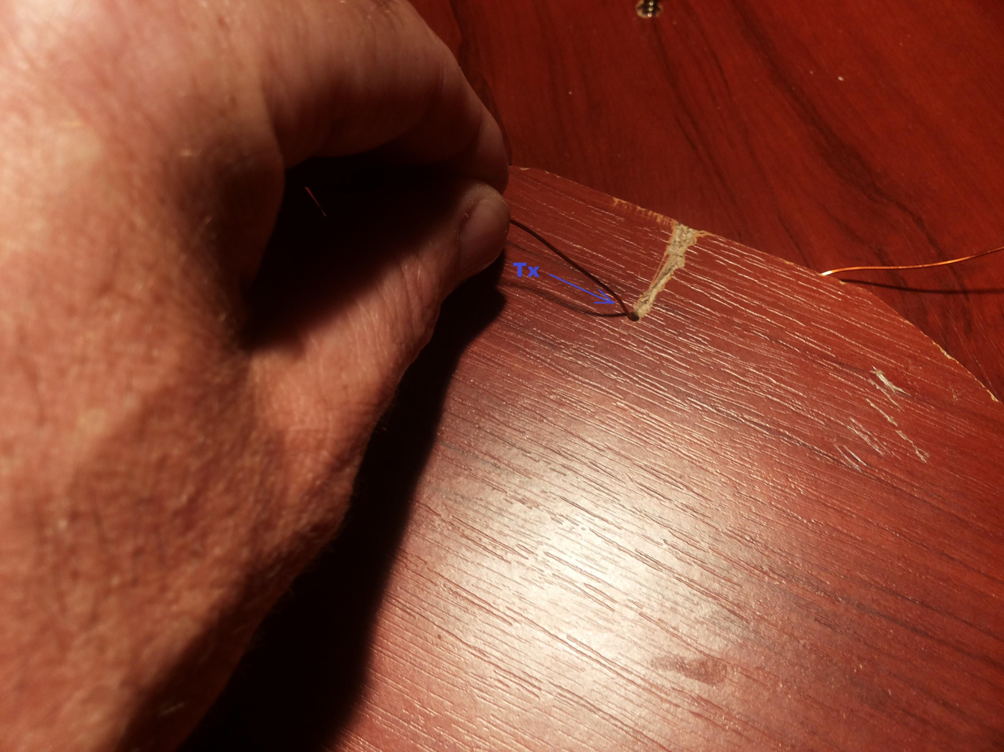

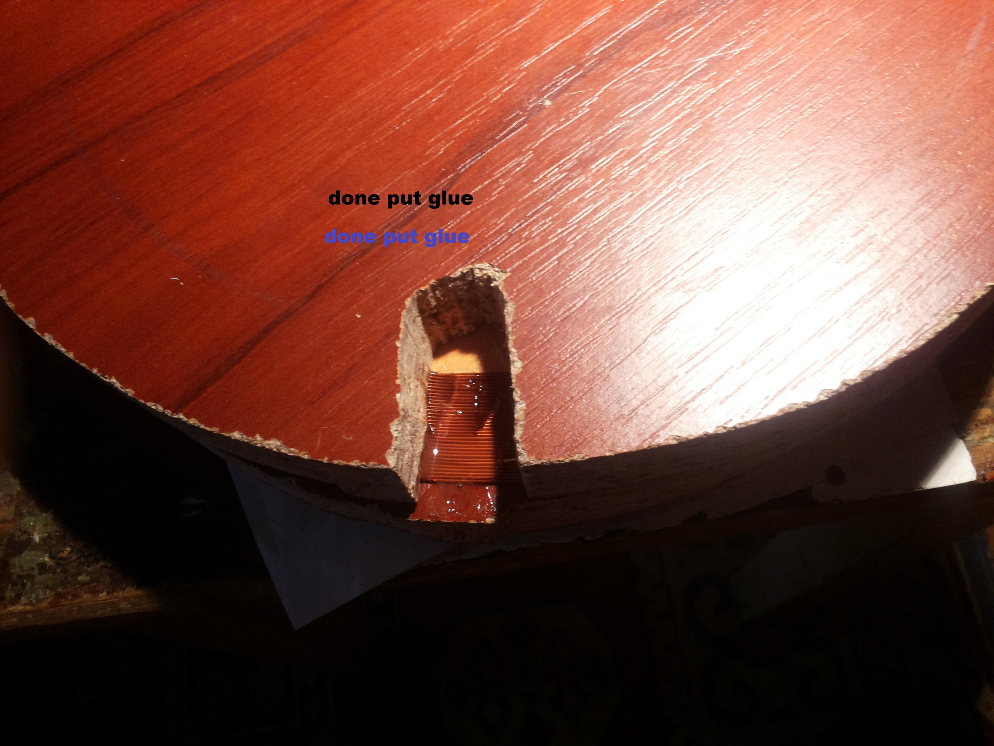

                    I m backClick image for larger version
ID:	340912Click image for larger version
ID:	340913Click image for larger version
ID:	340914Click image for larger version
ID:	340915Click image for larger version
ID:	340916Click image for larger version
ID:	340917Click image for larger version
ID:	340918Click image for larger version
ID:	340919Click image for larger version
ID:	340920Click image for larger version

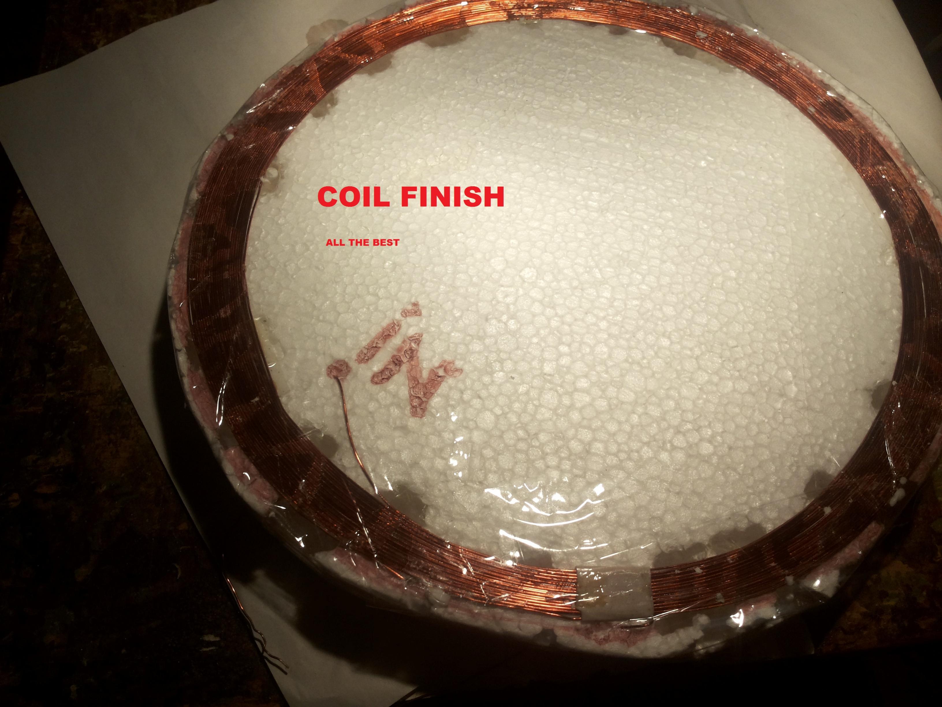

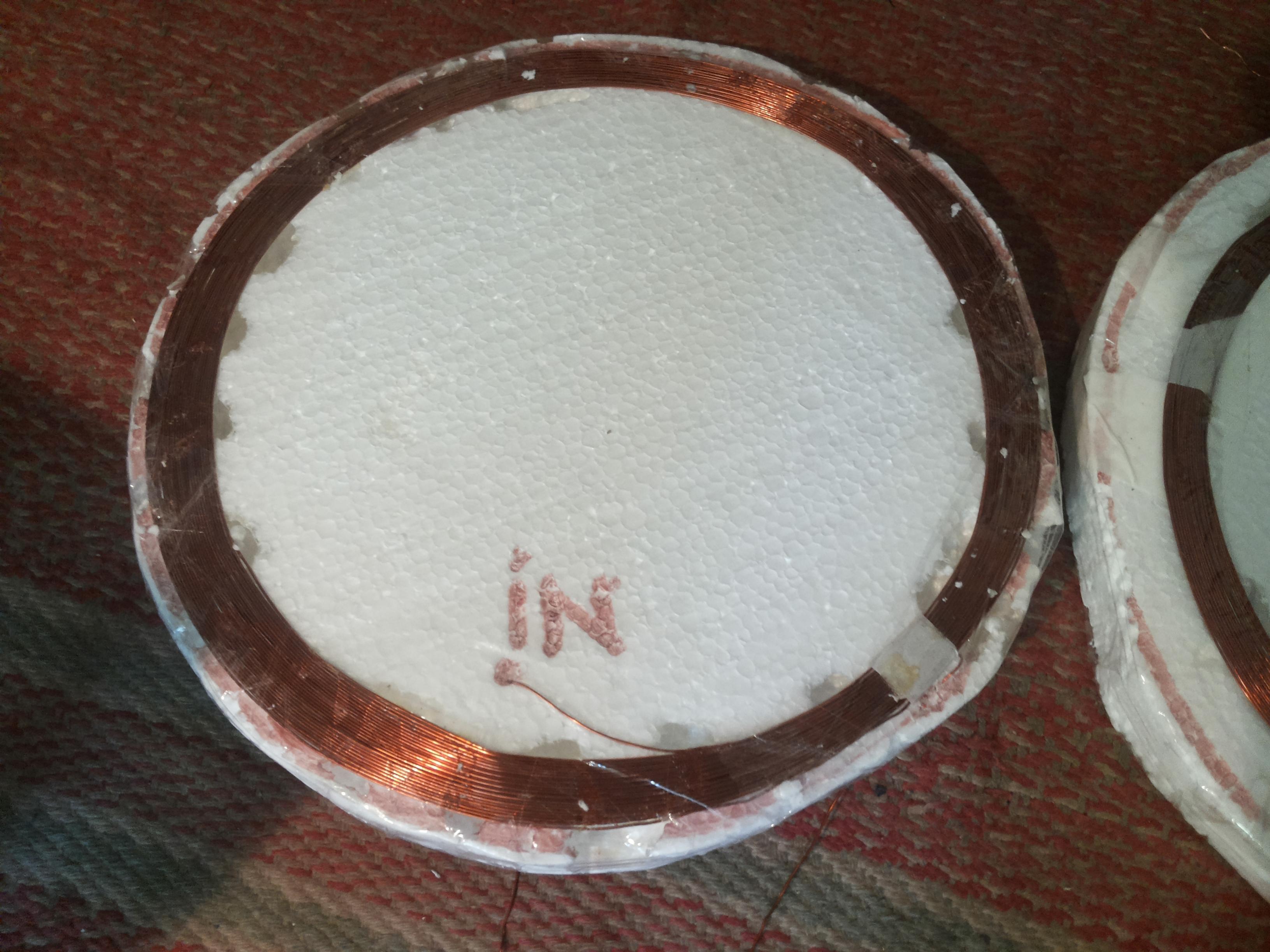

                      I m back 2 .Click image for larger version
ID:	340922Click image for larger version
ID:	340923Click image for larger version
ID:	340924Click image for larger version
ID:	340925[ATTACHClick image for larger version
                        Hi nokia6230i!..may i know the exact size of this coil and. Do we need to replace the damping resistor if our HH1?
                          me coil 0,65 Cu diameter and Coil diameter 300mm,al the best
                            thank you!
