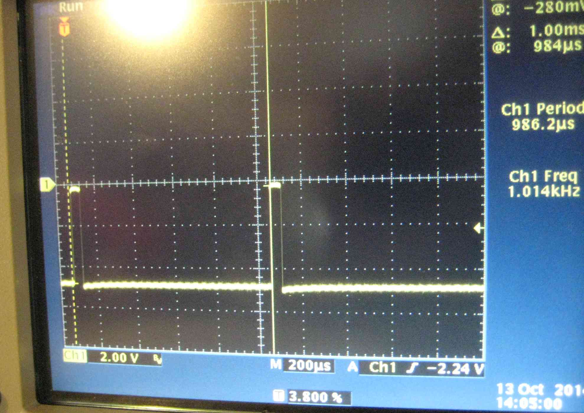

                  Pin 3 Of 555 - TX

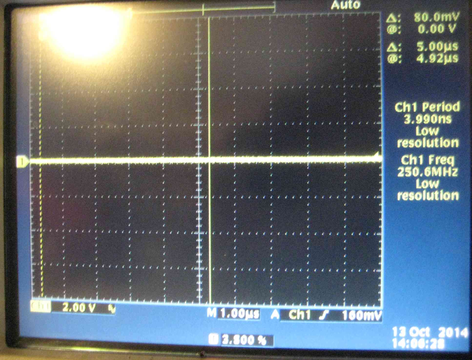

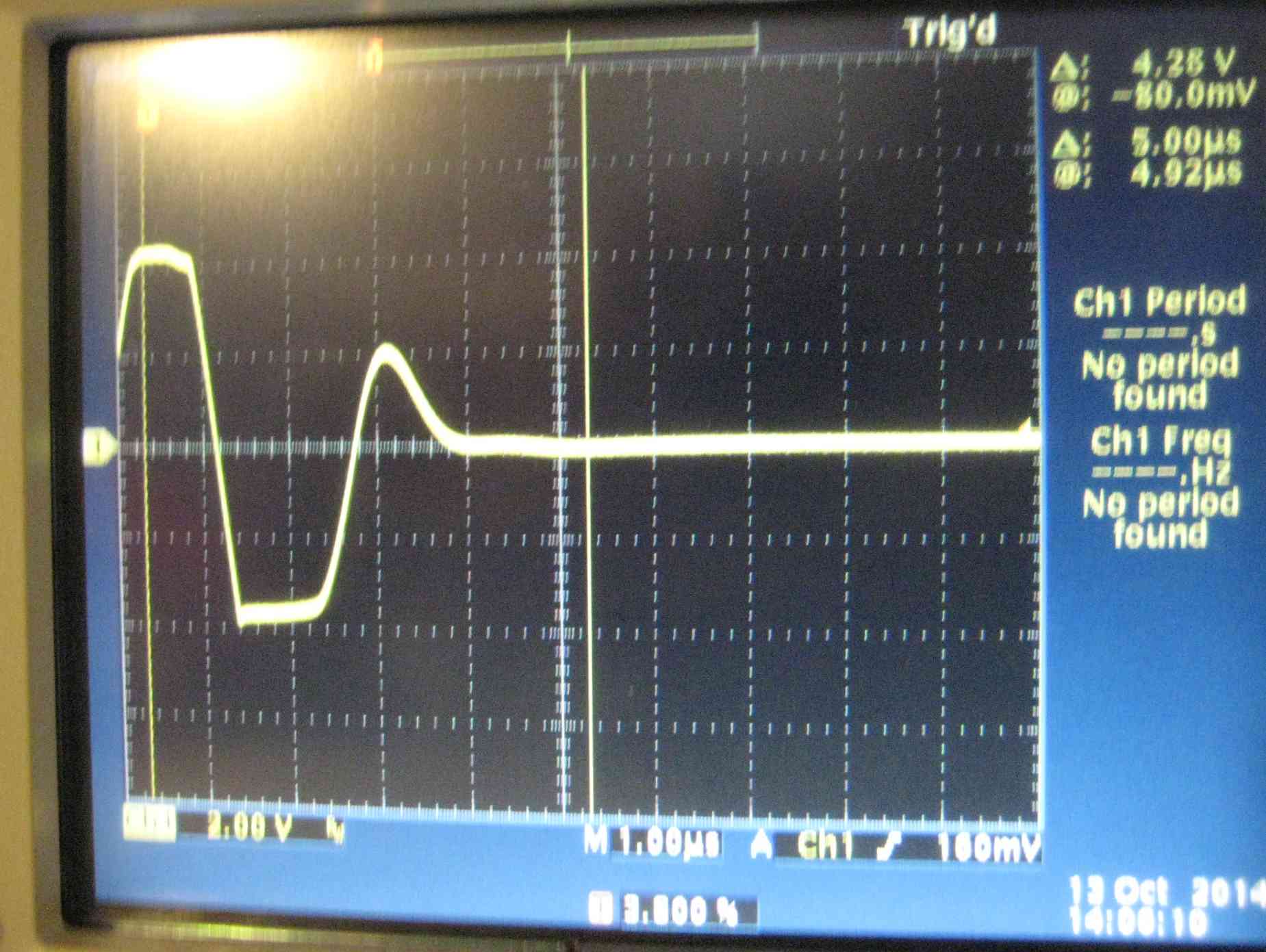

                  TP4

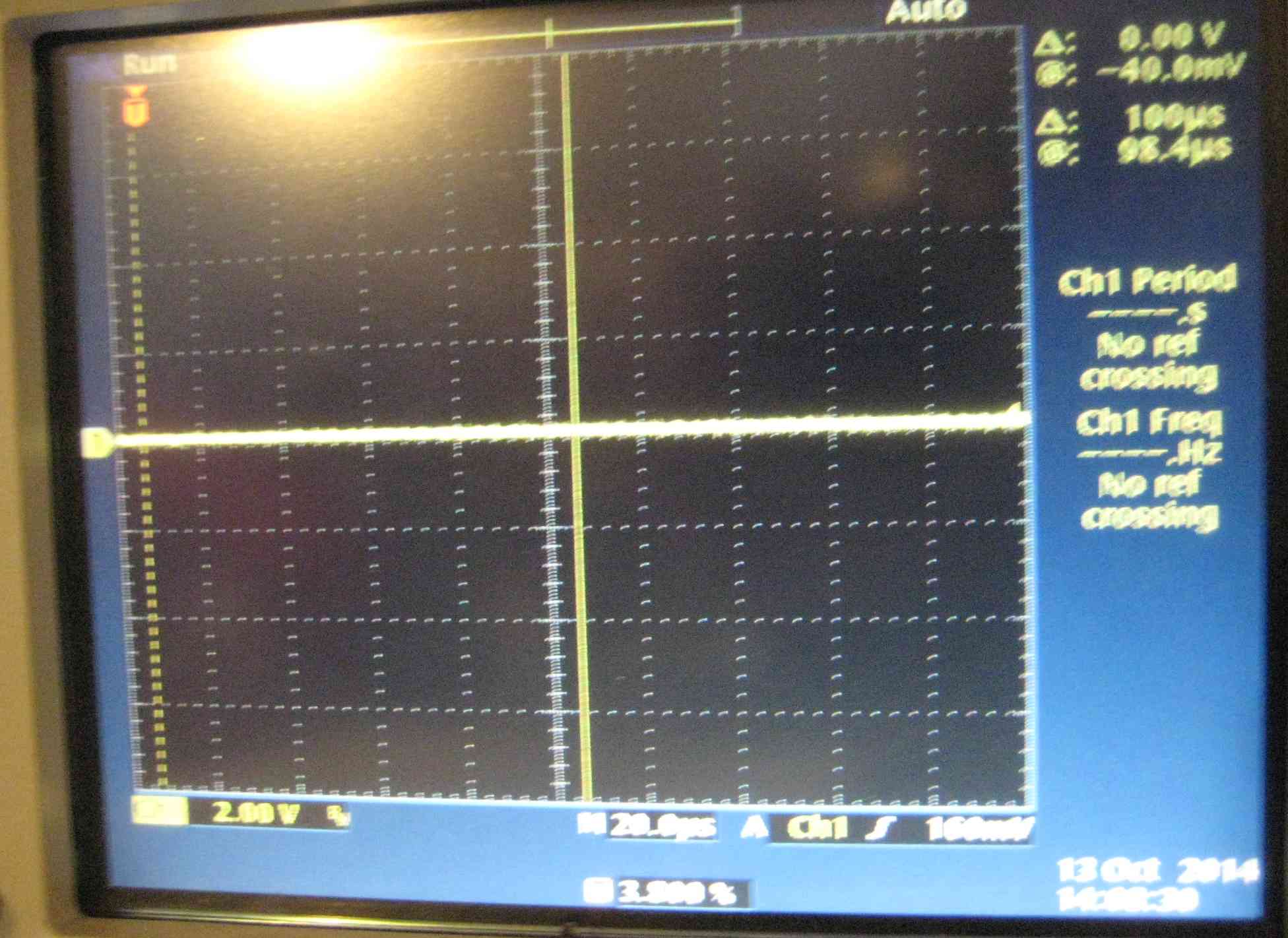

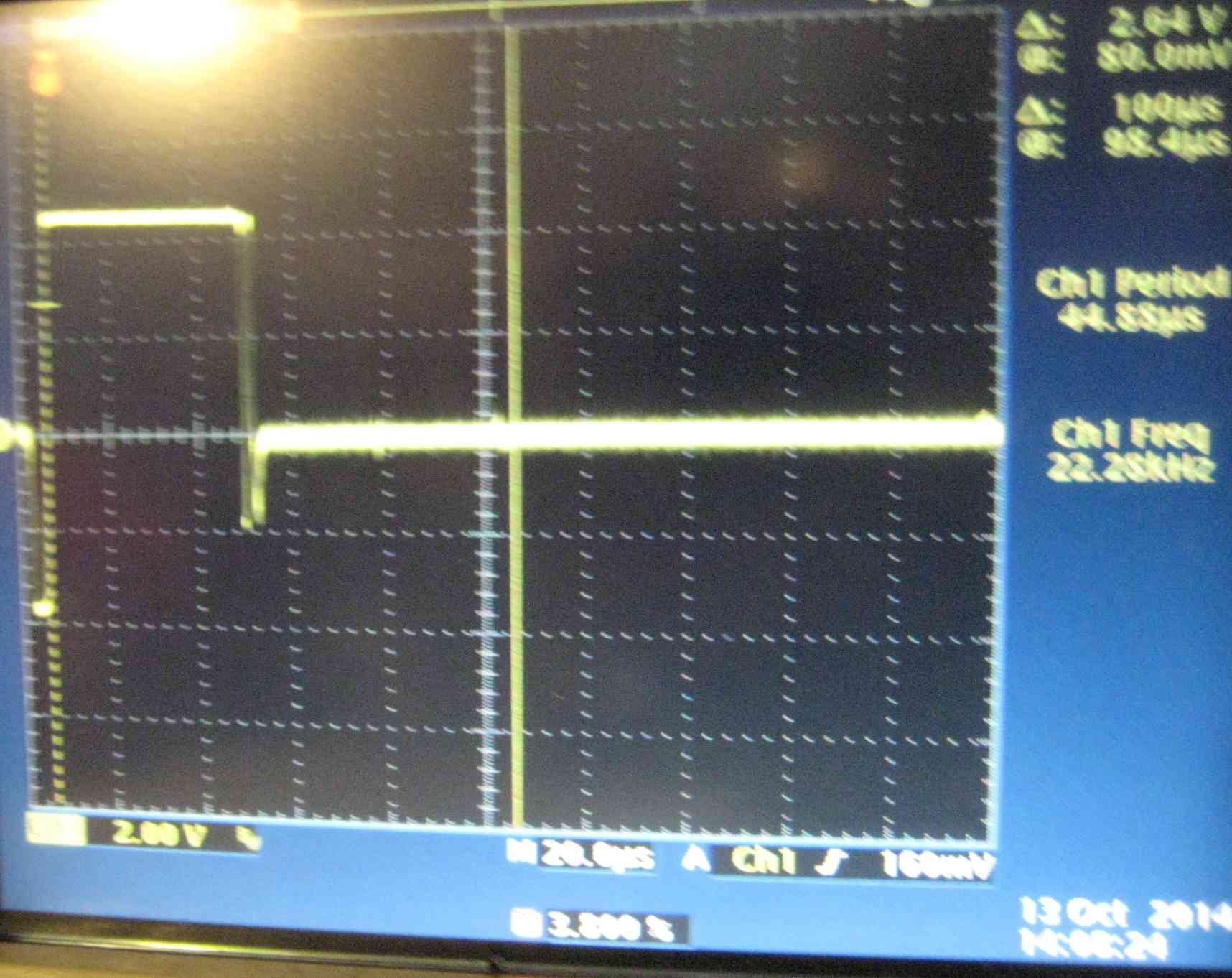

                  4066 pin 13
                    I think you need to display both pin 1 of the 4066 and pin 13 of the 4066 together on the scope to see where the sample is taking place.
                    Also what are we looking at on TP4? Is this the no-target signal? It appears to be severely underdamped.
                      I am using a 300 uh coil with a 470 ohm resistor. I haven't tried to set the damping yet.
                      Underdamped means I need a smaller resistor?

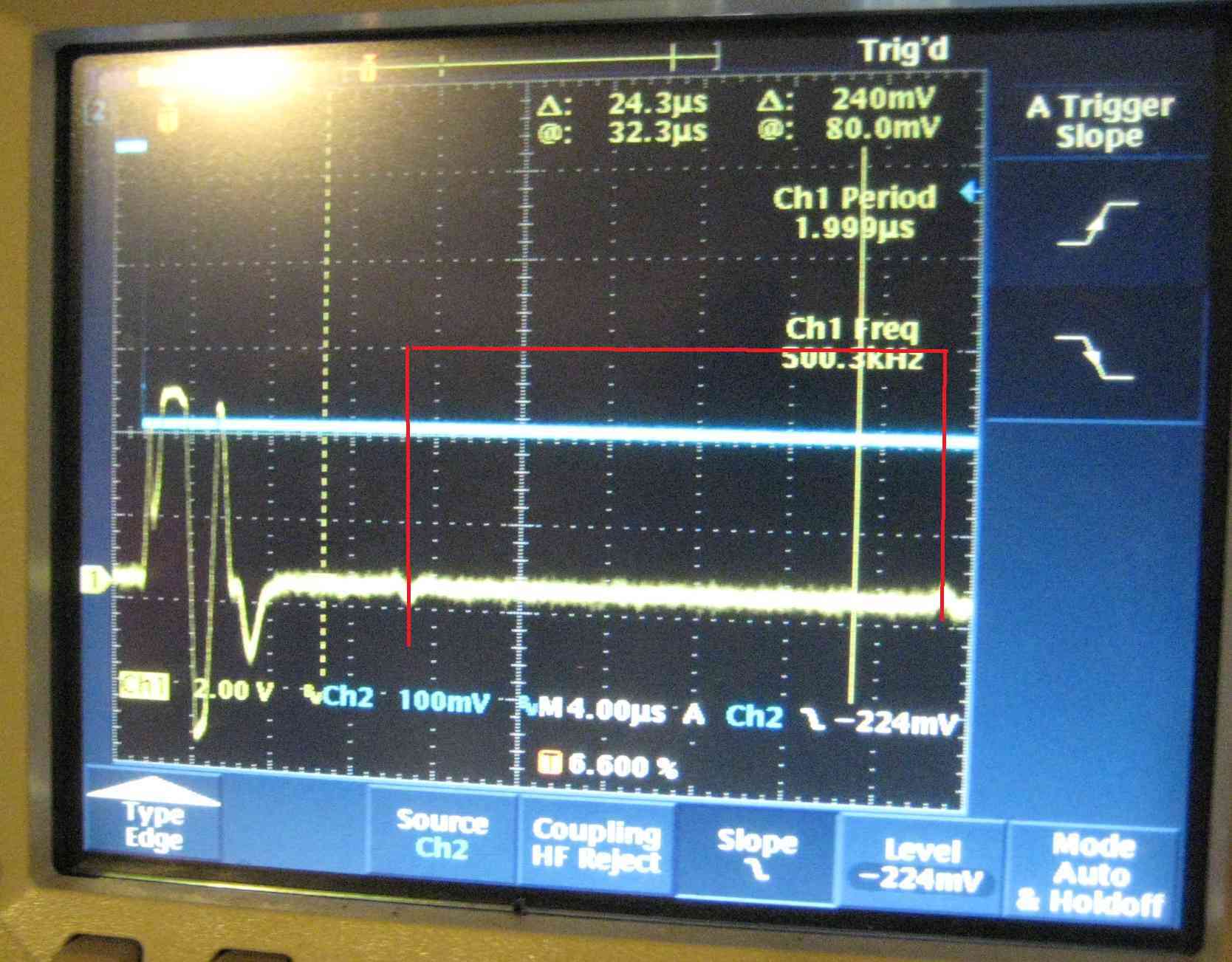

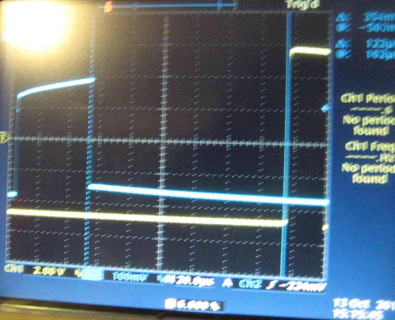

                      It looks like the signal is gone before I sample. I did as you say and checked the 2 sample
                      pulses to the TX pulse and they were way off! I was trying to use the active turn off so made
                      pin 2 of U11 high and sent n1 to pin 1.

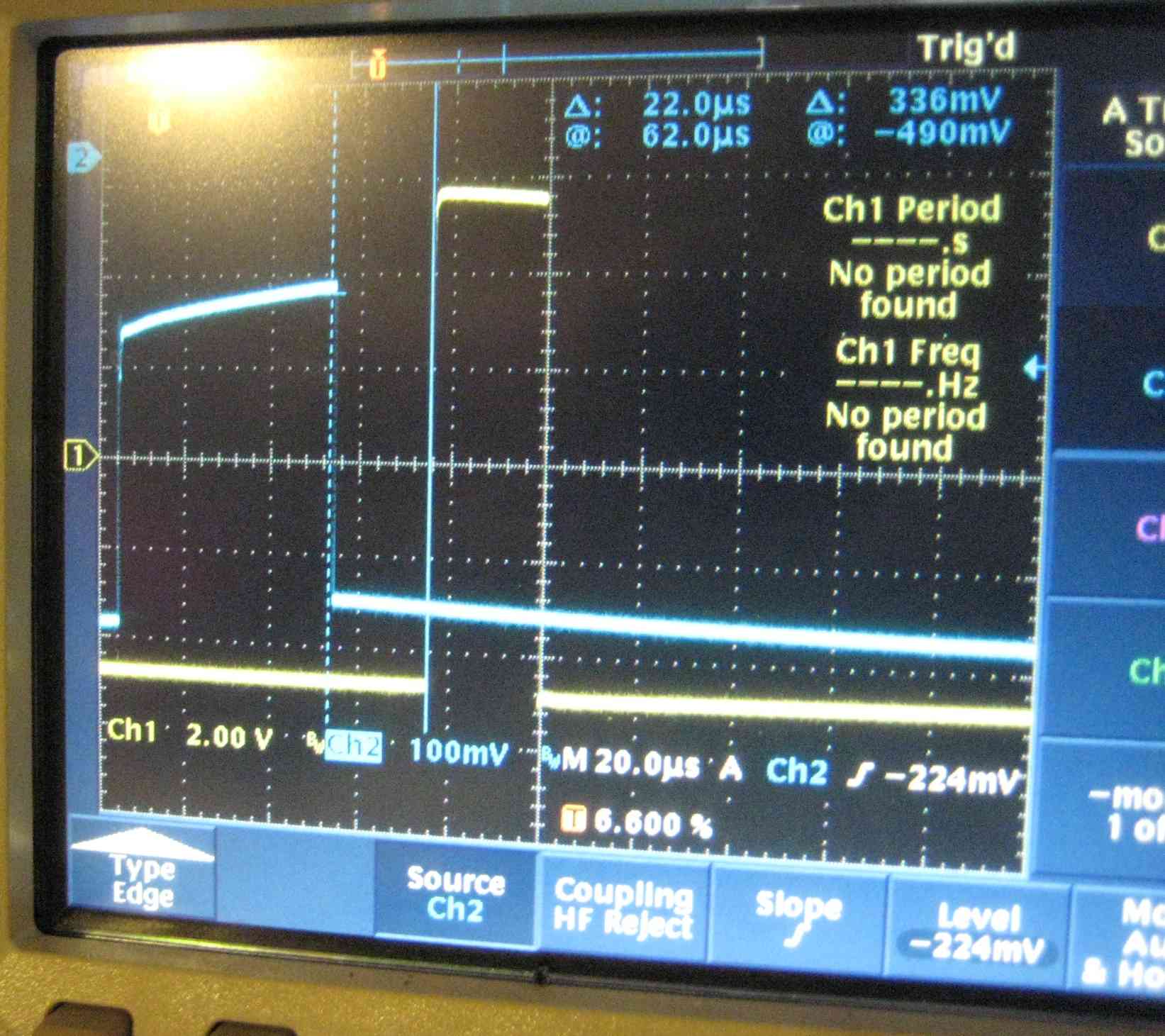

                      Here's some more pictures;
                      This is TX to first sample now after I adjusted it to ~20 us out

                      This is TX to TP4;

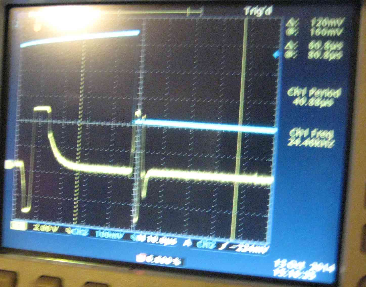

                      I seem to get a good waveform on the rising edge of the TX but bad on the falling edge.
                      I did add 15 ohms in series with the coil to limit current...
                      This shows the problem, the sample cannot get close enough to see the short recieve signal
                      (sample pulse in red)

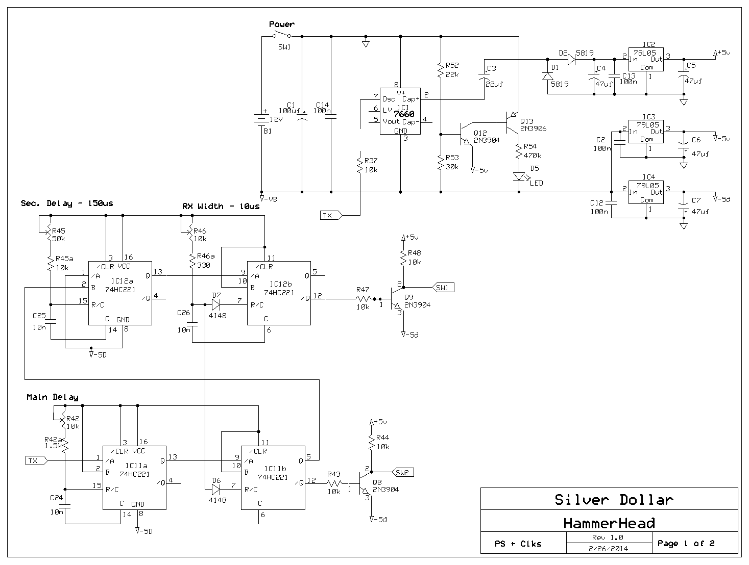

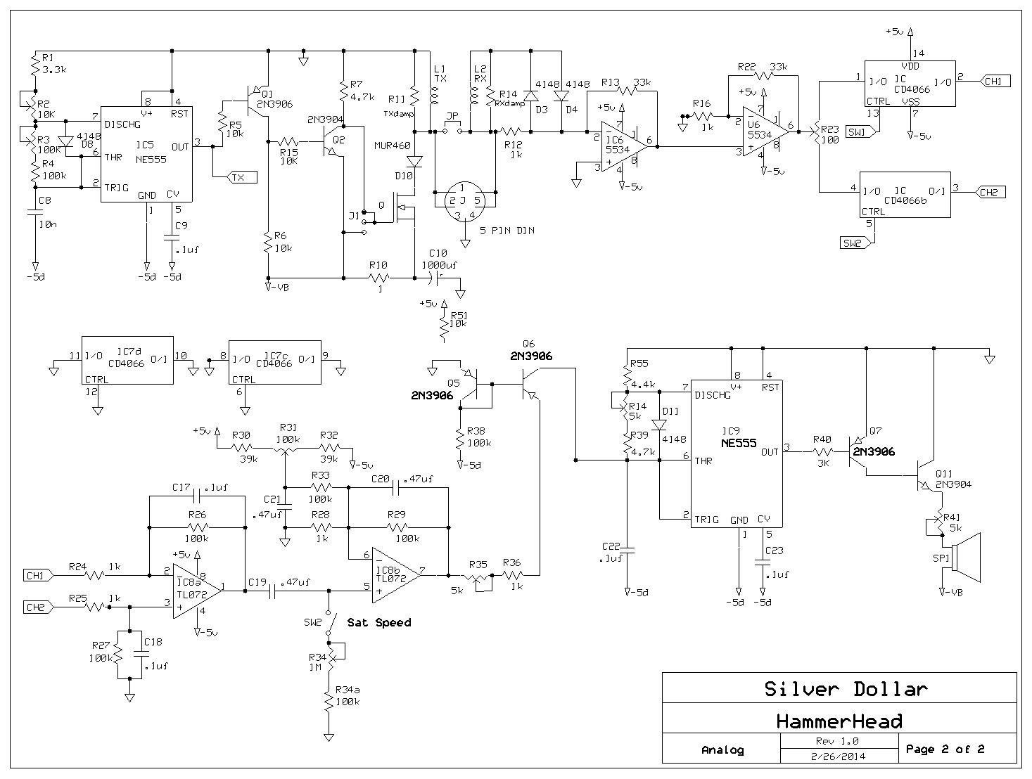

                        Here's the schematic I am working to;

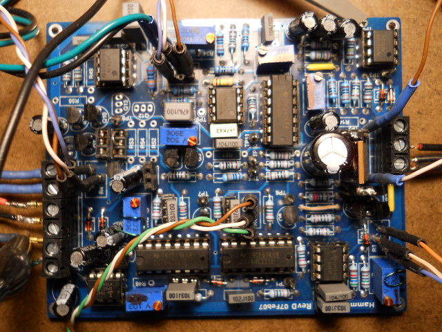

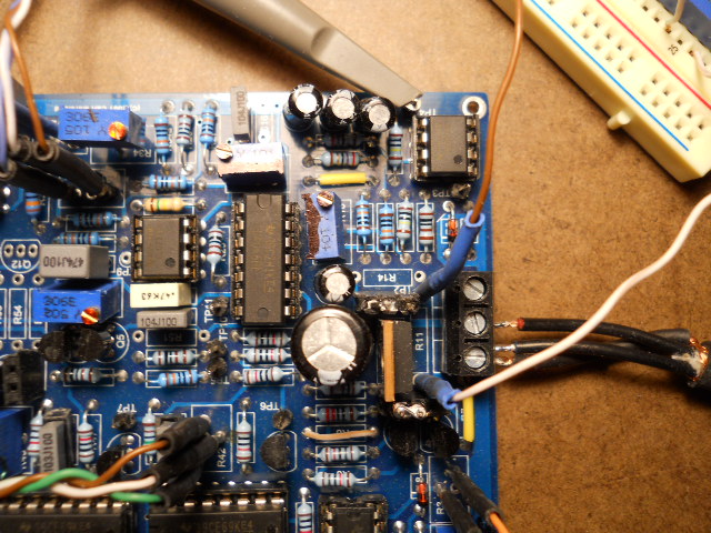

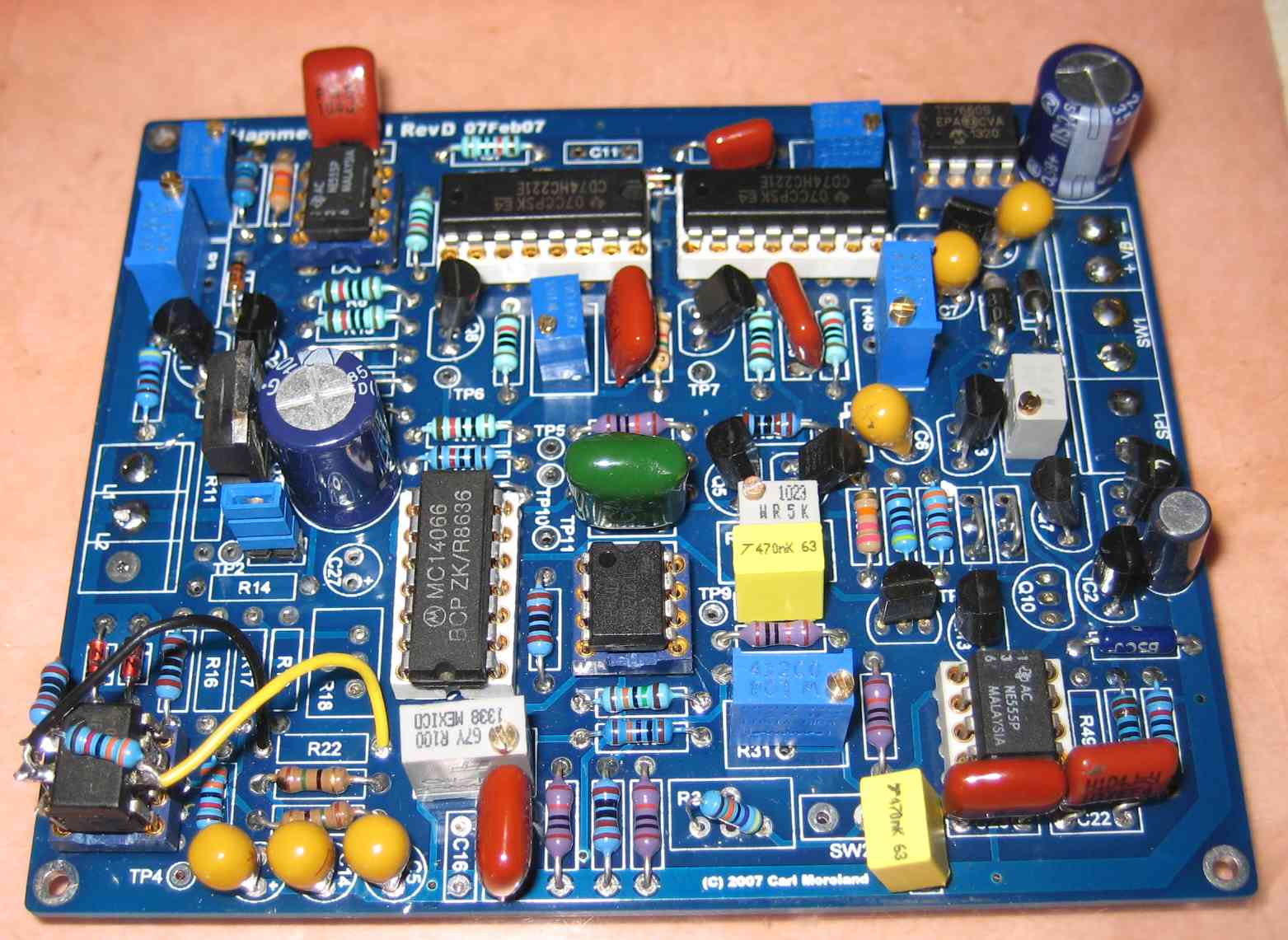

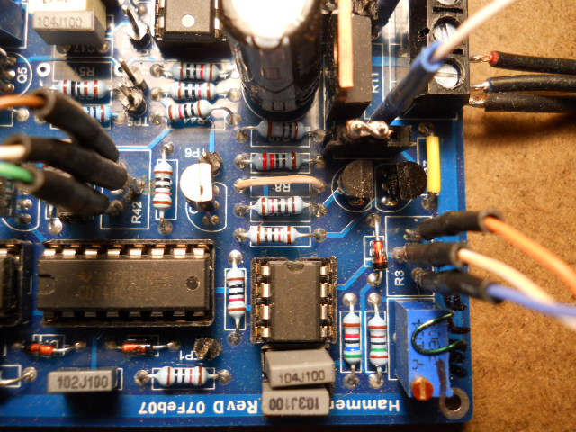

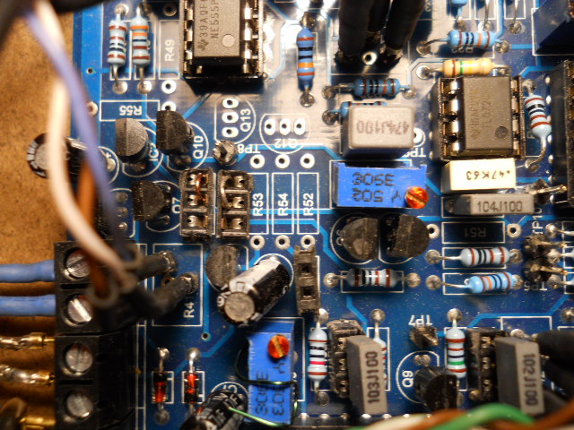

                          I recently got my HH up and running as well. I built to the VCO option 1 schematic and I notice we have some different resistors and jumpers. Im a total newbe so I cant offer much more insite other than to provide some pics of my working board.
                          Sorry I cannot get my pics to post I will try again tomorrow.
                            Hopefully this works.
                            Here are the photos of my board, I hope it helps. You can see we have different resistors installed and jumpers. Maybe your double front end has caused you to change these I dont know but hope you get it going!
ID:	341895Click image for larger version
ID:	341896Click image for larger version
ID:	341897Click image for larger version
                              Thanks for the pictures. Mine is a little different so maybe they won't help much.

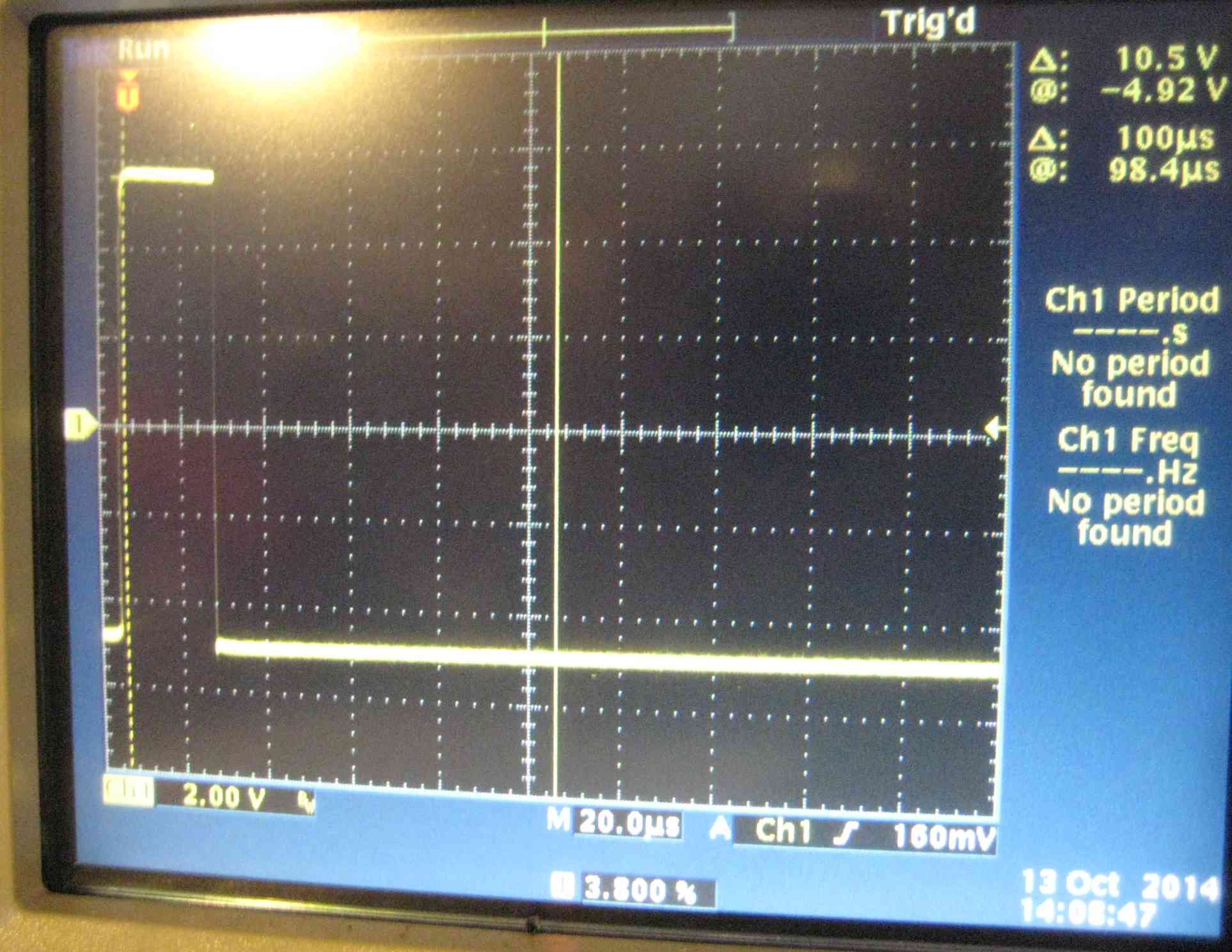

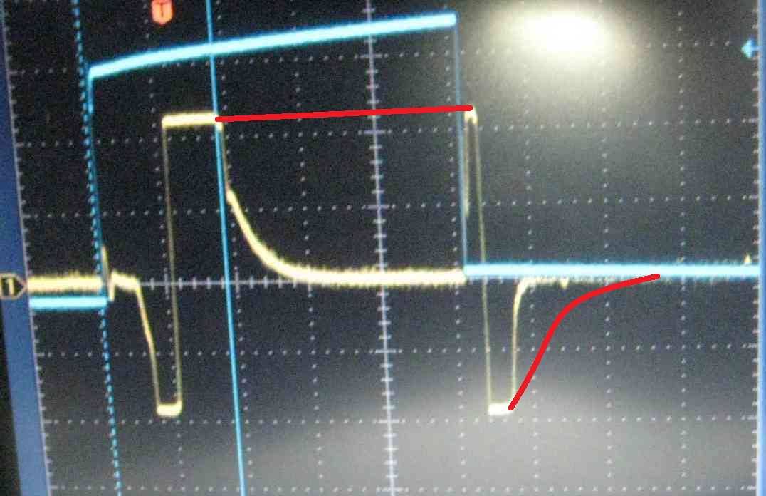

                              This picture show what I think is the problem. The wave should look like the red
                              lines;
                              I'm not sure what could be wrong with the FET to cause this but it looks like a
                              cap in series with the gate... The FET came out of a junk PCB. It is a nice one
                              600v .9 ohms and low capacitance. I'll try a different one today.
