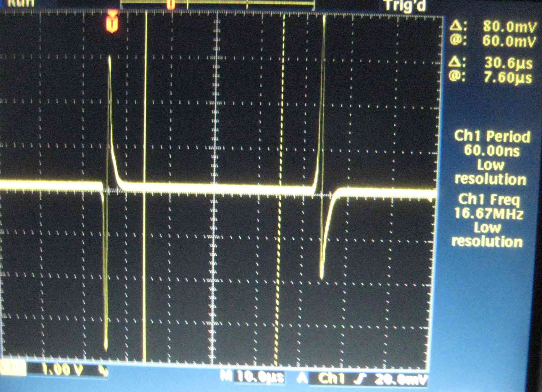

Have you compared your board with the scope images at the end of the HH article (page 15)?
HammerHead Problem

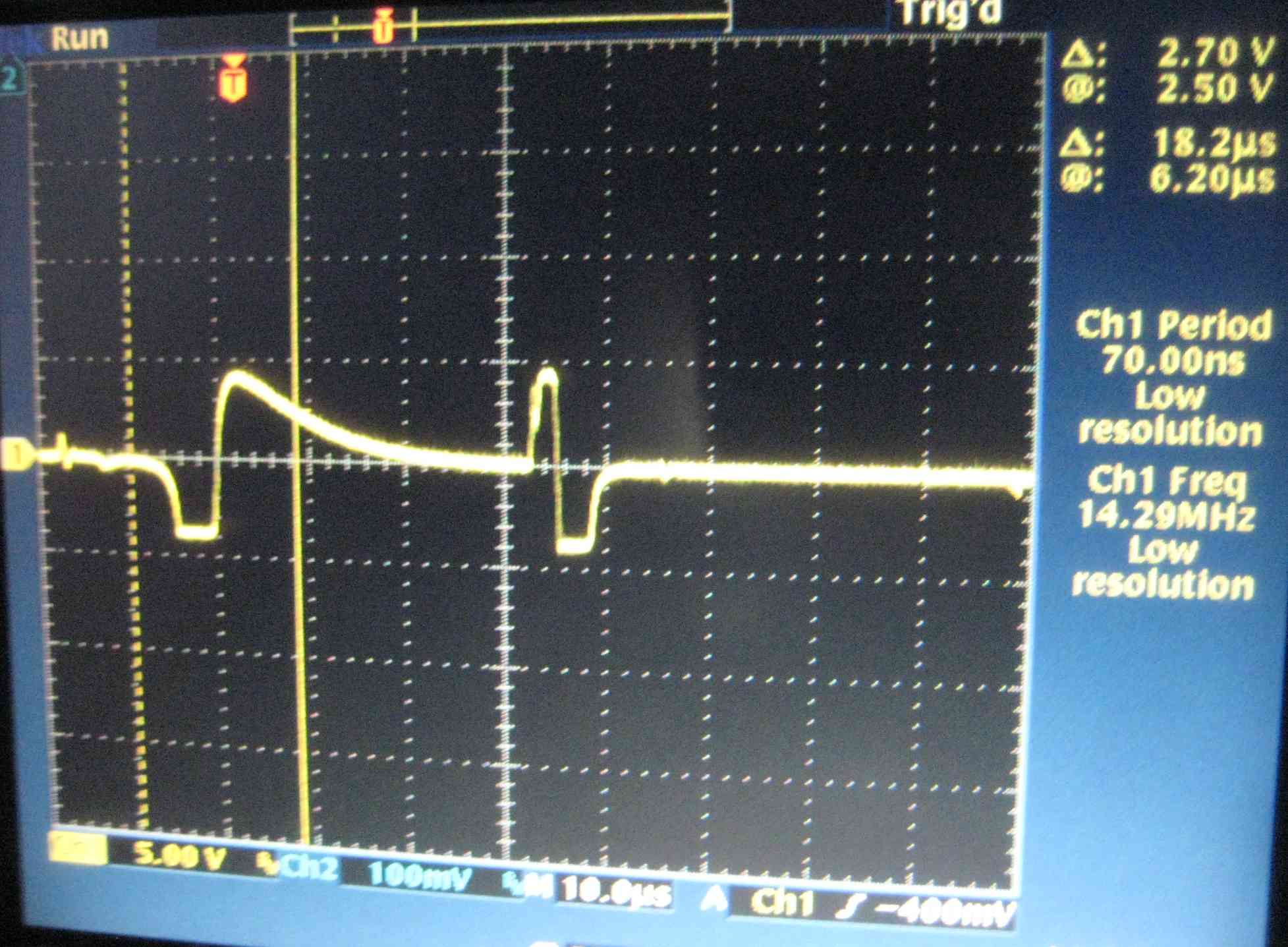

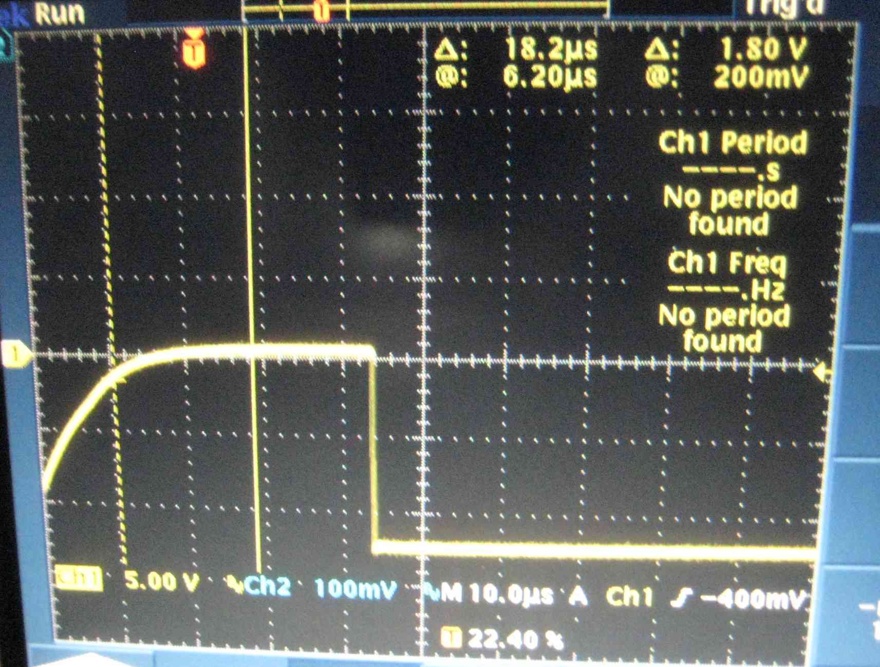

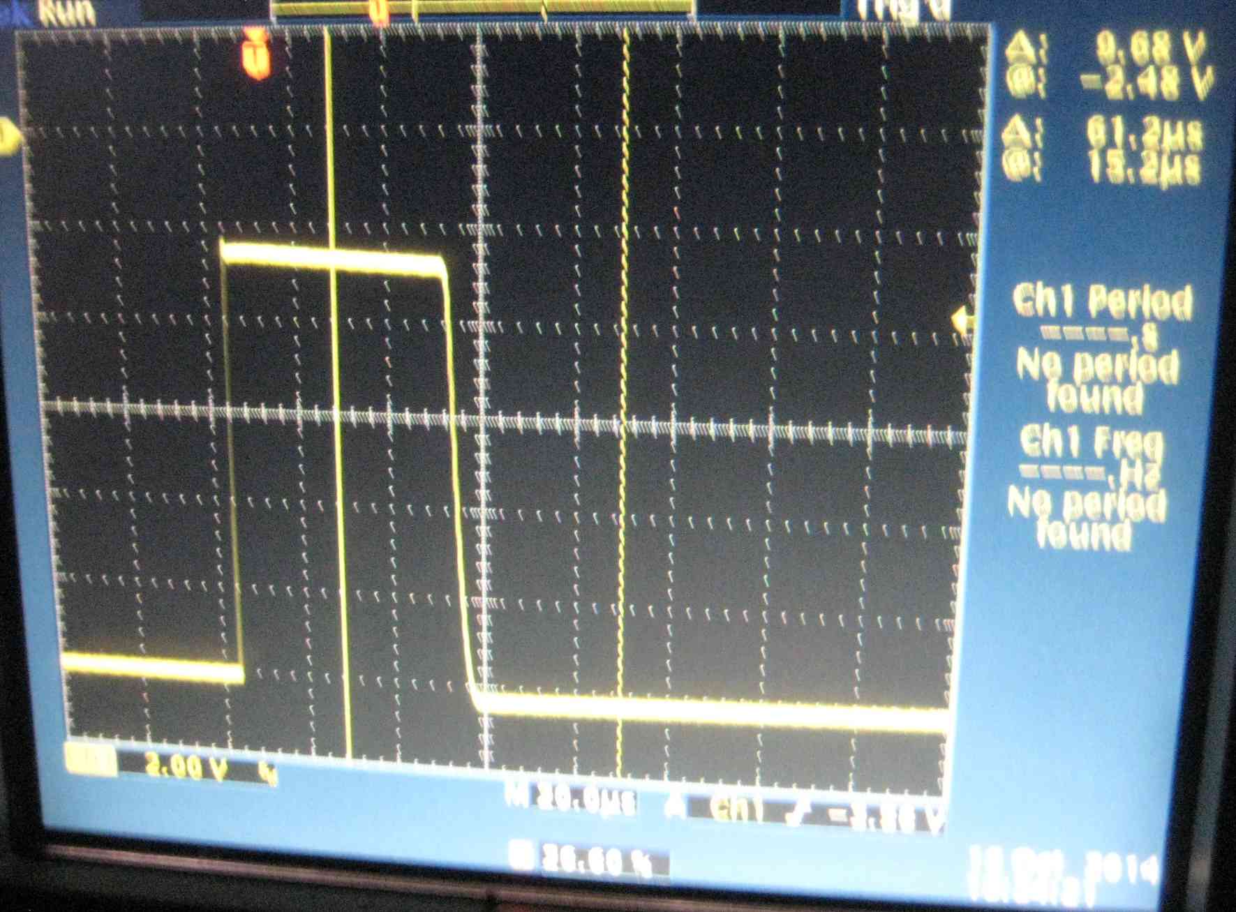

I changed the FET today. Here is the pulse on the gate of the FET;

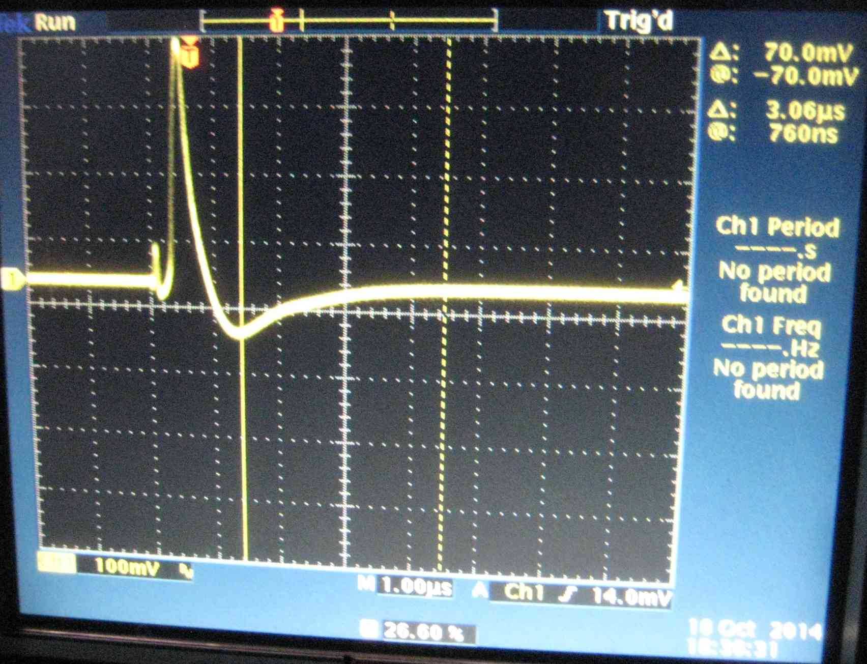

But the Preamp output is still not correct. I don't know why...

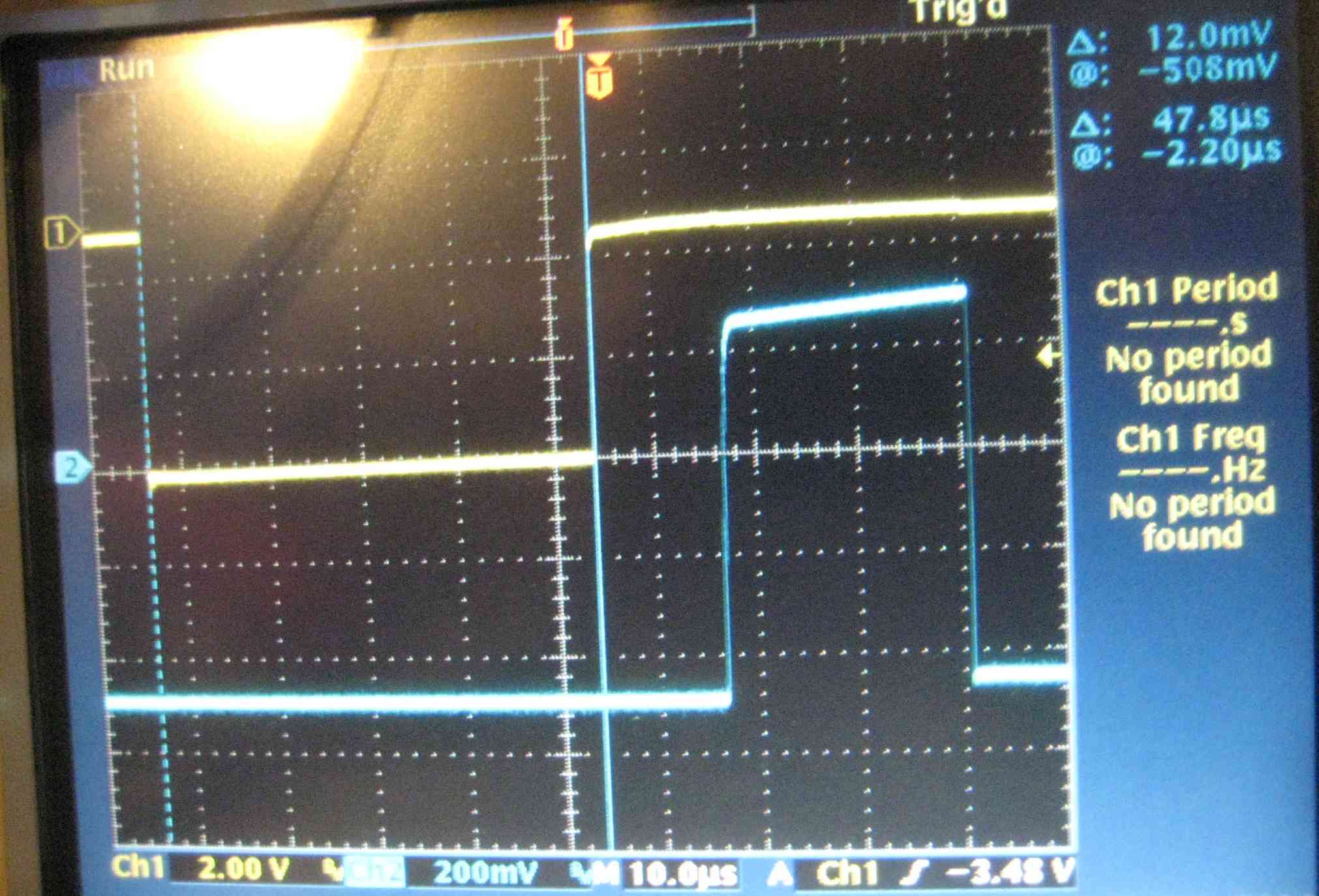

The signal looks good but it's on the wrong edge of the TX pulse.
So that seems to say the TX is upside down somehow.....

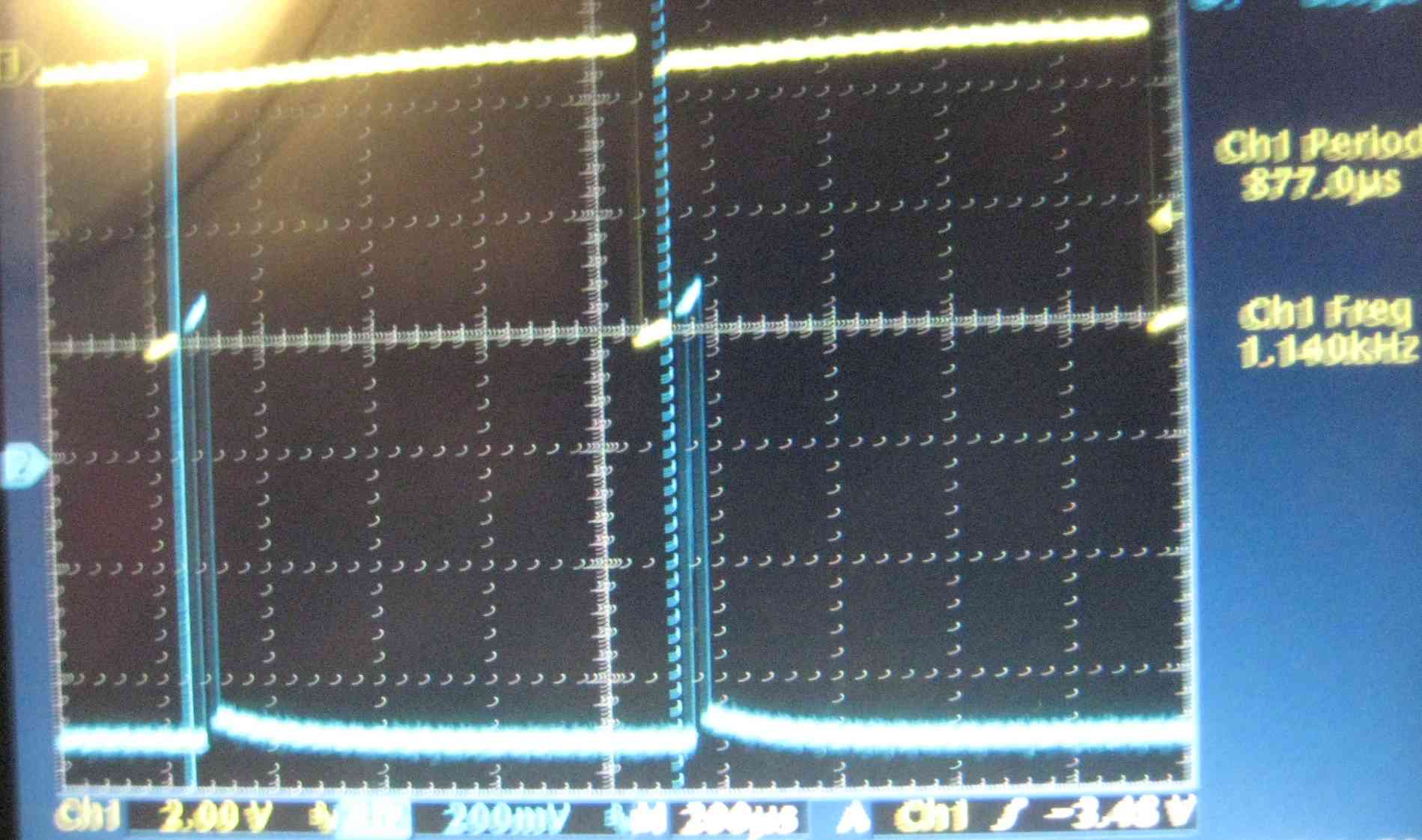

The pictures in the HH article do not really show much. I'd like to see
each TP and maybe the TX pulse vs sample 1 and sample 2.

Hi Silver Dollar, since you have a drive pulse on the Gate and have already replaced the MOSFET. There may be problem with the positive 12v from the battery getting through the circuity to the Drain. Or the negative 12v side may not be getting to the Source of the MOSFET.
With the battery removed and the power switch on; measure continuity from the positive battery connection to the cathode of D10; it should read the resistance of the coil; check D10 front to back resistance and insure that it is installed correctly.
From the negative side of the battery measure continuity to the Source of the MOSFET; it should read the 1 ohm resistance of R10.

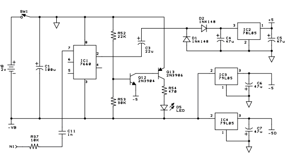

I know you set your board up differently than the standard VCO option. What are you using R52,53.54 to accomplish on you board? If I were to install them on the standard VCO set up would I gain any benefit?

Thank you I could not find that in the document and explains why D5 doesnt work on my board. Cool Ill play with that.

I found my problem, R10 was open! I know I measured it when I installed it.
I'm not sure if it popped due to excessive voltage or just failed when the leads
were bent but we are back in business. I am going to go back to the active
shut off and 2 stage gain as I think it will make a faster detector!
