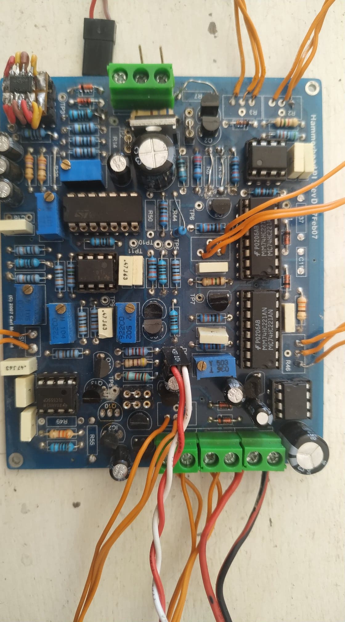

    Some years ago, I have started the Hammerhead project, but after spending a lot of time to try make it work without success, I had abandonned.
    Now, I have take out the PCB and fond some wiring problems on it.
    It's now basically working, but only with big metallic objects.
    Some problems : On my circuit I can't null TP4 with P18, and Threshold have no effect. Sensitivity have minor effect too.
    I have try to move all pots, but the best that I obtain, is 20-25Cm with a metallic stapler, and only 1 Cm with a big coin.
    My coil is 500?H and about 1.5 Ohm, not shielded.
    Here is a PIC of my PCB. (dont pay attention to NE5534 I have adapted a SOIC8 format the time I receive a DIP8 one.)

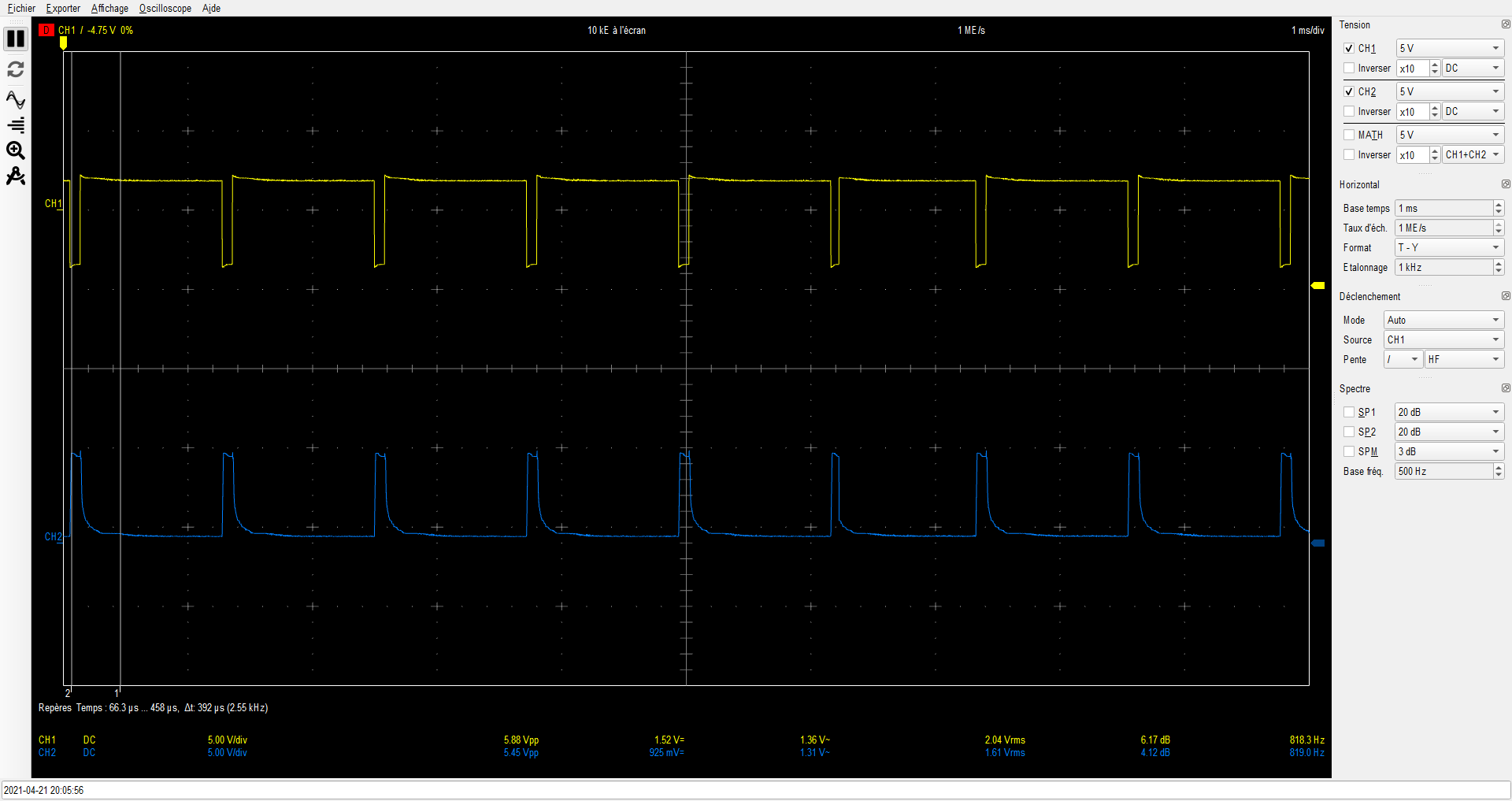

      Hi Waltr, and many thanks for your help!
      For the Coil its uH effectively (the forum don't accept the "micro" font).

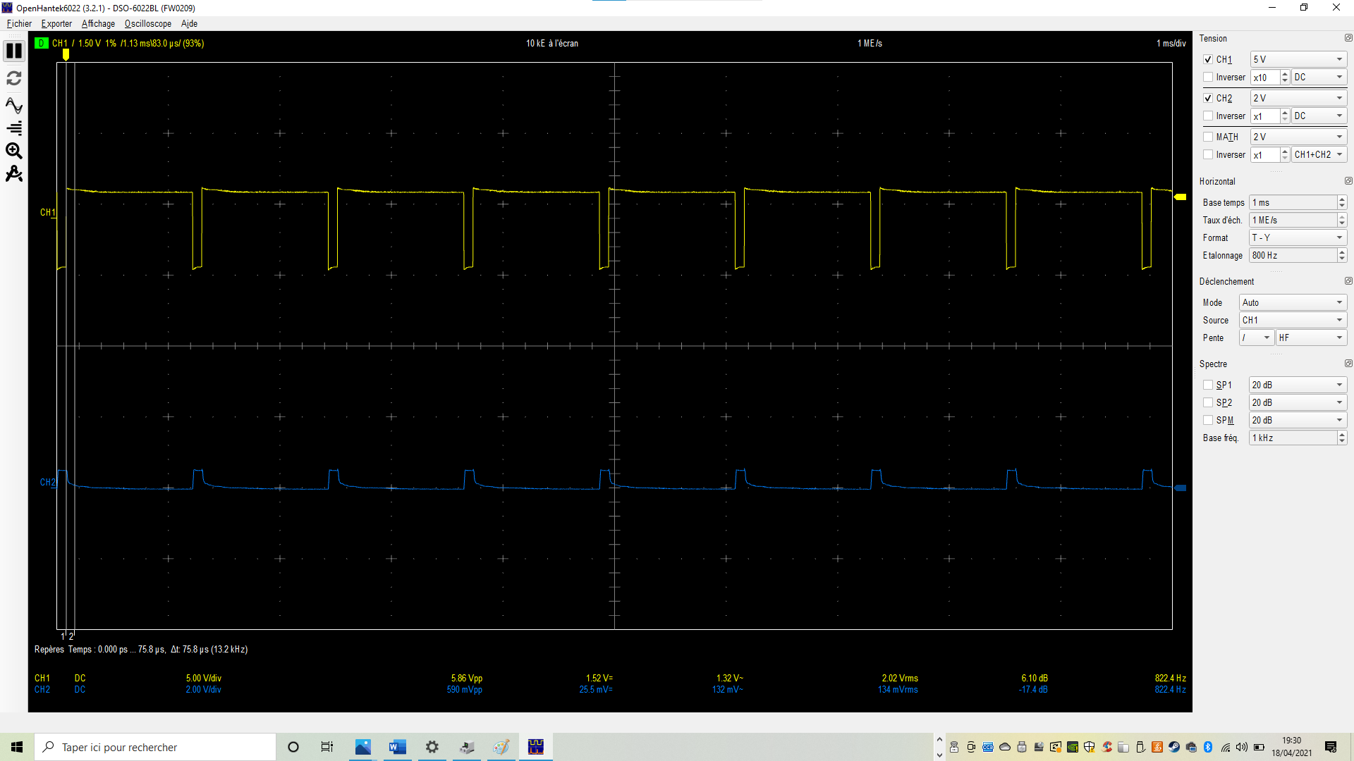

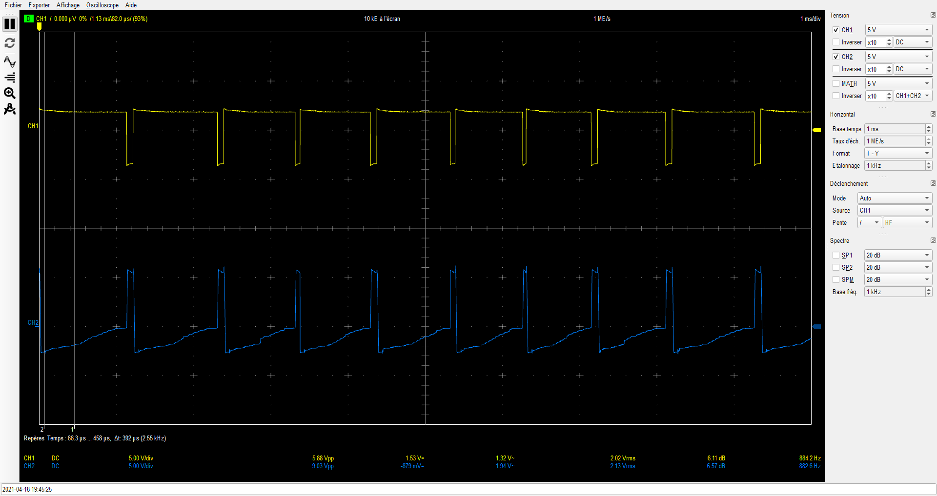

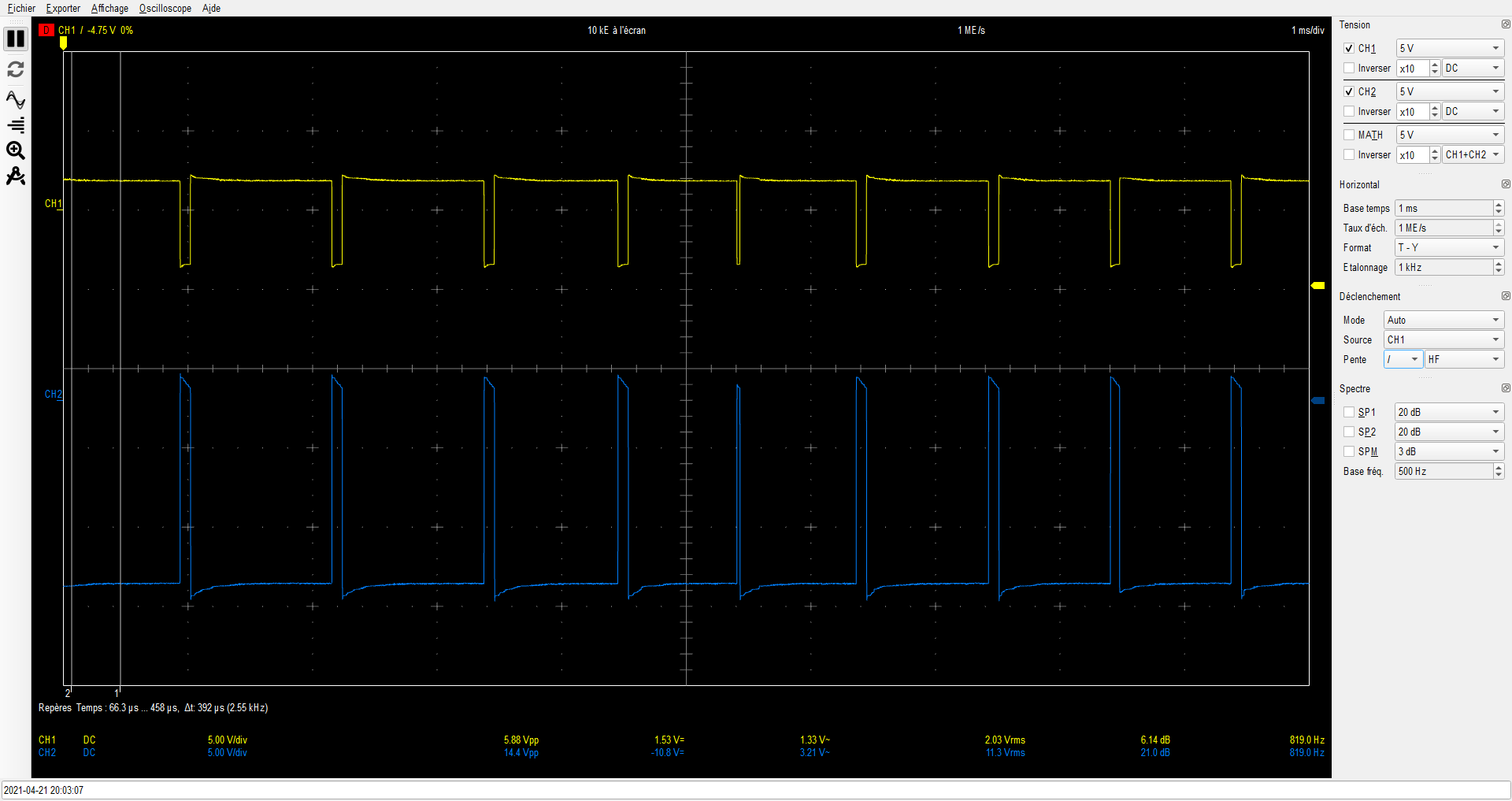

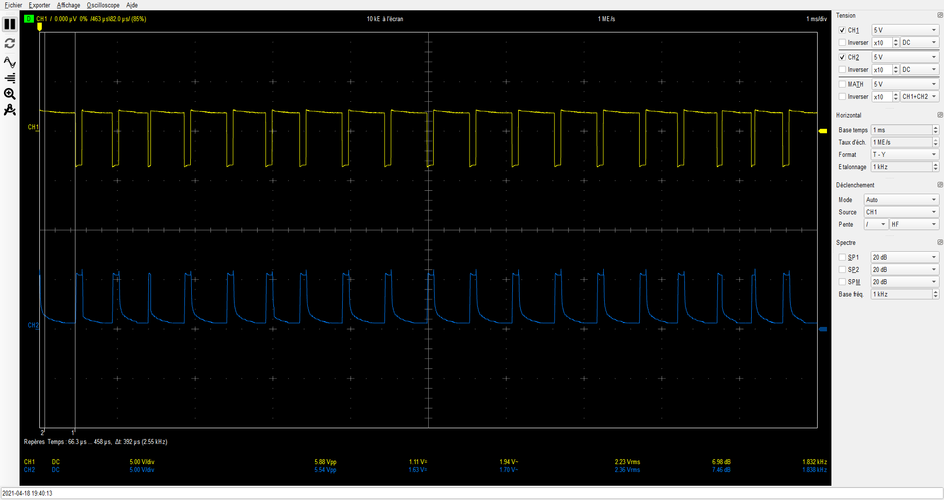

      Here are some pics of differents test points :
      This is for TP1 upside and TP4 at the bottom

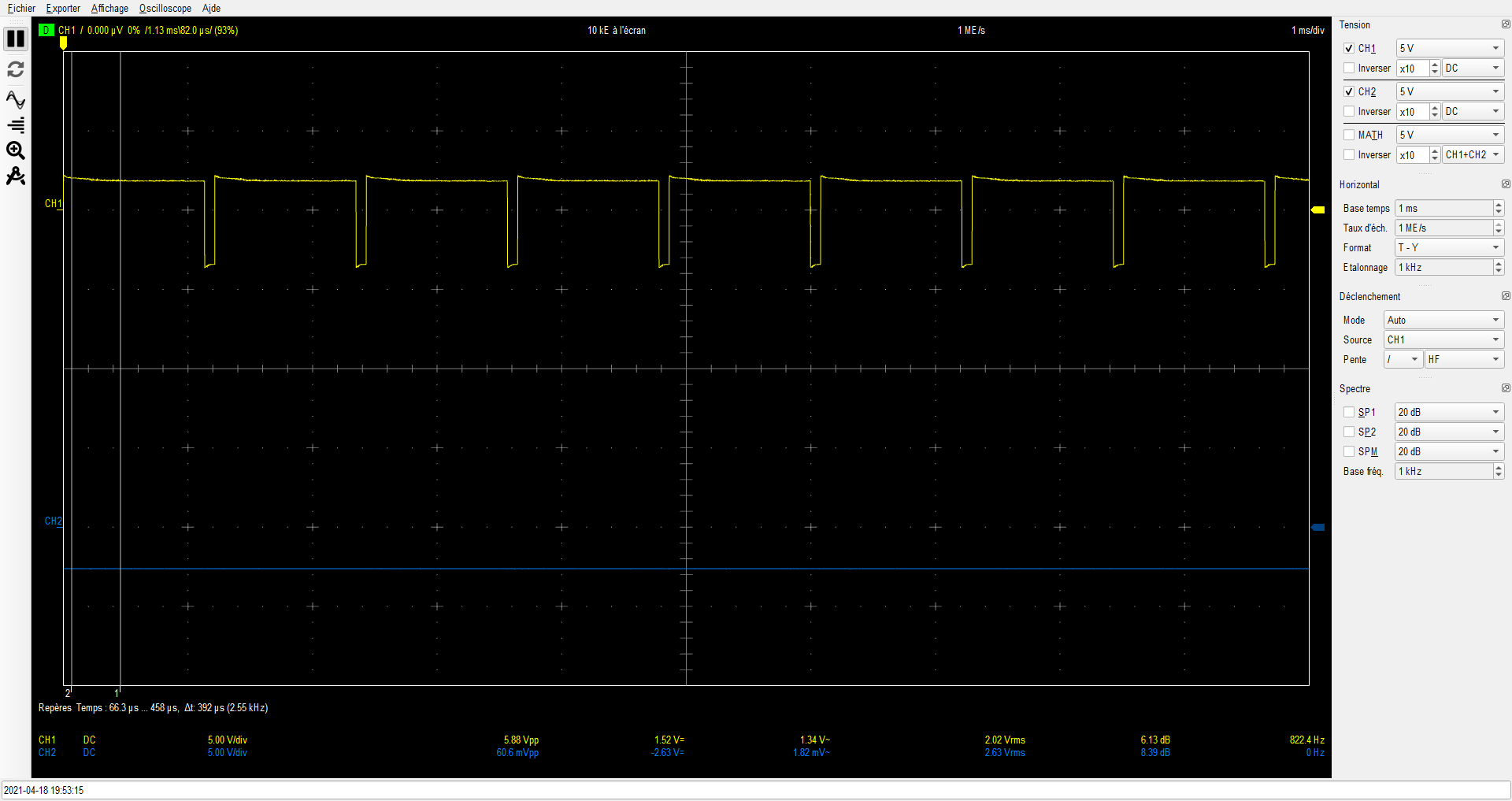

      This is TP1 and TP9
      Seems that something is bad...
      For R31 I have 0.4V/1.28V CCW and -1.28/-2.32V CW R35 Varies between -3.45V and 0.
      For TP2, you don't think that it's OK with the X10 attenuator probe? That permit 350V I think.
      P.S. : Sorry for my English, I'm French.
        TP4 is definitely wrong. My first thought was R10... it looks like you have the right value but check the solder joints, they look iffy. Probe the gate on Q3, the little jumper next to Q2 is convenient. You should get a nice pulse that looks like TP1 upside-down.

          I finally have find time to make some more tests.
          I've just see that the fist photo I've sent is not good. Not the same scale for TP1 and TP4. Here is the correct photo:
Name:	TP1 and TP4.png
          For Q3 Gate, you can look that here:
Name:	TP1 and Q3 gate.png
          As now the scale is the same it seems not good...
          For R10 I have resoldered it and some other components, but not better...
          Have you got any idea?
          Thank you again Waltr and Carl!
