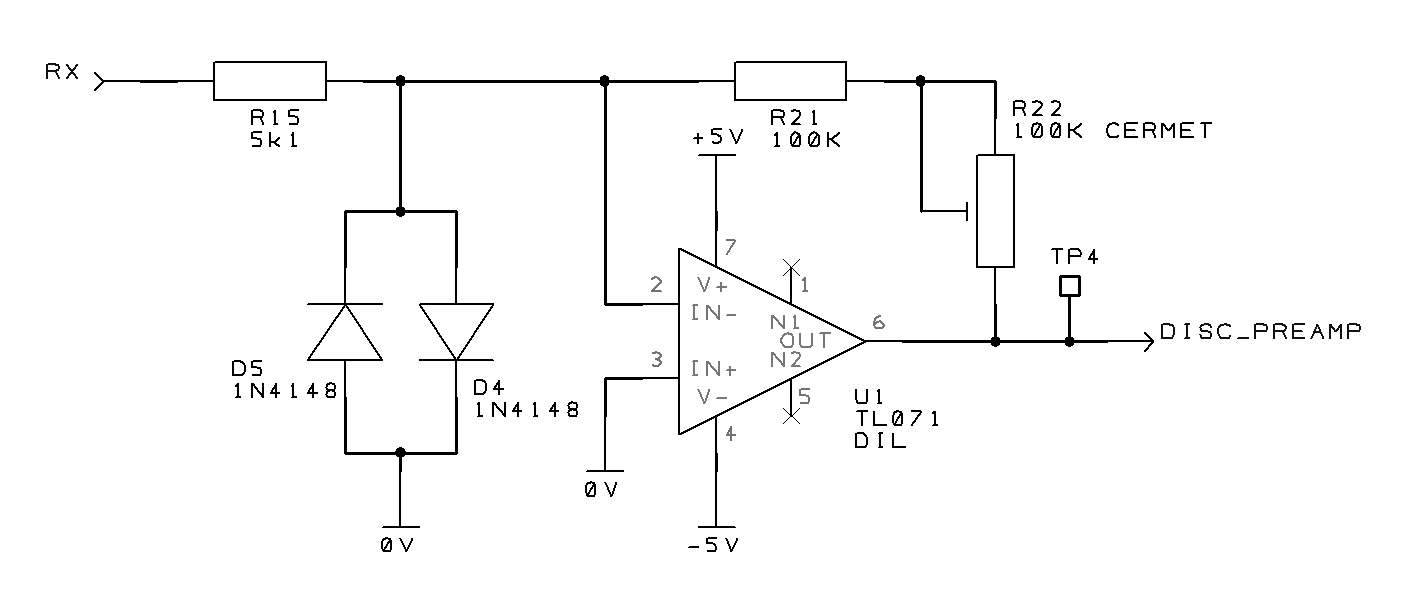

                  Please see attached, is it possible to guide me how to adjust R22 (TP4)?

                    I have not tried to use a GPX DD coil.
                    The trimmer is only there for experimentation purposes as explained on pages 20 and 21.
                    There are no guidelines on how this should be adjusted.

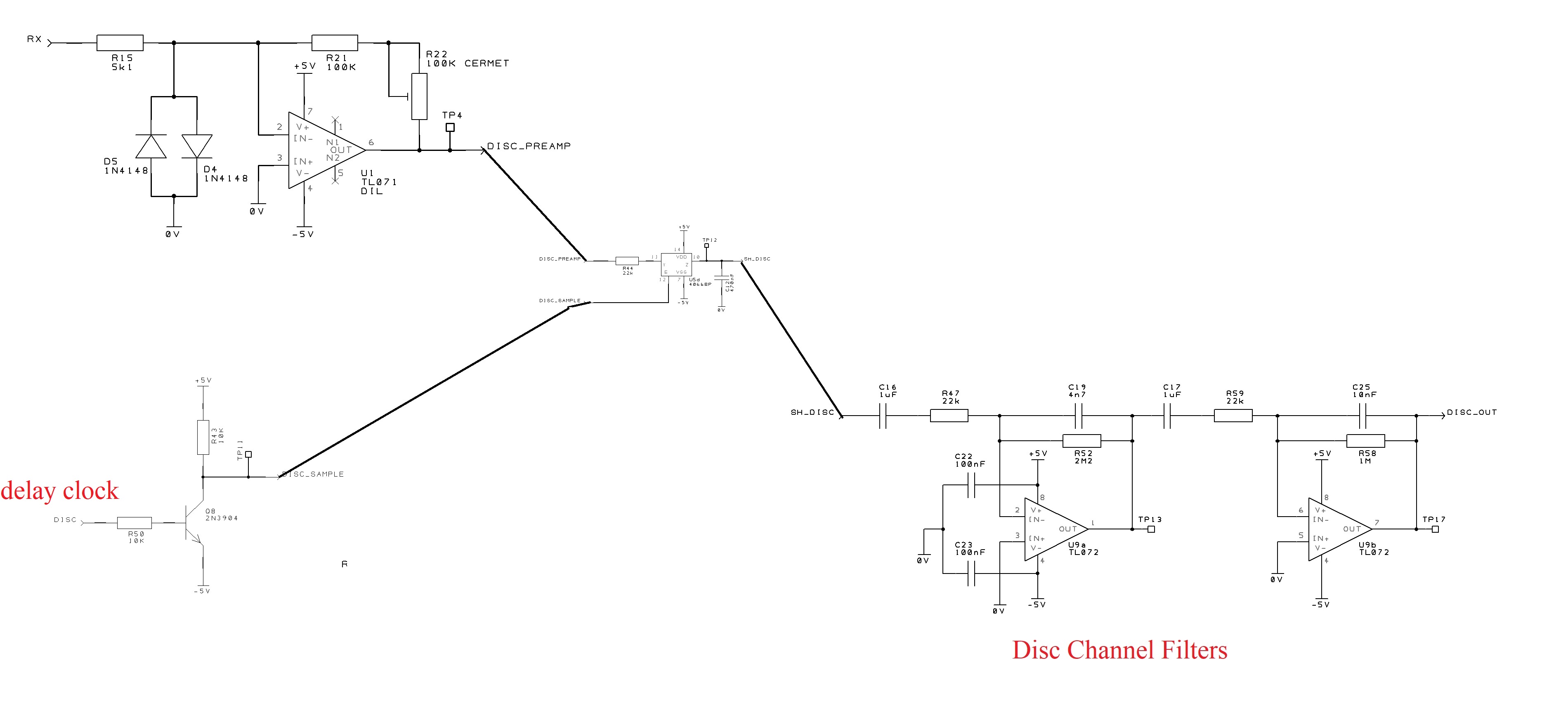

                          Dear Carl,
                          As you know, you helped me about adding GB process (based on 4 delays) in my HHD.
                          It works very nice and easily removes mineralization, while we can stay in lower delay (10-25us).
                          Now, i want to develop my HHD+GB by adding DISC part of VOODOO. I hope you accept to help me to do it.
                          Please see attached, i can add a separate delay + pulse-width in my HHD for DISC-Sample and connect it to 4066.
                          My problem is at final output (DISC_OUT). I think the out is DC voltage, do you think i can connect it to TL072 and turn on a simple LED (only for F)?
                          Actually, my purpose is that first a target is detected. Then, check its F/NF via this method.
                          Thanks.
