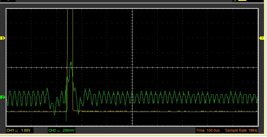

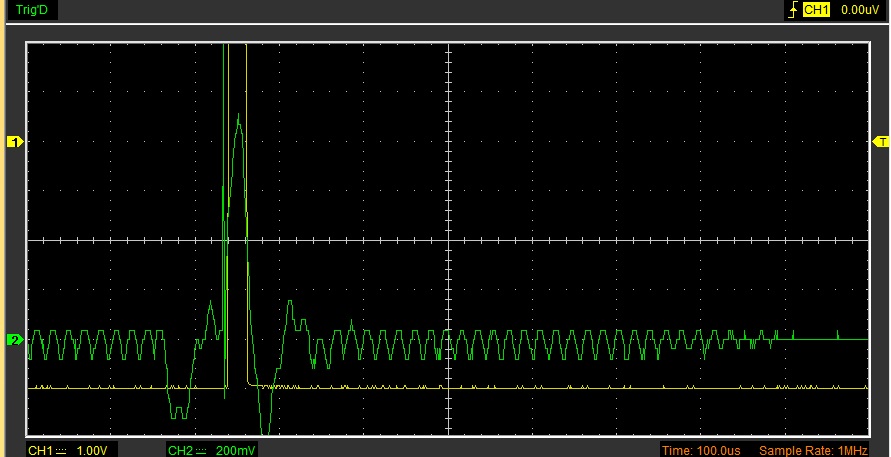

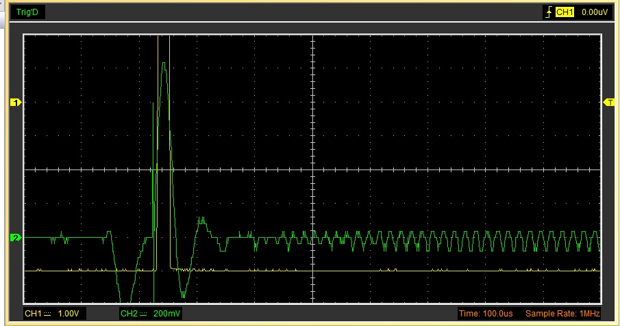

                    I checked TP4 and TP11 on scope.
                    Coil is GPX, TX=300uH, RX=940uH, 270n parallel to RX
                    No target

                    Iron
                    Copper
                    For both Ferrous and non-ferrous target, the outer lobes on DISC signal goes positive!
                    I also changed terminal of RX, no result.
                    Maybe i must use concentric coil, instead of DD coil.

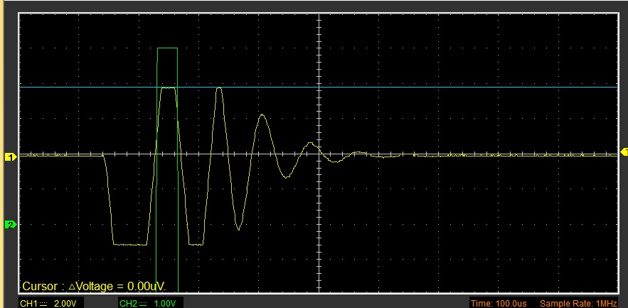

                    • Before everything, i have to thank you from dear Qiaozhi for his Voodoo project.
                      After trying, i could find my problem.
                      Yesterday, i built a concentric coil and tested its disc.
                      The project discriminated very nice between F and N-F metal.
                      In addition, the Voodoo also works over GPX coil.

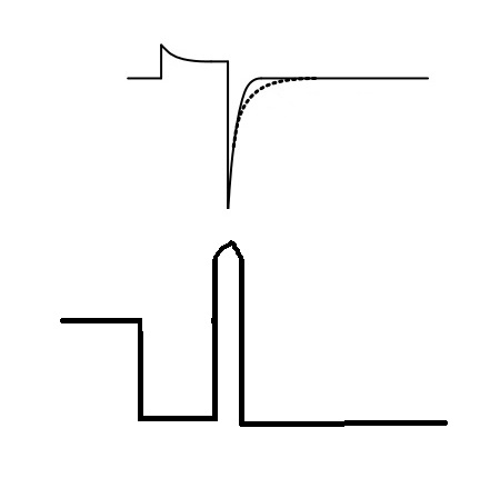

                        Hello
                        Dear Walter.
                        I have a question about your experience.
                        I built concentric coil and checked its sensitivity. It's very good but i see a strange form at scope.
                        Please see attached, there is two forms for preamp. First is original and the second is its reverse.
                        When my concentric coil works very nice, my preamp form is the second (revers). Do you have suggestion for this?
                        Thanks.

                            • Look at photo 'coils nulled' in post #6 of my HH2 thread.
                              This looks close to yours.
                              DD or Concentric coils when Nulled give a very different wave form in a PI compared to a mono coil.
                              For more go read Tinker's threads.
                              It takes a bit of tweaking and testing to find best null.
                                Thanks dear Walter.
                                After trying, i learned how to find null point for concentric coil (45cm).
                                I tested it over my HHD, HHD+GB and Voodoo. It works very very nice.
