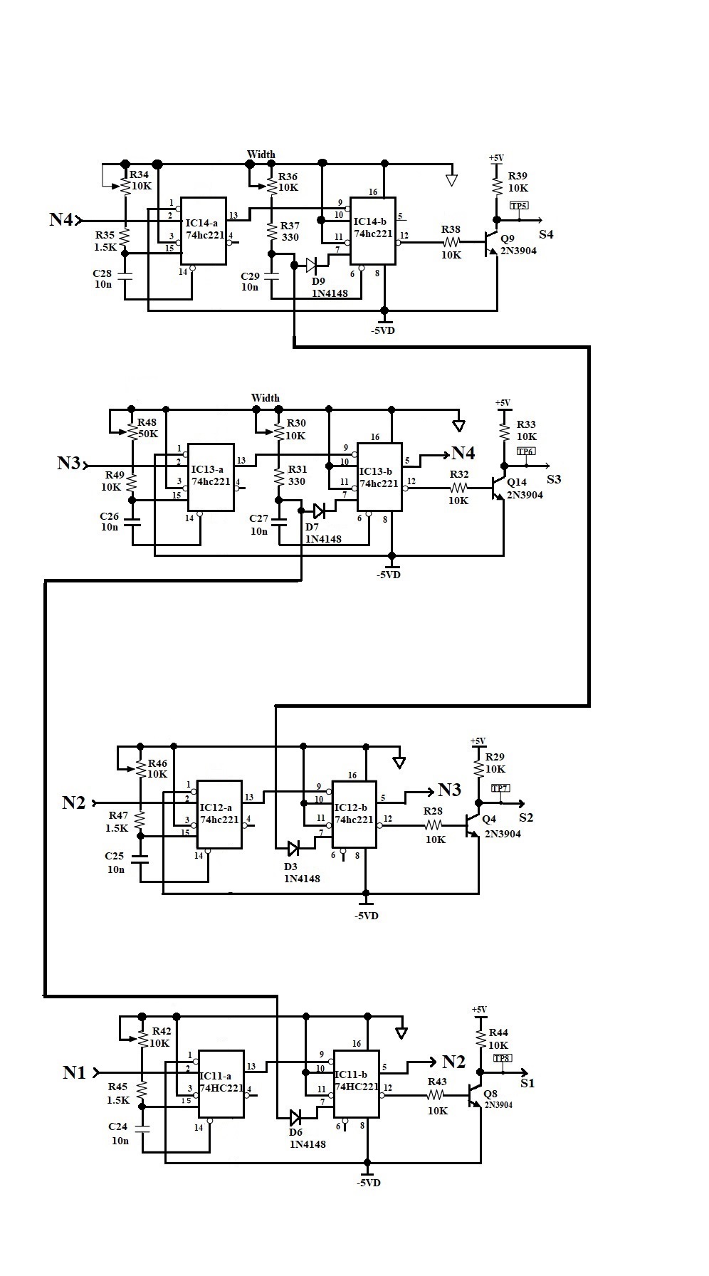

                        Hello
                        Dear Carl.
                        I have a request, is it possible to check the 4-sampling (attached)?
                        Do you see any error?
                        Thank you.

                        • #42
                          As far as I can tell it looks like it will work. You will need to adjust RC values to get the right timing delays. Don't ask me what they need to be because I don't know, that's something you'll have to figure out.
                          • #43
                            Thanks dear Carl.
                            I'm going to find the RC values with tests. But before doing, i need to be sure from correctness of my schematic.
