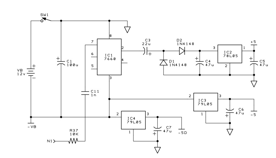

        • #49
          Hello
          Dear Carl
          I have a question about power of HH1. First, my HH1 worked without any problem, but it shows suddenly an instability behavior.
          I started to test its different points, finally i realized that my +5V is +1.5!!!
          I changed 7660 and its IC2 (78l05) but my voltage still is +1.5!
          Do you have any suggestion to check the problem?

              • #52
                All of the build information is here:
                https://www.geotech1.com/cgi-bin/pag...head/index.dat
                Thanks, but i read its article and all of it.
                I'm trying to use Mr. Mickstv's Audio over my HH1.
                But i have some instability in his audio. I checked my TP4 voltage and it will easily set 0, i also checked my form wave and it's OK and i have good reaction with coil.
                I think my instability audio is because of TP5 or TP9. Now, my R23 has not any affect over pins 2,3 of IC8, so i set it center, its voltage varies under 0V.
                • #53
                  It could be something is overloading +5. Try removing the opamps.

                            • #59
                              Is your mean TL072 or NE5534?
                              Do you think i can use AD797 instead of 5534?
                              You said earlier that +5V was not working. Have you fixed that? If not, remove ALL the opamps and see if +5V works. If it does, plug in each opamp and see if one of them is bad.
                              Yes, the AD797 will work for the preamp.
                              • #60
                                Thanks dear Carl and green.
                                My problem is solved. Unfortunately, my two 7660 has problem and can't generate +5V, so my HH1 worked unstable.
                                Now, my HH1 works very very nice and stable, tp4 is 0, pins 2,3 of IC8 is 0, TP5 and TP9 is 0. I checked the points with my voltmeter and mini O-scope.
