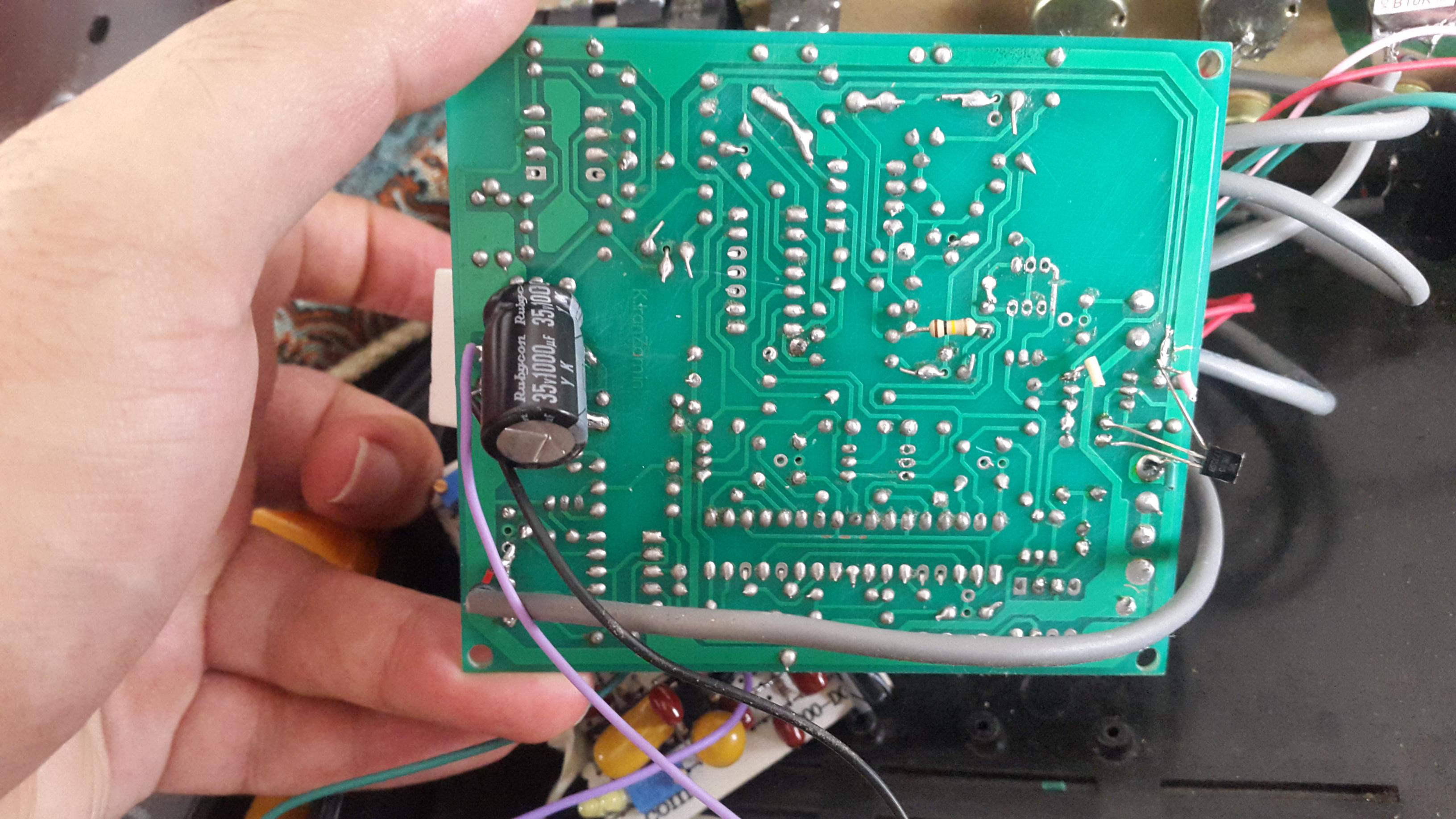

      • #63
        Hello
        Dear Carl
        I have a question about adjusting TP4 to zero.
        I set the point exactly to zero, but the adjusting will be changed after a short time.
        For example, i adjusted it to zero yesterday, but it's 640mV now and my HH1 is again unstable!
        I again checked my +/-5 voltage, it's OK. Do you think it's because of my bad 5534?!
        • #64
          An offset at TP4 should not cause instability. If you readjust TP4 to zero does it become stable?
          • #65
            No, it is still instability.
            I even touch or near my finger to internal coil wire that is connected to 5-pin, my HH1 detects it.
            I checked TP5 voltage, my pulse width and main delay pot change its voltage!
            As soon as connecting coil to my HH1, i have action even with the slightest movement, even in air.
            I also used GPX-5000 coil because it has shield, i again have a very very noisy action!
            I think my HH1 is not working correctly, i also checked TP4 form in O-scope, it's OK and can detect metals but it's very very instability.
            Do you think my C27, C14 and C15 has problem?
            • #66
              The voltage at TP5 can change if timing is changed. No, I doubt the problem is with those caps. If you see a lot of noise on TP4 then you are probably picking up a lot of EMI noise. Try disconnecting the coil and see if TP4 is still noisy.
              • #67
                If no connect coil, i have no noise in TP4 and my audio is clear.
                If no connect coil, voltage of my TP4 is 640mV.
                AT is active, i have no noise if coil is static.
                As soon as the slightest movement, i have reaction.
                Before i tested it in this place more and more, it was very very stable.

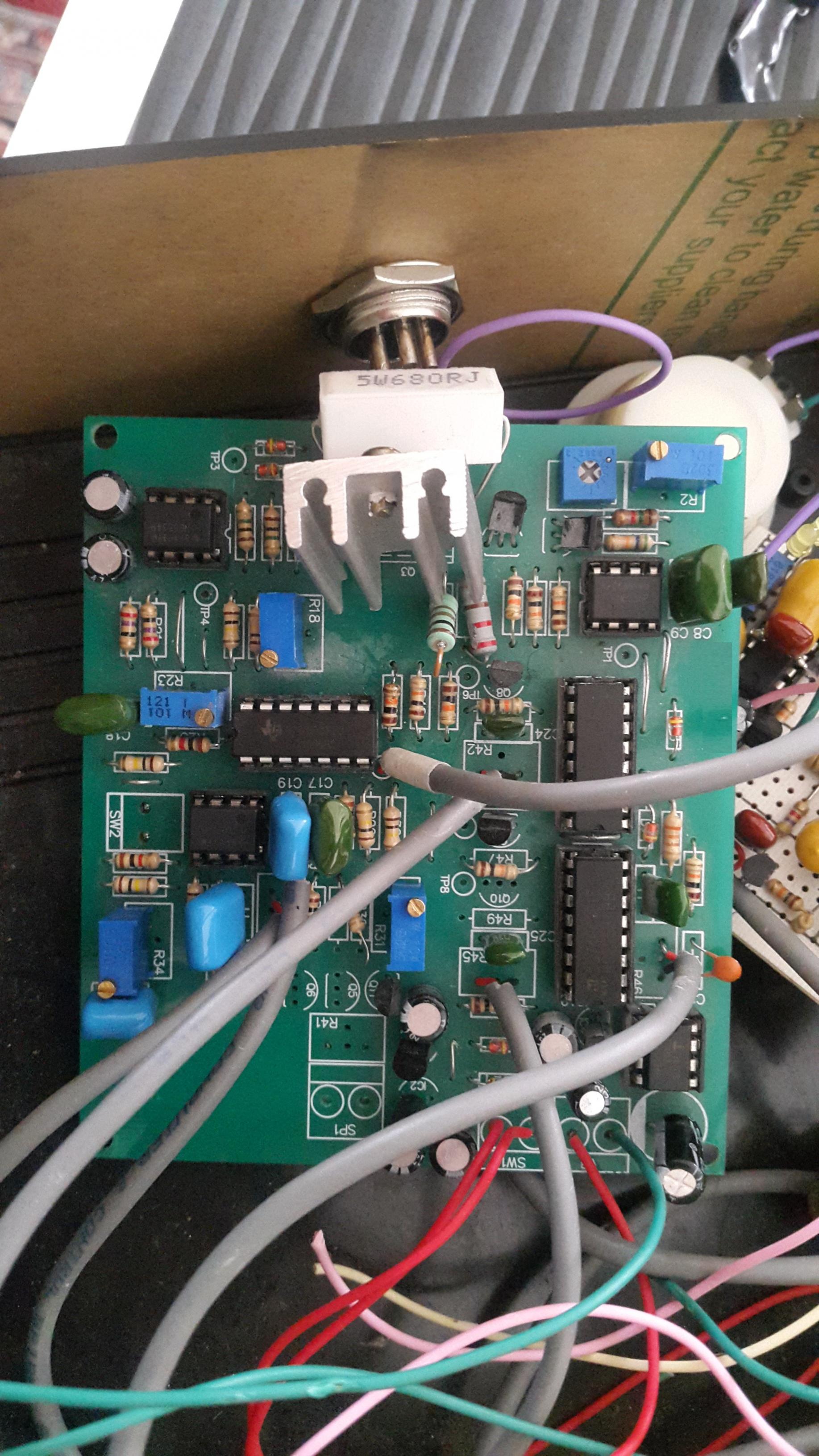

                        • #72
                          He gets the same noise when using a Minelab coil.
                          Besides EMI, it could be that the gain is way too high. Double check your resistor values. Make sure they are connected properly, with good solder joints. Post a pic of the board.

                              I think i have to build a new PCB, but this time Rev. D version.
