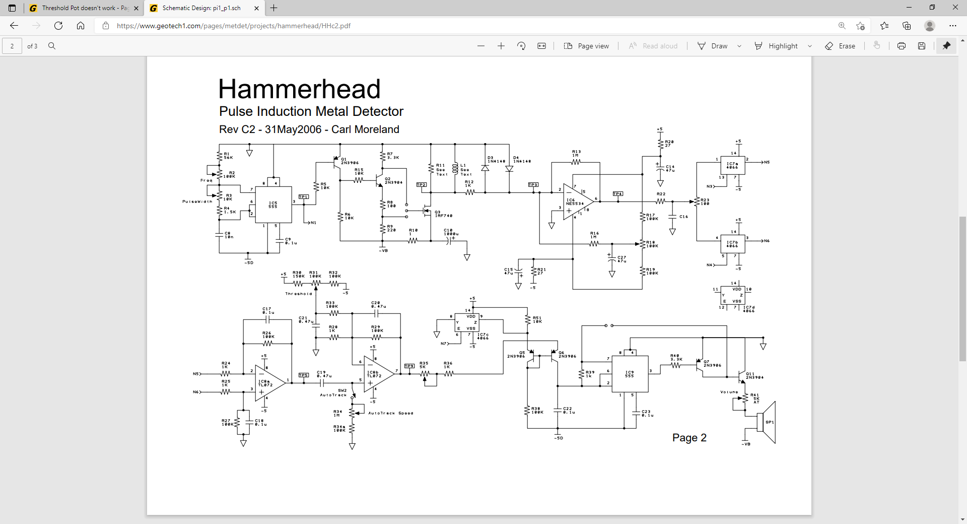

        Thinking disabling Tx might be a good place to start trouble shooting. EMI and EF only. (schematic)https://www.geotech1.com/pages/metde...rhead/HHd1.pdf Could connect Q3 gate to -VB. Where does the jumper go to enable Tx?
        Thanks dear green.
        I am using rev. C2.

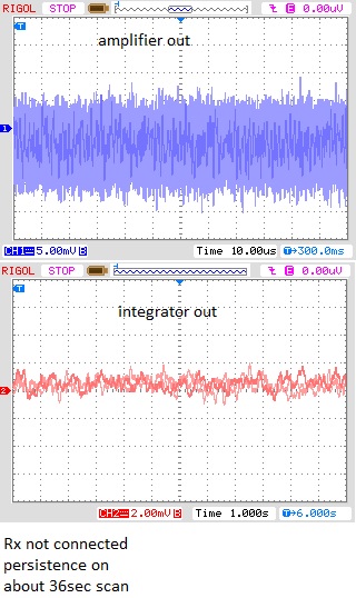

                      Another problem is how to determine p-p voltage. If I had an analog scope maybe I could use a low sweep rate. With my digital scope I use persistence to display many samples at a higher sweep rate to be sure I sampled all the peaks. A scope picture of my amplifier out, not the same gain and BW as HH. The last sample shows in the many stored samples. Maybe there is a better way?

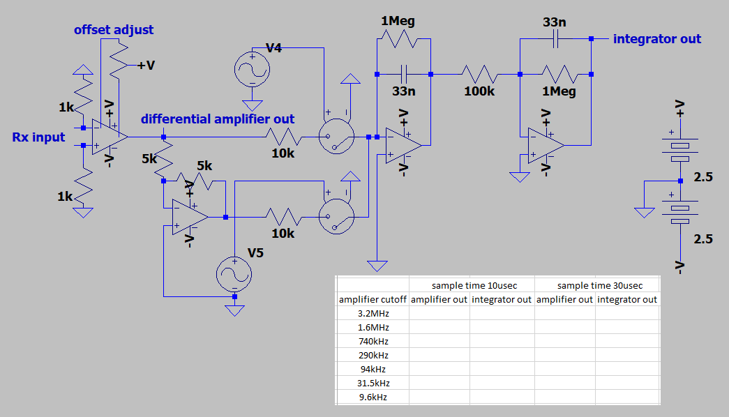

                            Don't know how to calculate noise at integrator out. Thinking of doing a test with my circuit to try and learn something. Coil not connected, noise caused be amplifier and the two 1k input resistors. Record p-p volts at amplifier out and integrator out at different amplifier cutoff frequencies with two different sample times. Any suggestions for improving the test?
                            amplifier cutoff set by the capacitors I have

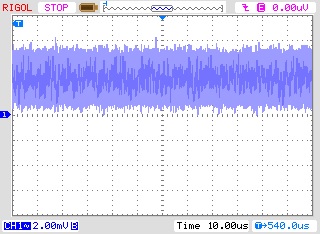

                              A test with amplifier cutoff=3.2MHz, 1000pps(Tx and Rx not connected), 10us sample(both target and EF sample). Schematic reply#88. Integrator gain=1, second stage gain=10(added to get enough scope signal, 2mV/div scope lower limit). Anyone know the formula to calculate integrator out noise from amplifier out noise? Plan on doing the other test points but would like to know if the first test point makes sense or do I need to do something different.
