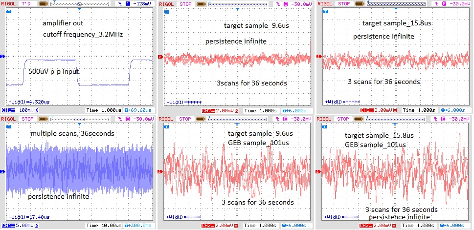

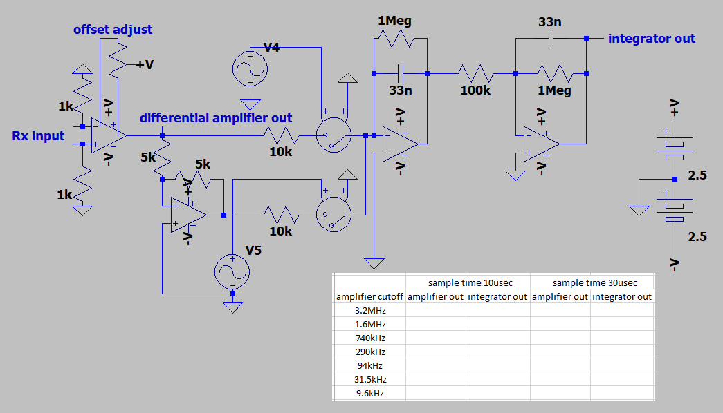

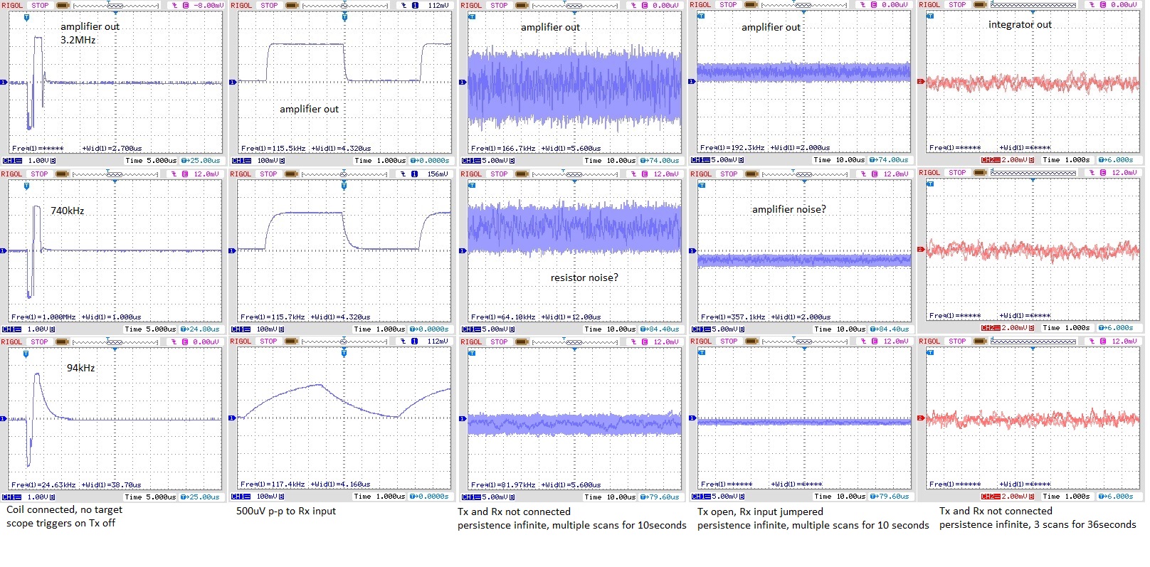

            Don't know how to calculate noise at integrator out. Thinking of doing a test with my circuit to try and learn something. Coil not connected, noise caused be amplifier and the two 1k input resistors. Record p-p volts at amplifier out and integrator out at different amplifier cutoff frequencies with two different sample times. Any suggestions for improving the test?
            amplifier cutoff set by the capacitors I have

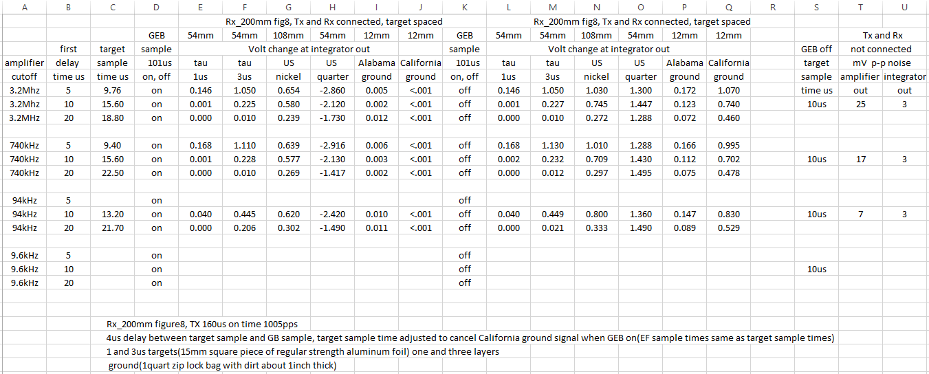

            Finally got around to trying a test. Thinking I should add target effect plus noise at different cutoff frequencies. Any thoughts what I might add or do different? Would like to not repeat changing cutoff frequencies to many times.
            I set first delay time(adjustable), second delay for 4us and GEB sample time for about 100us. Then adjust target sample time for minimum ground signal when GEB on.
            I see one of the target samples is seconds instead of us

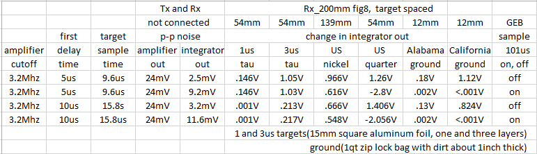

                          • Some more testing. Reply #95 has the nickel tested at 139mm (should be 108mm, I had three spacers on the desk. looks like I measured all three but used only two) integrator test_1
                            1 tau, 3 tau and quarter were spaced at 54mm. The nickel spaced at 108mm. ground spaced 12 mm.
                            Reducing amplifier response reduced noise at amplifier out, not so much at integrator out.
