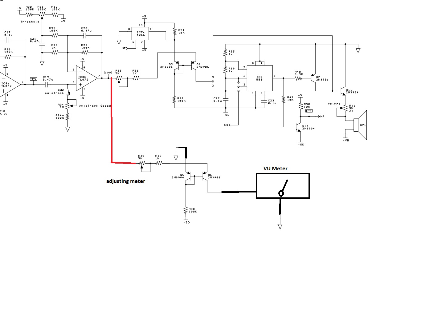

        Is it possible to add a meter (for exp. VU or uA meter) to HH1?!
        I suppose so, the collector of Q6 could drive a meter. If you want both meter & audio then add a parallel R35a, R36a, and Q6a. Adjust the R's for whatever meter you want.
          Thanks dear Carl.
          Is it possible to see the attached? Is it correct ?
          • Yes, that is what I was thinking.
            Edit: the other side of the meter needs to be -5V, not ground.

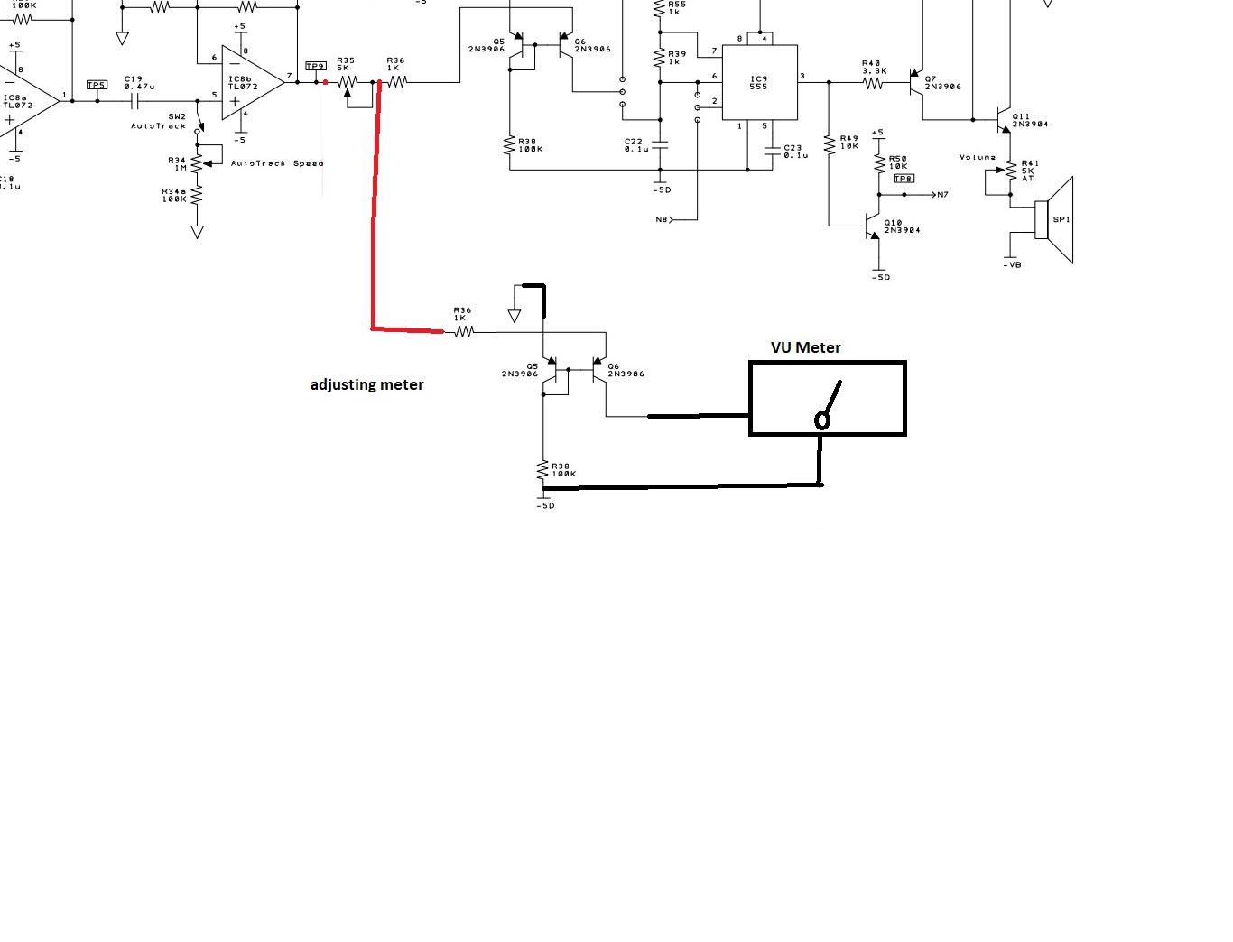

                    But i have still problem with my VU meter.
                    According to your advise, i built the attached circuit but i have no any reaction over meter.
                    Before building, i tested my VU meter, it works correctly.
                    I checked all of Ground (+12), -5 connections using MM and all is correct voltage.
                    I checked both pins of meter with MM, both voltage is -5V!!!
                    • I measured voltage collector of Q6 in my HH1, it is -2.5V, while my VU meter is micro range.
                      Similarly, i measured voltage collector of Q6 of my meter part, it's -5V.
                      I think i should use Ampere meter but i don't know which range is good (uA, mA or A).
                      I'm sure my circuit is without any mistake, i built twice and checked more and more.
                        Sorry dear Carl.
                        I had a mistake, it works very very nice!
                        Thank you for your advise.
