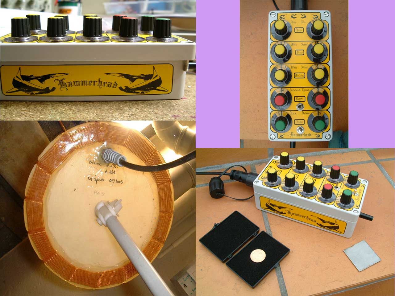

    I just finish the assembly of my hammerhead.
    I look very sensitive: a money of 20mm in gold ( NAPOLEON) is detect at 230 mm and a piece of stanless steel metal of 40mmx40xx ep 2mm is detect at 350 mm : very very good. The coil is made with 37 turn and diam ext is
    Thanks Carl for this design.
    Afterthought, I think that the VCO adjustement not need to be on the top of the box and the value of the autotrack adustemnt could be 1 Mohms instead of 100 Kohms. Otherwise all is good, very good. Just for carl.
    I jpoined some pictyre of my box finish.
    BYE BYE,
    PhilippeM
    Sorry here is the picture
      coil
      Philippe, IMHO, you could be drilled the coil, gotta a ring, relocating a thimble slightly to edge. it gives a better target pinpointing.
      HH
        Re: coil
        HI,
        Sorry for my bad english but what's mean IMHO?????
        Thanks for your advice but this was my first coil , the second one is like the picture .
        BYE BYE
        PhilippeM

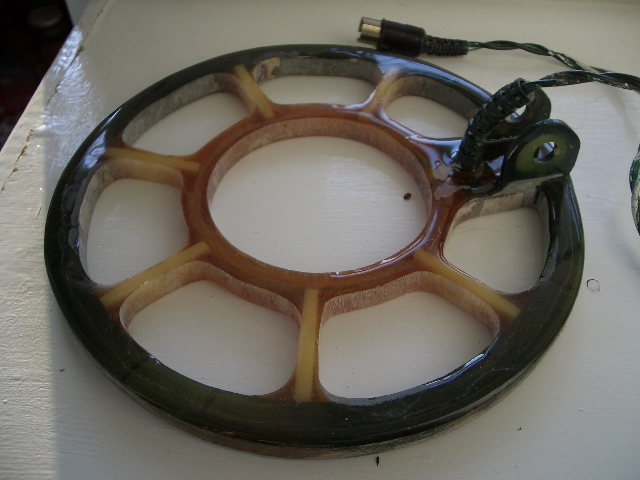

          Re: coil
          hello,
          IMHO is 'in my humble opinion', as I understand English
          another variant of basket coil, I found this link in PI classroom forum.
          yours
          Click Here
