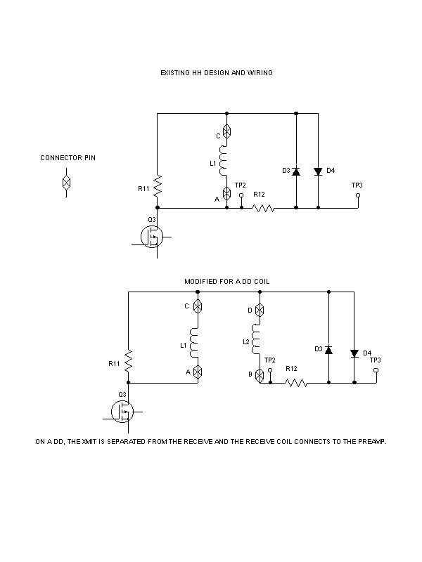

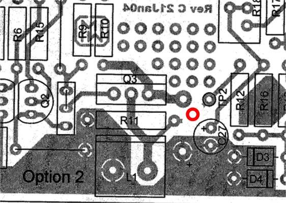

    Is it possible to modify the PCB to use and experiment with DD coils?
    southernexplorer
    Yes, the PCB can be modified so a DD coil can be used. Once modified, then a mono coil connector will have to be modified so it will work.
    A plug should be used for the coils so they can be changed. Now, on a mono coil plug, a jumper has to be added to reconnect things.
    To modify the pc board, the receive circuit has to be separated from the transmit. This is done by cutting a trace on the board. The logical trace to cut is the one between R 11 and TP 2. Then TP 2 can be used as the connection for the receive coil on the DD coil. If my pic comes through, you will see a red dot indicating the location where the pc board should be cut. The red dot is simply a marker to show the location and is not part of anything.

      Hi Again,
      Once the pc board is cut, then one has to connect the DD receive coil to TP 2. The receive coil does need a damping resistor that can be mounted in the coil housing or better yet, in the coil connector. This way each coil can be tuned to the PI. This allows for a wider range of experimenting.
      The transmit coil still needs the original damping resistor, so the new schematic would look basically like the pic attached. I have just shown the transmit and receive coil circuitry only for simplicity. The rest of the schematic of the HH would be the same as original.
      On the attached pic, L1 is the xmit coil and L2 is the receive coil.
      Reg

          Hi All,
          Anyone wanting to switch coils should use a connector. This way, not only can the coils be switched quickly, but by adding a simple jumper inside the coil connector, one can go back to the mono coil design when desired.
          By looking at the modified schematic, pins A and C of the connectors would connect to the transmit coil. Pins B and D connect to the receive coil. By adding a jumper between A and B, and not having a separate receive winding, one can simply use the mono coil. The connector half mounted on the control box would never have to change. Any changes would be done in the connector attached to the coil housing. By doing it this way, the change is transparent and simple to do.
          Since most pins in typical plugs are numbered rather than lettered, then one would simply substitute the pin numbers for the letters in the connections. A simple and easy to get connector is the mic connector. Minelab uses a 5 pin mic connector for their PI's. I use the 4 pin since it is a little easier to work with.
          Hope this makes sense.

                    Hi I want to add the double D mod to my Hammerhead but I'm still confused on how or where to add the damping resistor for the second coil. Does the resister just need to be connected to the coil, go across both sides of the coil, or what? Any help is appreciated.
                      Both coils will need their own damping resistor. For each case you need to connect the resistor across the coil.
                        not so good decision for RX coil. you can use simplest RC filter you see in VLF type design coils. R set in serial to coil, C set after R on input of opamp.
