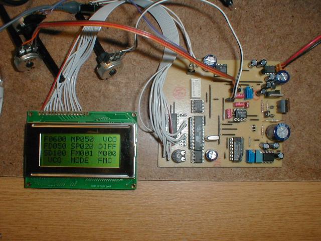

      Hi, this is my version of HH:
      all timing, switching VCO-mode and switching single/difference-mode is done by a µP (AT89C4051).
      Display shows frequency, first and second delay-time, main pulse, sample-pulse, and used memory (20 memories to save settings availiable),
      most of components like R's C' and Q's are on the layer-side of pcb (SMT).

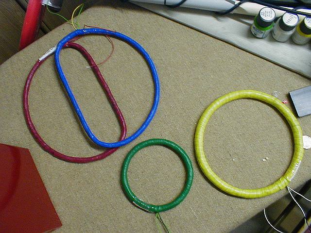

      Another pic shows some of my homemade coils.

        Very colorful coils! And I like your design... very close to what I am (slowly) working on in HH2.
