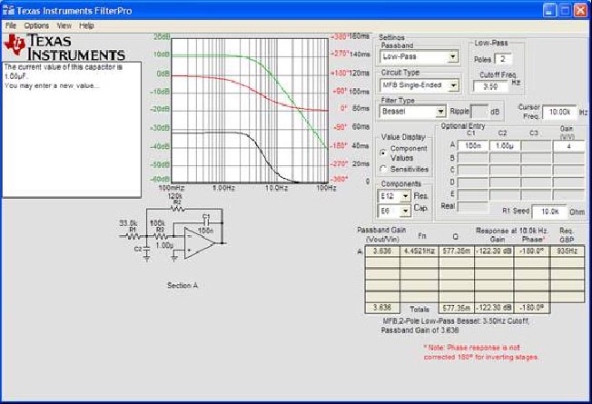

    I think I have discovered the one modification that greatly improves the operation of the HH. An active filter, 2 pole Bessel with 3.5hZ cutoff, followed by an inverter (to get the signal back to the correct polarity for the autotune circuit), placed after the output of the the differential integrator (IC8a). The output of the inverter feeds the existing autotune circuit. Solves all my instability problems and give smooth operation. Sweeeet!
    Used a TL072 to implement the two stages (active filter and inverter). The values for the active filter used were determined by FILTER PRO (see attachment).
      A clearer attachment!
        The TI Filter Pro is a great tool and the low pass filter after the integrator reduces the noise considerably.

              I made a similar experience with the low pass filter. Upped the corner frequency to 7Hz
              Got some oscillations when using the Sallen & Key configuration, so changed to MBF single ended and it works fine now.

                I tend to stay with MFB Butterworth or Bessel models. The Bessel has the smoothest response of the two.

                  Combining the LP filter with a HP filter to zero the output, after the S&H, it looks as if a Chevychev LP would give the best bandpass.
                  What are the disadvantages?
