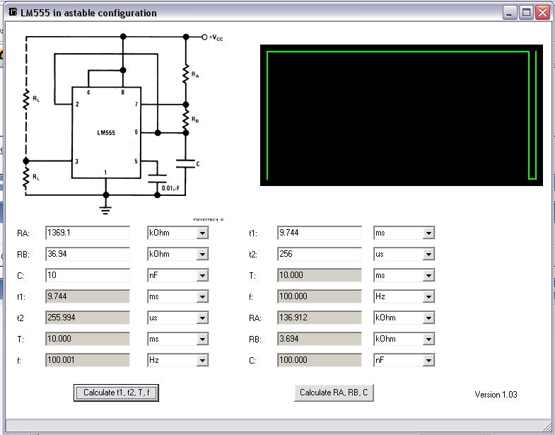

        hi nick i'm using mono coil. i need to 1oo hz frequency and 256 us man pulse width as like gary has done his pulses induction metal detector.....rajesh
          I made some tima ago a program for calculating the values of resistors and caps for 555 working as an astable circuit. I can't guarantee it works ok, but I remember I was getting good results with it last time I tried it.
          I took a screenshot of it and I also attached in here, if anybody wants to give it a try. Basically it sais that: R1+R2 = 136.9kOhm, R3+R4 = 3.7kOhm, C8=100nF.
          That means you can have R1 = 56k, R2 = 100k, R3 = 10k, R4 = 1.5k and you have to change C8 to 100nF instead of 10nF.
          You can give it a try, but I am not responsible if your MOSFET blows up
          If you have a frequency counter, or some headphones, you could listen to the sound produced at pin 3, if it resembles 100Hz.
          Maybe somebody else can confirm the results I obtained.
          Nicolae
            Nicolae

                  hi thank's nick this is good calculator. 100 hz is ok but i need some high pulse width for that coil....rajesh
                    Hi Rajesh,
                    Just tell me what is the width of the pulse you want and I will give you the R and C values. What can be simpler than that?
                    Last time you asked for 256 microseconds, I provided you the values required for resistors and capacitors.
                    If you want 100Hz and 500 microseconds pulse width, just use: RA=129kOhm, RB=7.22kOhm, C=100nF.
                    And I consider the program I attached for you is better than the calculator on that web page.
                    Nicolae
