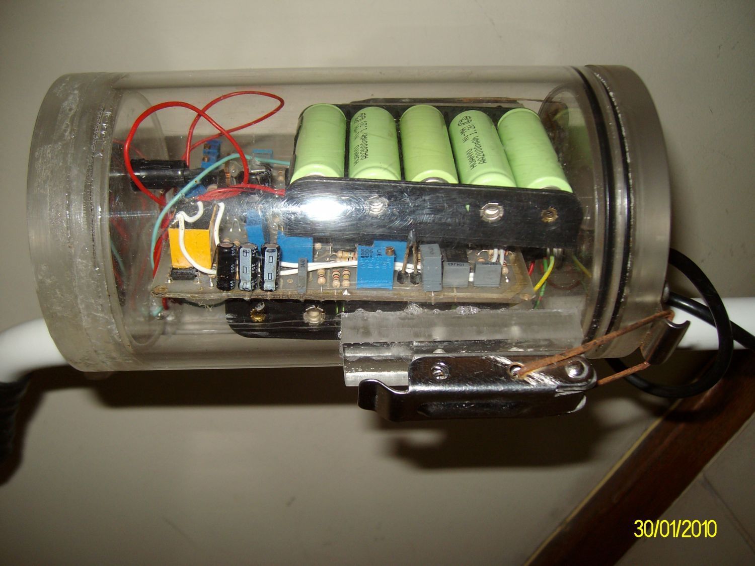

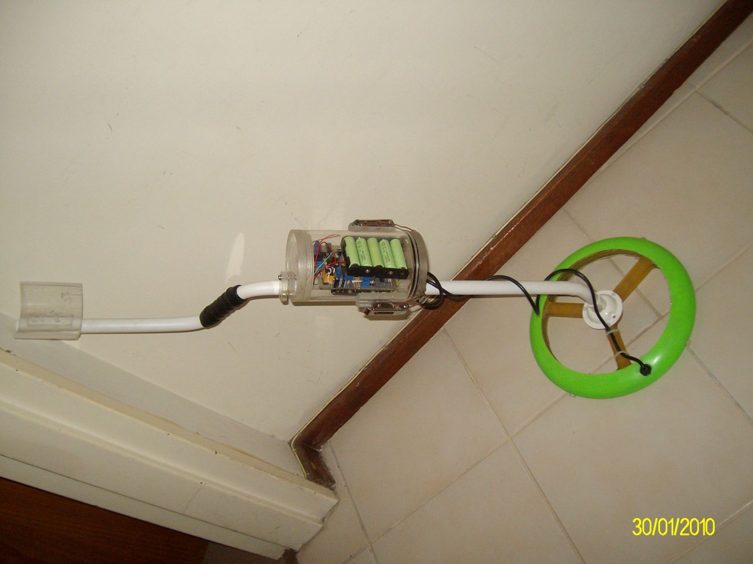

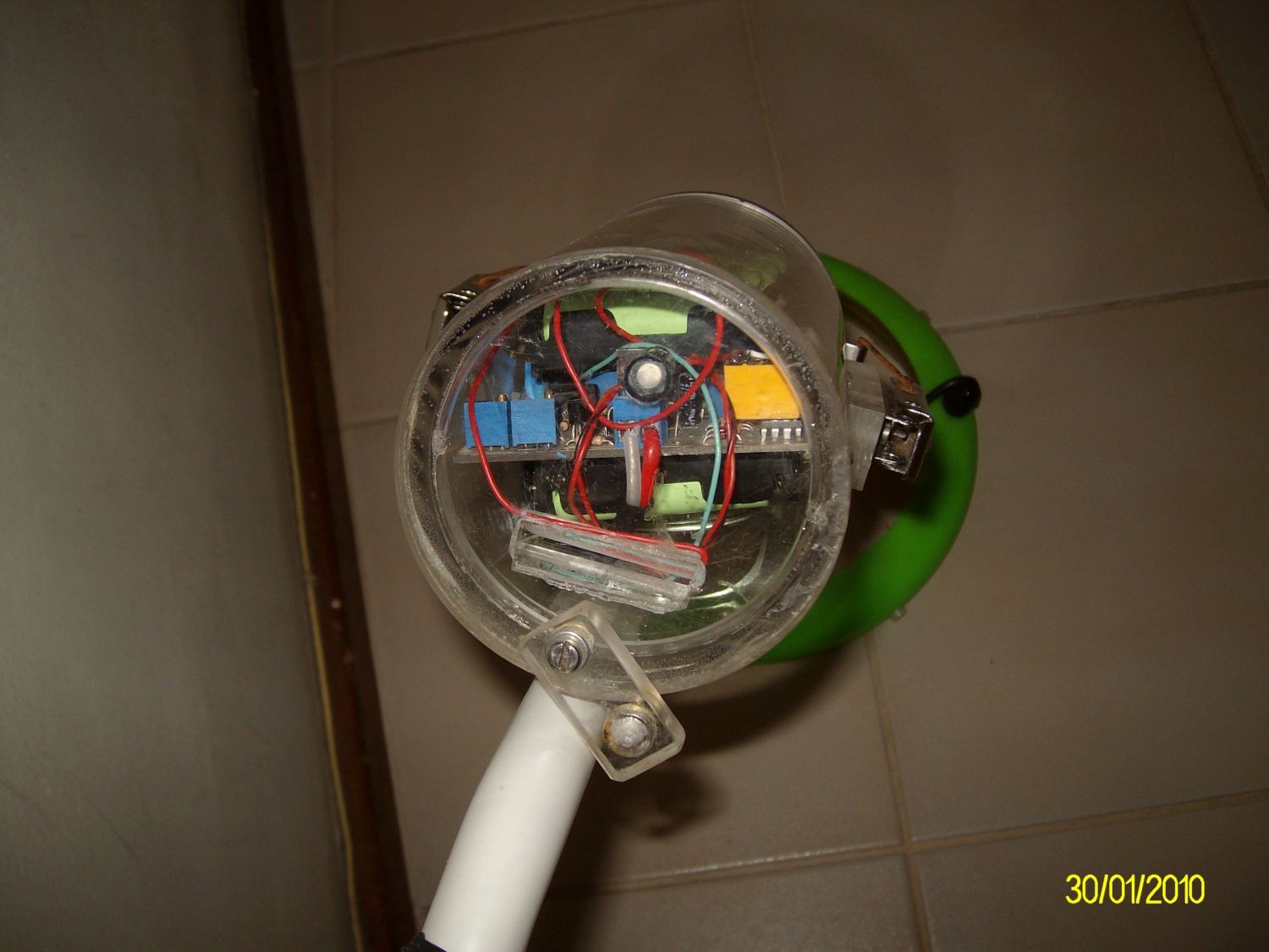

    Hi Guys
    Sorry for the delay but I have been busy at work.
    I have attched pics of my underwater HH which has been tesed to 8 bar (70m) and no leaks. I have used the same design housing for my video camera and lights.
    As can be seen my version is not smd. Hope it helps with the divers.
    Saul
      Hi Gold,
      Nice work! I got a few ideas from your project! I have a few questions... What kind of connectors do you use? Do you use headphones underwater? What kind? how do they connect to the box?
      Thank you!
        I do not use head phone but an ulta bright LED. There are no connectors passing through the housing (no leaks) but you can purchase head phones and waterproof sockets.
