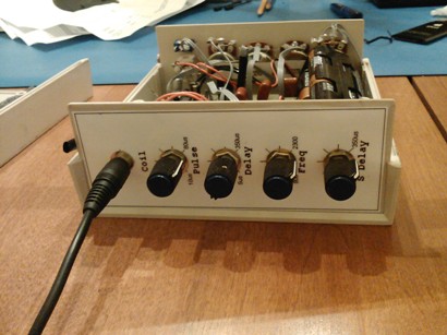

      I used 1% metal film resistors throughout, and poly for most caps, except tantalum or electrolytics for the larger caps. I panel mounted six pots, which have hookup wires going to them, instead of PCB mounted:
      Volume / On /Off
      Threshold
      Xmit pulse width
      Rcv pulse width
      Primary delay
      Secondary delay

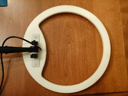

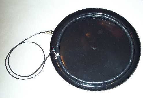

      I'm using an 11" mono coil, wound with PVC insulated solid strand copper wire, with a plastic wire loom between it and the shield. It was just to get this detector to run, before I use teflon for higher quality coils. And I'm using Mogami #2947 coax (18pf/ft) as feedline for the coil.

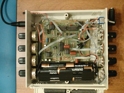

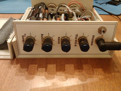

        Hey Kevin,
        Attached is my attempt at a video. It doesn't look that good but you can get the idea.
        It was really tough to get the sound to pick up from the headset, but the HH1 will indicate a target the size of a gold band at around 35cm that I would definitely consider digging. The audio is modulated since I did not do the VCO option
        http://www.youtube.com/watch?v=Lx47Fmt8E_A
        One thing I did notice.. A noisy environment had a very detrimental effect on testing, just like we found out with the TGSL project!! So, maybe nothing wrong with your setup at all. Your setup seems pretty reasonable.
        Other differences are that I used a TL072CP and I did not use the VCO option. I also built an 11" mono coil and used metalized mylar for shielding.
        The only trouble I had at all was that during my first build I did not use a CMOS version for the TLC551CP. The HH1 worked, but not that impressive.
        Settings that seem to matter the most:
        * Minimum delay
        * Maximum pulse width
        * Maximum sample width
        I have used it a couple of times a the beach and for relic hunting and it holds it's own.
        I just got tired of digging staples, nails, sparkler wires and nuts and bolts!
        Don

          Looks like you moved many of the pots to panel mount. I didn't move the sensitivity and frequency pots to panel, but wondered if I should have.

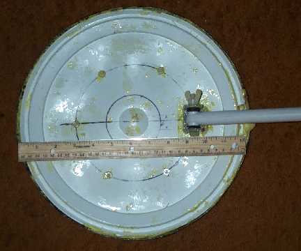

          So I agree, it may be OK. I am in the process of rounding up all of the misc hardware to use it outside. Nylon hardware is not as plentiful locally, as it once was, sadly. Looks like PVC pipe fittings will be the frame

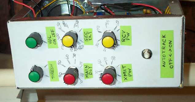

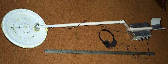

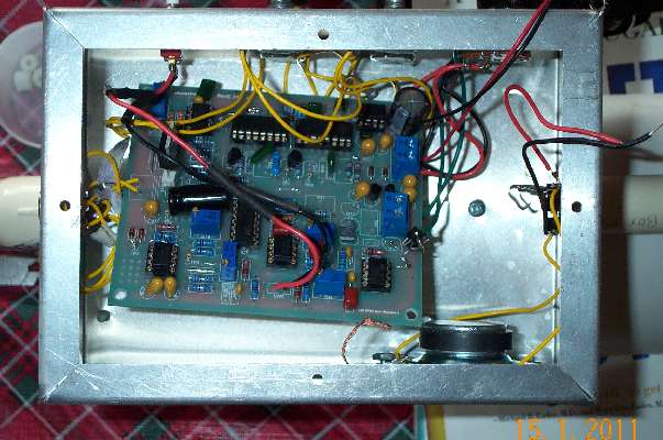

            Photos & results of HH1, Ver C, option 1
            Below are various photos, showing the control panel, main enclosure, coil, frame support, etc.
            Next post I will list some air test results.
            Kevco
