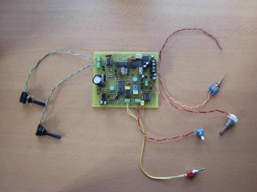

    after read forum , i decide to build an hammerhead PI .
    i've do the PCB today !
    i don't have all spare parts (components) i'll bought them monday, and ... start !
    hello all ! the project progresses !
    the power part is done and tested,it works,
    the timer (NE555) , and the transmit circuity too.
    just missing an 1MOhm pots to continue the remainder of the receiver.
    regard's fromfrance.

        hello all !
        hammerhead project is ready to first try !
        i'll just made coils to can try .
        hoping that it will work.
        the checkpoints along the back are all ok.
          Hi all ,
          my hammerhead seem's working !
          my traces at all TP are good.

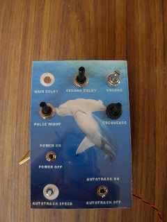

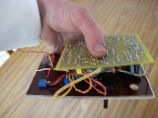

                    some pics ...
                    today i have do the control panel .
