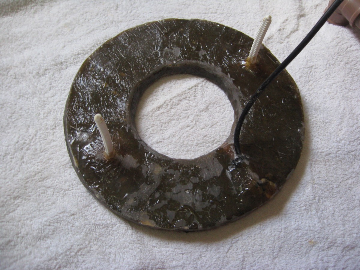

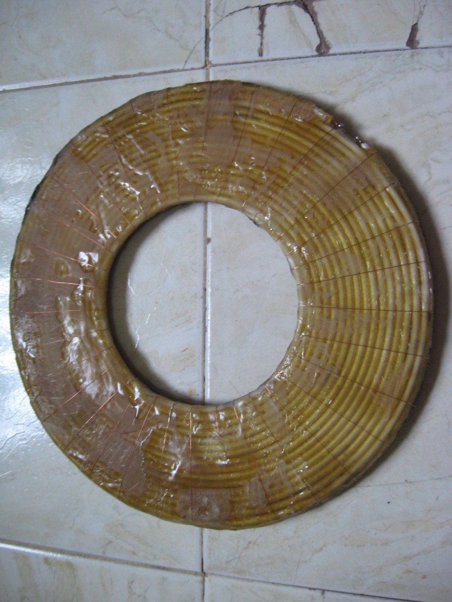

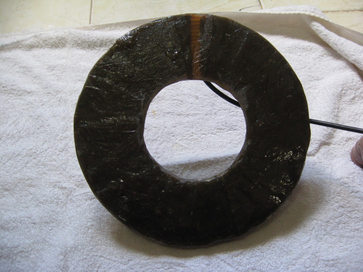

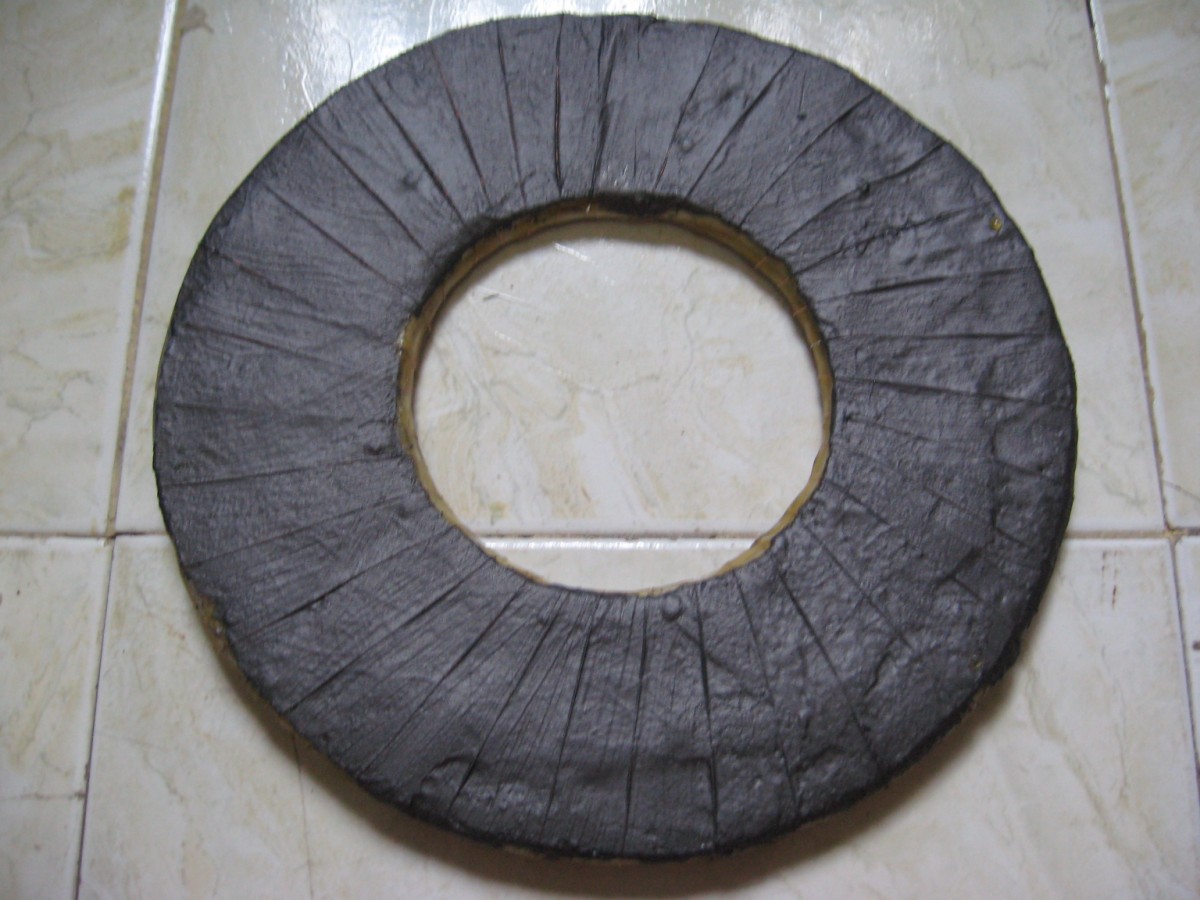

                  Thats terrible isn't it? Here are some pics of the coil if anyone can see what I did wrong.
                  This is the coil before the shielding was applied. Its made from the core of 75 ohm coax cable. It consists of two layers of 16 turns each

                  After shielding and YES I did leave the necessary gap in it!! The shield is made of Graphite glue.
ID:	330182Click image for larger version
                  Completed Coil in fiberglass.
