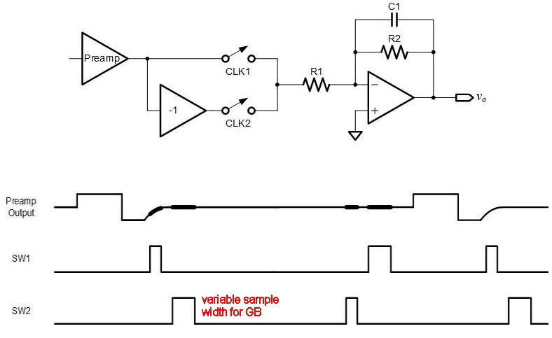

              Hi Carl
              do I understand your GB description correctly , that when you use a single ended integrator
              the first pulse on switch 2 has variable width and that is the GB control ?
              Would you mind suggesting some timings please ?
              • #82
                Yes, that's correct. The exact timing requirements depend on a lot of things, like coil inductance, damping, and preamp compensation, but here is a rough example:
                Target sample: turn on at 15us, turn off at 20us
                Ground sample: turn on at 25us, turn off at 40-50us

                    Hi Carl
                    is this something like what should be happening with sw1 and sw2 ? for the single int
                    you will see the 100uS tx pulse at the top and sw1 and sw2 at bottom
                    the width of the first long pulse on sw2 is being altered with a pot the rest are fixed ?
                    The long pulse is going from 100uS to about ~180us.
                    dont take any notice of the distortion of the bottom of the wave form
                    this is caused by combining the sw1 and sw2 waveforms with diodes and resistor for cro.
                    The camera is not square onto the cro screen.
                    https://www.youtube.com/watch?v=NvmH...ature=youtu.be
                    • #85
                      This seem to be correct, provided EF pulse duration is balancing the previous pulses. This variation is easier to implement in a micro than my analogue solution with initial delay variation.
                      • #86
                        Thanks Davor
                        • #87
                          I assume the sequence is SW1-SW2-SW2-SW1. As Davor said, the 2nd SW1 width needs to track the first SW2 width. Also, I would move the EF samples as far away from the main samples as possible, to minimize depth loss.
                          • #88
                            Thanks Carl
                            yes the sequence is sw1-sw2-sw2-sw1, and I now have second sw1 tracking the first sw2 WIDTH, and moved the EF pulses out further.
                            The video shows the two long pulses tracking in width. Does this look a bit better.
                            https://youtu.be/J8MGv5RZg6U
                            • #89
                              Yep, that's it.

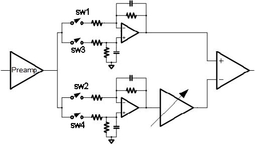

                              • #90
                                Hi Carl
                                another question please, with your 4 sample duel integrator GB circuit (attached) does it matter if the variable gain amplifier after the integrator is inverting or non inverting ? thanks.
