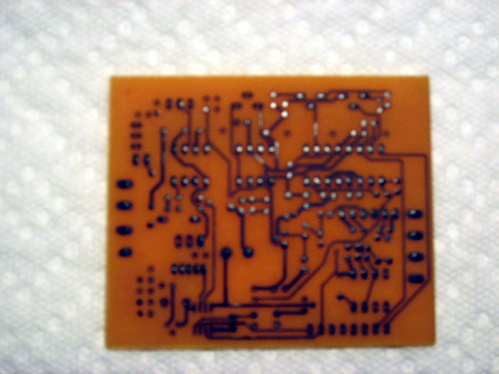

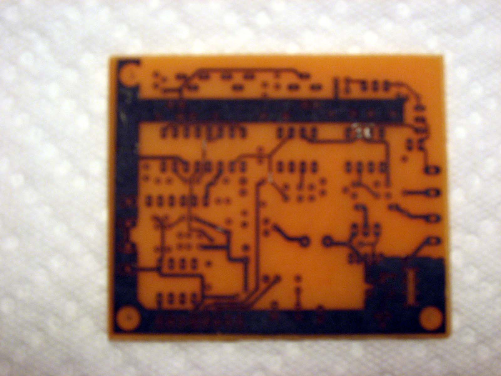

                          Laser Print Transfer
                          Well, I finally got the laser transfer to a baord that I believe is ready for the etchant. The pictures aren't the best quality, but that is what I have. Tomorrow afternoon (actually I believe it will be this afternoon, as it is currently 1:20 AM) I will try to etch the board.

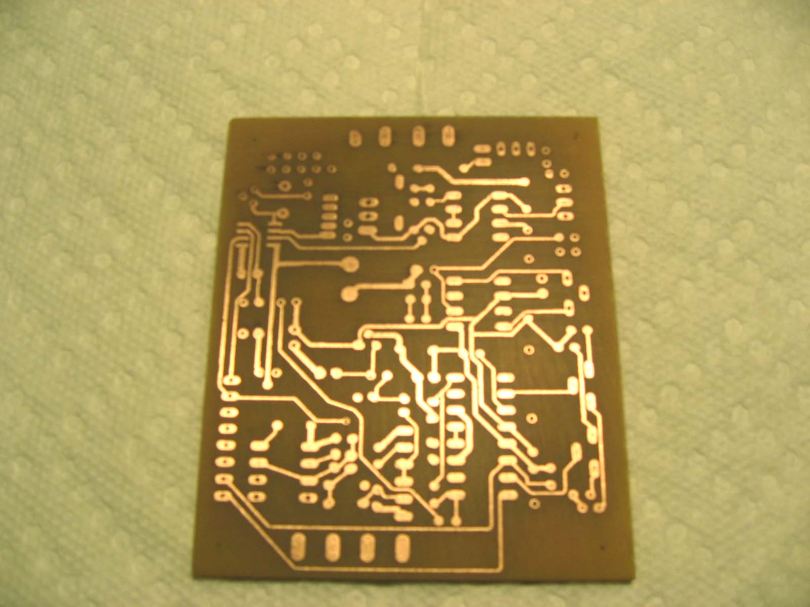

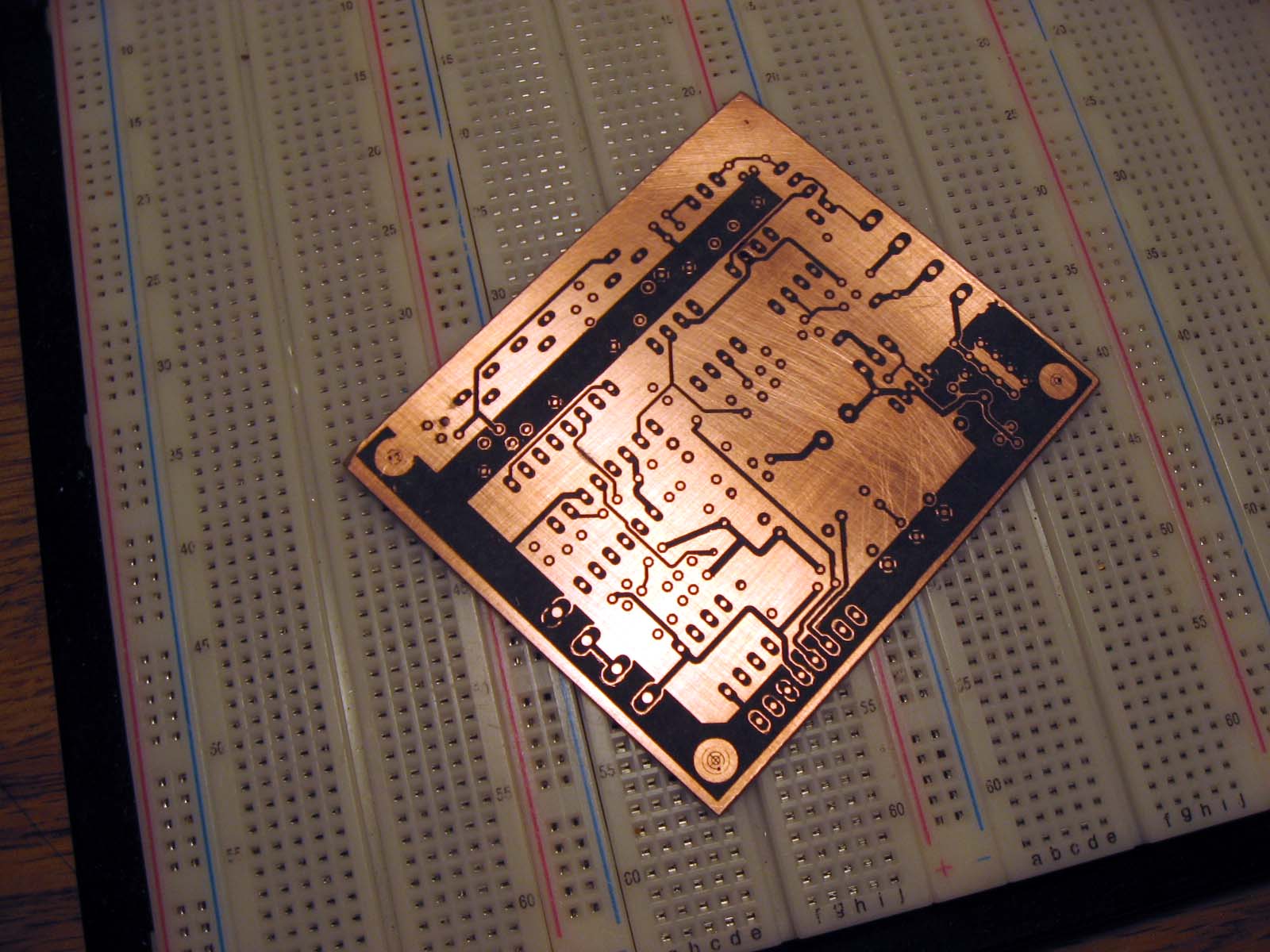

                            Boards etched
                            Etched the boards this afternoon. Everything appears to point to success. Leaning the boards next! Sorry for the fuzzy iages!

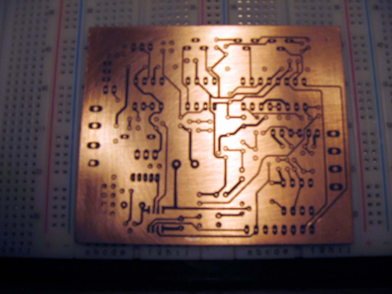

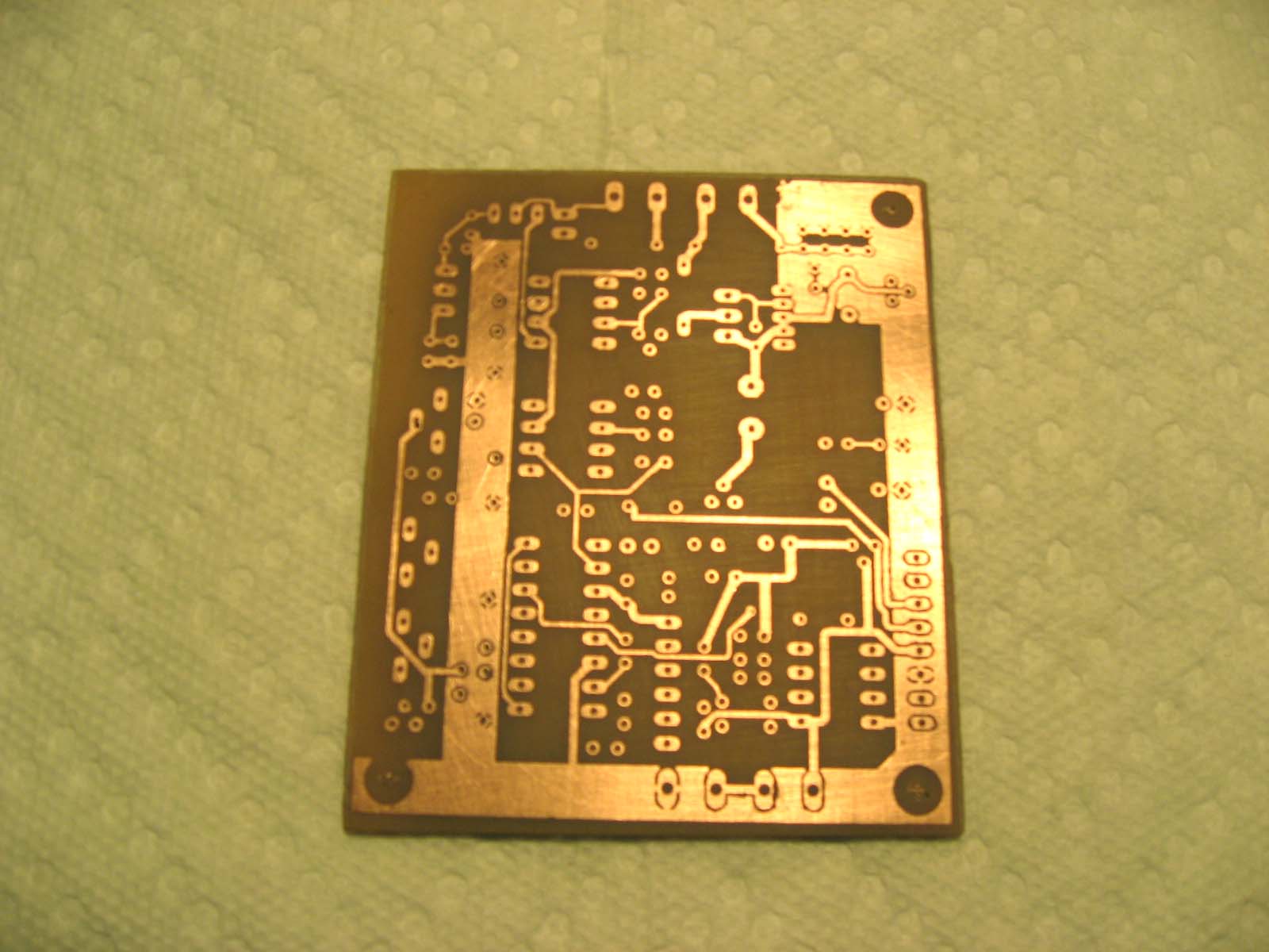

                              Cleaned board
                              Here is the cleaned board. Initial checkout of signal paths indicate everything OK. Next step is to populate the board. I will be doing this in stages and test everything before moving to the next stage. The first stage will be the -5V regulator circuit followed by the 555 driven inverter circuit and +5V regulator.
