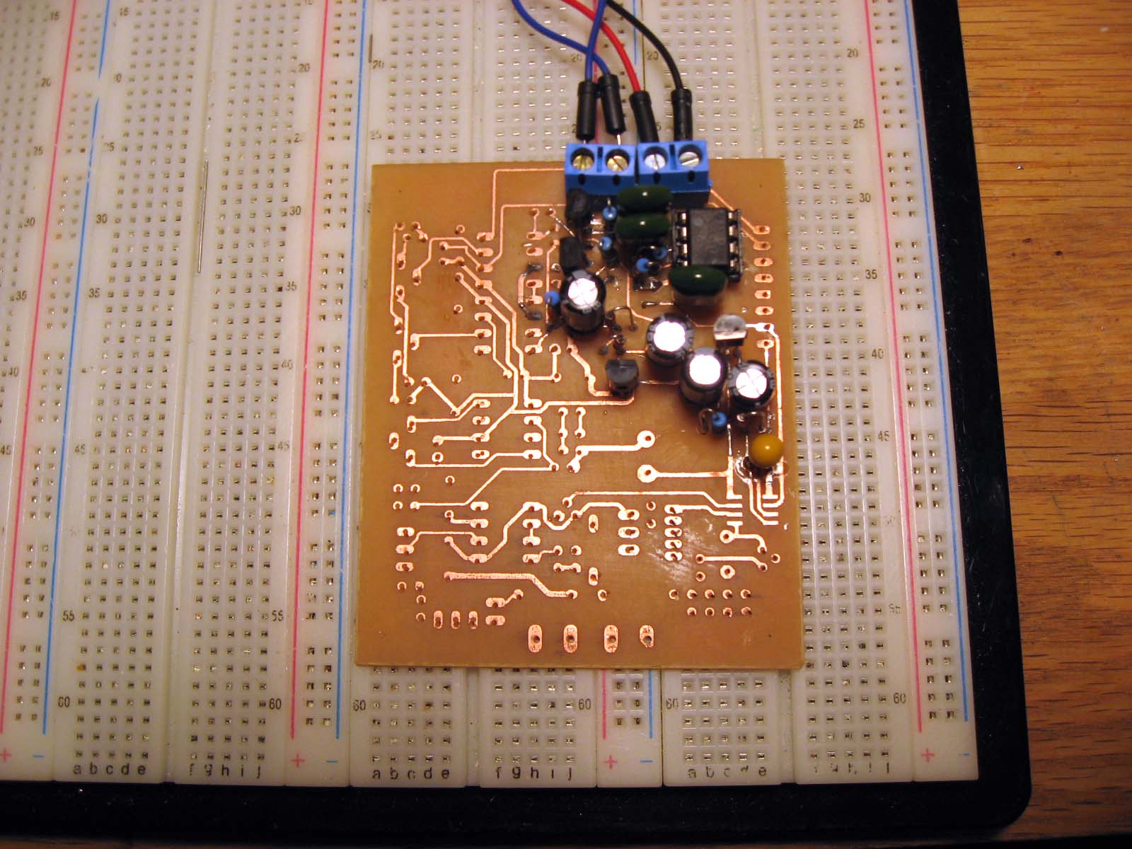

        PS complete
        Finished installing components for the power supply (-5, +5, +3.3). Tesing revealed some needed changes. As a load was placed on the +5V, the voltage dropped off severely. A little trouble shooting shoed that the board layout for the PNP transistor was wrong hence it was installed backwards. Reversed the mounting of the PNP and everything much better. While I was at it I stress tested the +5V. At about 60 ma the 5V would drop slightly. Change some component values to insure that supply current would be more than adequate. Changed the resistor between the 555 output and drive transistor base input capacitors to a 68 ohm. Change the PNP to a BC327-25; changed the NPN to a 2N4401. Now we have an inverter capable of driving to 100ma!!

          PS PIC
          Picture of the board with PS installed.

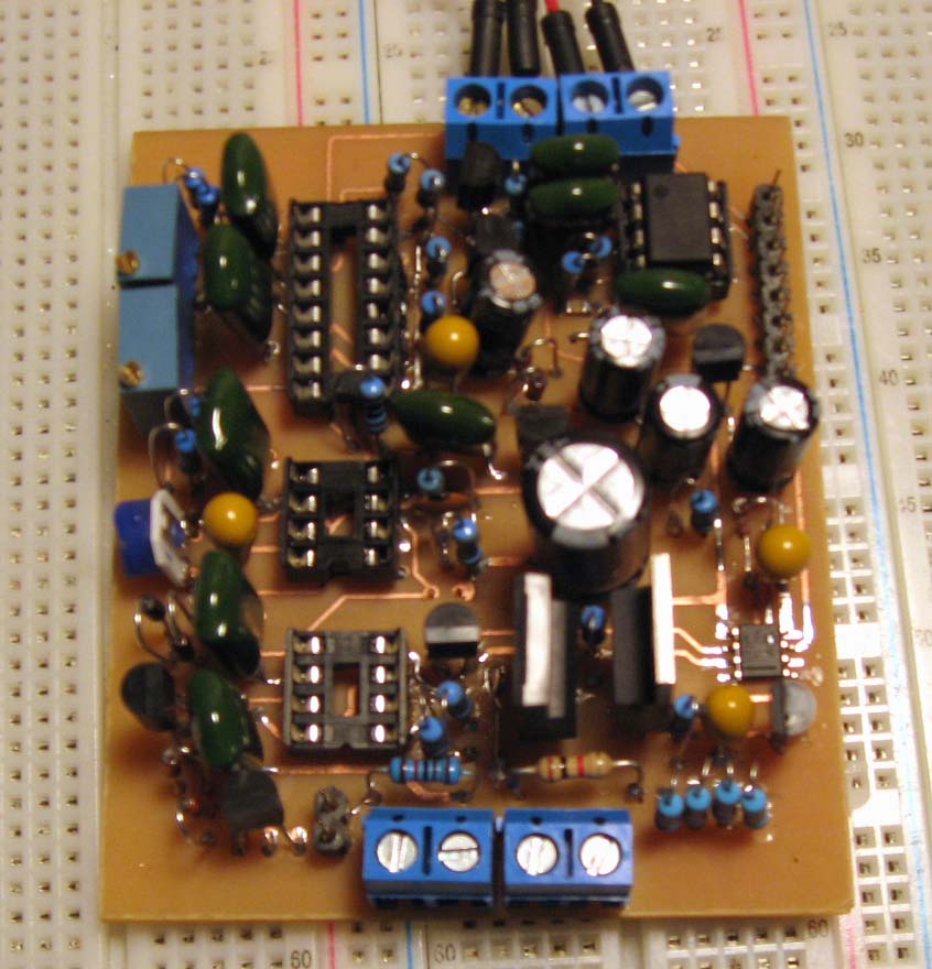

                              Populated Board
                              Well, all components are mounted on the board. I painstakingly checked continuity between all components as I progressed. As all of you who have done this know, two sided boards without plated thru-holes make it especially important to insure electrical connection on both top and bottom of component mounting holes.
                              Now on to testing everything!
                                Well, fired up the beast! At first, no voltages except for 12V. Lost a ground somewhere! Found the lost ground; topside connection of U302 pin6. Repaired that and now we have all voltages present. Measured quiesent voltages for all TX components. The output of the ISO7220M looks questionable.
                                Apply ground to the two input pins that go to the ISO7220M. Everything in the TX looks acceptable. Now to hook up the uPC and check out TX. Signal looks great. The ISO7220M does a great job of shifting the level to work with the negative voltage TX.
                                Now to check out RX blocking circuit. The inut to the TPS2814 pins 2&3 appears to be wrong! The signal is a neagtive going signal (OK so far) going from -1.2V to -12V (should be 5V to -12v). Also notice that the 2N3904 is stretching the PW of the blocking signal by ~2.5usec. I find that the Eagle libraries package for the 2N3904 have the pins reversed. I fix the package and also change the transistor to a 2N5088. Now the blocking signal to the TPS2814 goes from 5V to -12V. Outputs to from the TPS2814 to the MOSFET gates are correct. The 2N5088 only stretches the signal by .5 usec. The 3904 is too slow for use in a high speed switch circuit.
                                Something in the blocking circuit is not functioning properly as I have a +5V with negative going (-12V) signal at the drain of Q301. Well, I have the orientation of BOTH MOSFETS in the RX blocking circuit reversed. Reverse the 2 MOSFETS and retest. RX blocking appears to be now working. I believe I have to find another P-channel MOSFET for the RX block. There appears to be too much capacitive coupling of the gate signal to the output. I get about a 100mv leading and trailing edge spike. I will research this to see if there is a better component for this.
                                The timing circuitry for both the TX and RX seem to be working as intended (except for the feedthru of th RX block gate signal). This checks out the digital section and the uPC interface.
                                Next is to check the analog portion (RX front-end).
                                Attached is the updated eagle files and the board layout bmp files that include all corrections to date.
