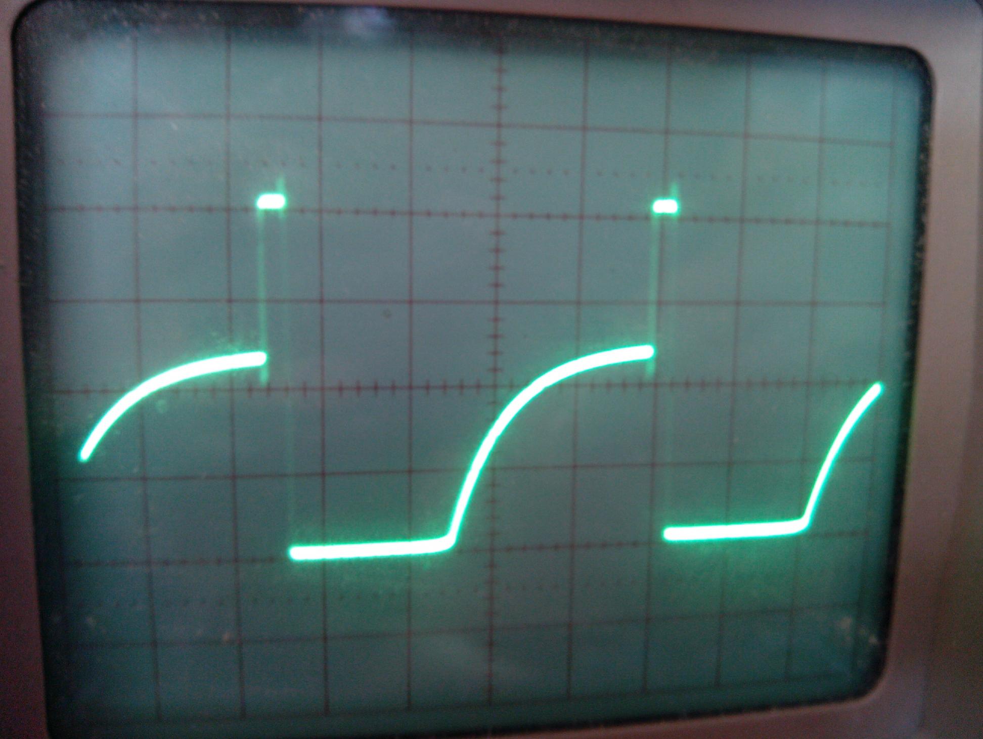

                  • I tried using an oscilloscope. But I could not get a dancing decay like in 6666's video. The curve "shrinks" when a metal object is brought close. Does the attached image look ok ?
                    • Originally posted by greylourie View Post
                      Is your scope timebase set to 250us, and the channel volts/div set to 2V?
                      If so, the amplitude, shape and frequency of the TX part of the pulse looks ok, but the decay curve doesn't start until about 425us. What are the details of your coil?
                        I would bet that it is not a mono... probably a high inductance dual coil like a dd (which would explain his rising voltage at tp3 with a ferrous target) that was designed for a vlf.
                        • The coil is 24 turns of 0.5/0.6mm wire. I used some cat5 cable. Had to strip it to remove the mylar /7 strand wire shield, and then reapplied the pvc outer. Made three laps of roughly 20cm diameter, and soldered up and heat shrinked the 7 joints. Getting a very low reading of 0.6 ohm. Checking with online calculators for copper/aluminium, my reading is way off what it should be. I will try to redo the soldering/splicing and see if that makes any improvement.
                          Oscilloscope settings for the image in post 249 were 0.2mS/Div and 0.2V/Div. Well worn probe with dodgy switch set to x10.
                            I was close with the scope settings.
                            With 24 turns of 0.6mm wire on a 100mm radius, the inductance should be 325uH. But it certainly looks like your coil is the culprit.
                            I assume you don't have an inductance meter?

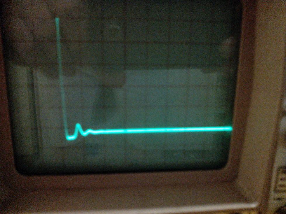

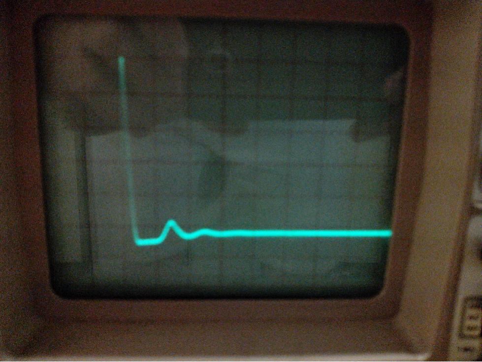

                              • Thanks for the replies. The coil leads are approximately 34" long. And the conductor/insulation is very similar to the kind found in phone cable. Unfortunately I have not yet got round to making/buying an Inductance meter. Have re-soldered the "joints", in the coil. Now reads between 1.2 - 1.3 ohms. But have not re-taped up the "weave", so whatever the inductance is - will change when I get round to doing that. With connection of scope on TP3, the image is identical to the one I posted earlier - although there is more deflection when my mini side-cutters are presented.
                                With scope connected across R1, and after twiddling knobs I have the following images. I had to turn the intensity right up on the scope in order to capture the vertical bit displayed in the pictures.
