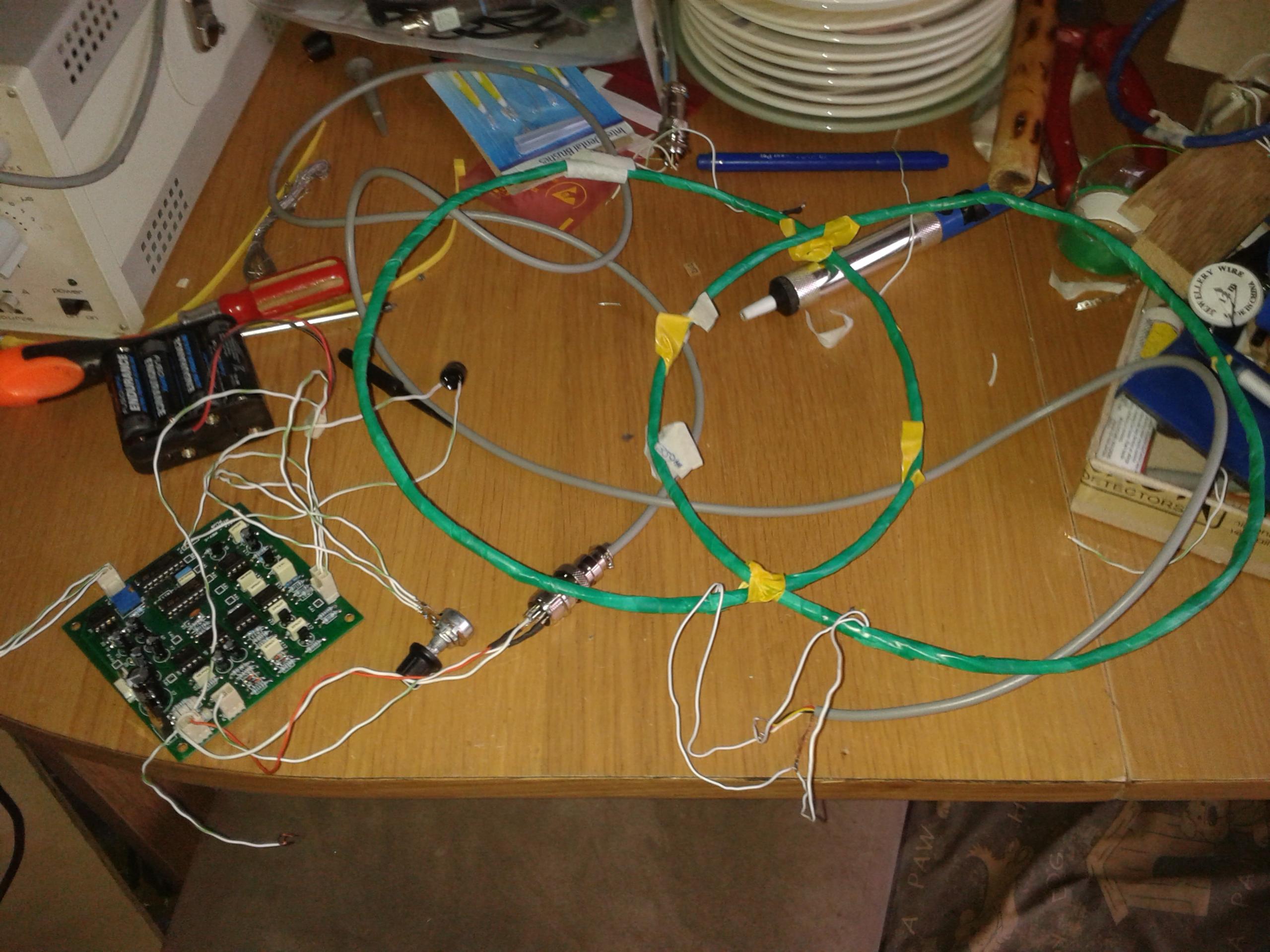

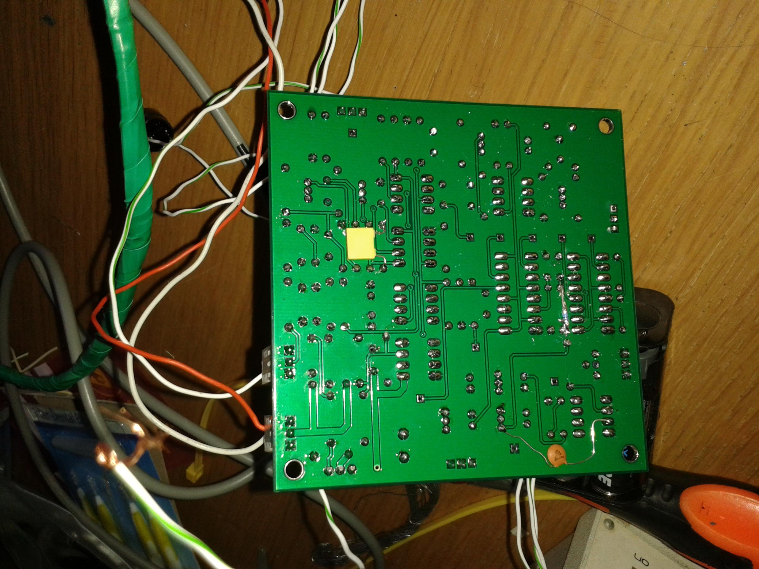

                      • I completed my minipulse plus a few days ago, although i have an old oscilloscope i couldnt get it to show the correct waveforms ( very old oscilloscope, new one on its way).
                        I followed the instructions and then read the post about Q2 and the resistors, but it all worked although needs tweeking, i did the capacitor mod in this thread straight away.
                        It worked straight away with my coil from my baracuda build. I also tried it with a rx coil of 360mh and a tx coil of 300mh and it worked perfectly.
                        If anybody is thinking of building one i would say go for it as it was a relatively easy build with nice instructions and the boards from Andy are just fantastic.
