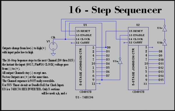

                • Hi Davor thanks
                  I'm interested in this GB system again for a number of reasons, one is to see what pulse width comes out of the 4017.
                  if you are planning to add another counter is this attachment any help ?
                  cheers.
                  • In a way that is the basic idea of adding another counter. You can't use D0 on a second counter because it is the same as D9 on a first one (or D8 in your attachment). Once I sort out some hiccups at work I'll see to the GB circuit.
                    There are other ways to realise this circuit, but I prefer 4017 as it enables combining various timings in wired OR style.

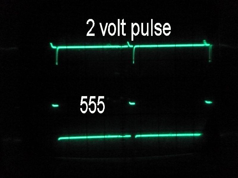

                    • Hi Davor
                      For my own interest, I made the first part of your GB circuit, just to see if I could get the reset pulse to work.
                      I made the complete 555 circuit on breadboard and getting a nice 58uS pulse and fed that pulse via a 10K into the pulse shaping net work c2, r3,r6, D1,
                      and I'm using pins 1,2,3 on both a 4093 and 4011, I can get a nice looking 2 volt pulse on pins 1and 2 but nothing out on pin 3
                      on either the 4093 or 4011.
                      I have 12 volts on the 555 and 5 volts on the 4093/4011 just like the MPP, but I'm puzzled why no
                      output pulse on either 4093 or 4011, as its such a simple circuit.
                      Here are what the pulses look like, with positive battery as ground as per MPP.
                      I did test the 4093, and can make an easy astable with pins 1,2,3.

                              I tested the circuit in a configuration at a post #403 at this very topic, and everything worked as it should. My 12YO son did the 555 part. Silver Dollar made amendment to a MPP schematic at #501. The 4011 obviously works.
                              I'll see to including the other 4017 soon.

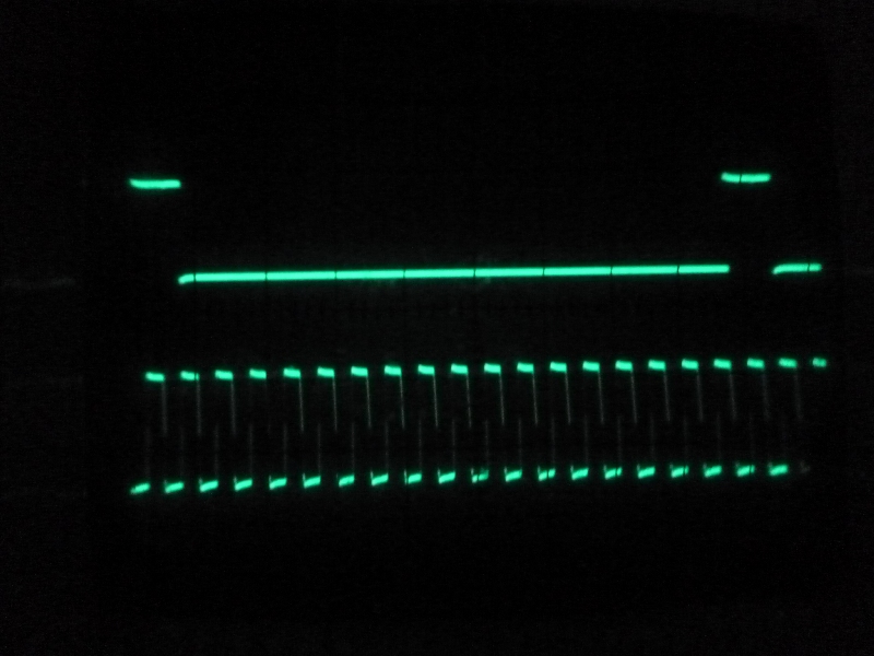

                              • I'm starting to think that this circuit does not like my bread board and probably needs to be hard wired with solid solder joints on vero board .
                                The oscillator works, its hard wired to run continuously and triggered on the cro from the pin 3 555 tx pulse , there is some issue with the 4017
                                and needs more work.
