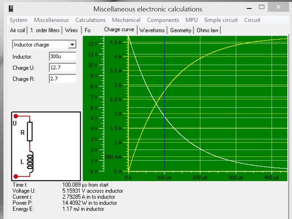

          For calculating the peak amps, you also need the TX ON time. See graph attached.
          You can also measure the actual coil current by inserting a 50 to 100 mOhm resistor in series with the coil and measure the voltage drop across it.

                The 16 small pulses might be a method of generating a linear TX current ramp. The 120us final ON time would then end with a fairly steady peak current. This way the eddy current of shorter targets would be decayed at the end of the TX ON time.
                My guess is the peak TX current would then be about 3A. I forgot to ask you for the coil inductance, therefore I surmised 300uH for the calculation.

                  The coil inductance is 335 uh with with the round coil.
