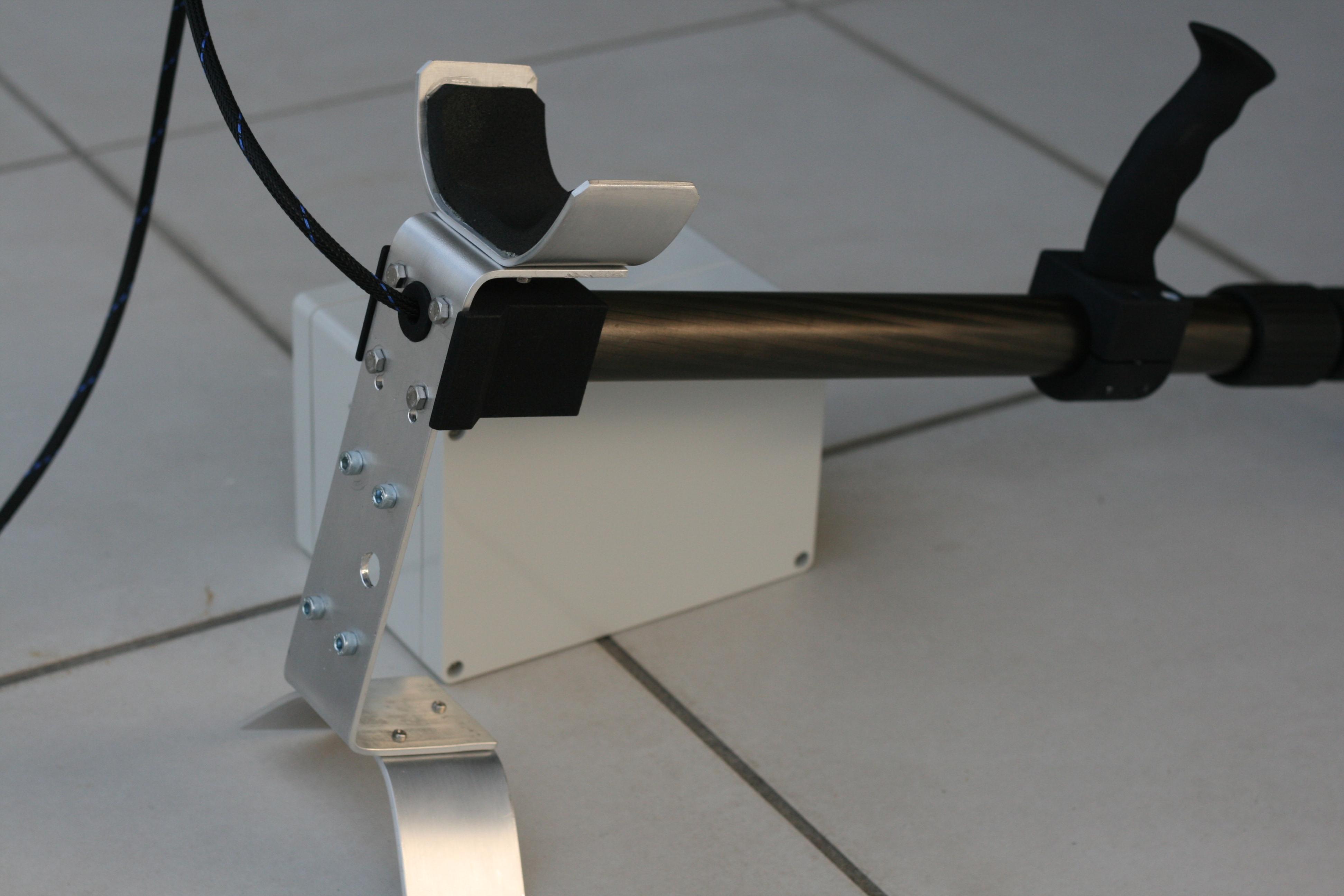

      • OK another question - this time about the pole setup for my MPP - metal or non-metal lower rod (the rod that attaches to the search head)? I've noticed a lot of the cheaper VLF units (that would be cheap donors of rod parts) have a lower rod of aluminum with just a small plastic mount at the bottom that attaches to the search head. To me this seems like it would be a bad thing & that we would want a non-metal lower rod - anyone have thoughts & especially have experience with metal and with non-metal lower rods for the MPP PI detector?
        • Originally posted by KRinAZ View Post
          I'm using a carbon monopod (used for photo camera) which works well. It's strong and the lower shaft is carbon which is ok for metal detecting. Brand name is Benro.

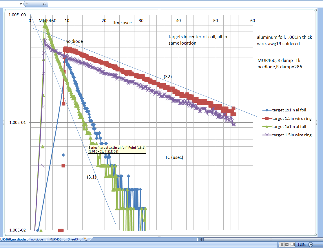

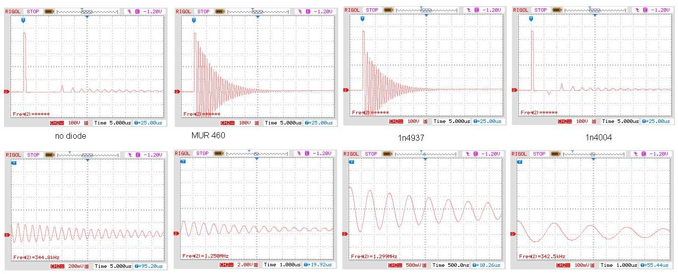

                Something I posted awhile back. The fast diodes isolate the fet capacitance and increase the circuit resonance allowing a higher Rd. The scope pictures are across the coil with no Rd or input resistor. I find Rd=circuit resonance x inductance x pi is close. Don't know if the two examples used the same coil but a 4 times increase in resonance should allow a 4 times in Rd. The diode helps to sample sooner but with all else the same you loose a little signal due to voltage drop across the diode when charging the coil. Use caution, the high voltage can damage the scope when measuring across the coil.

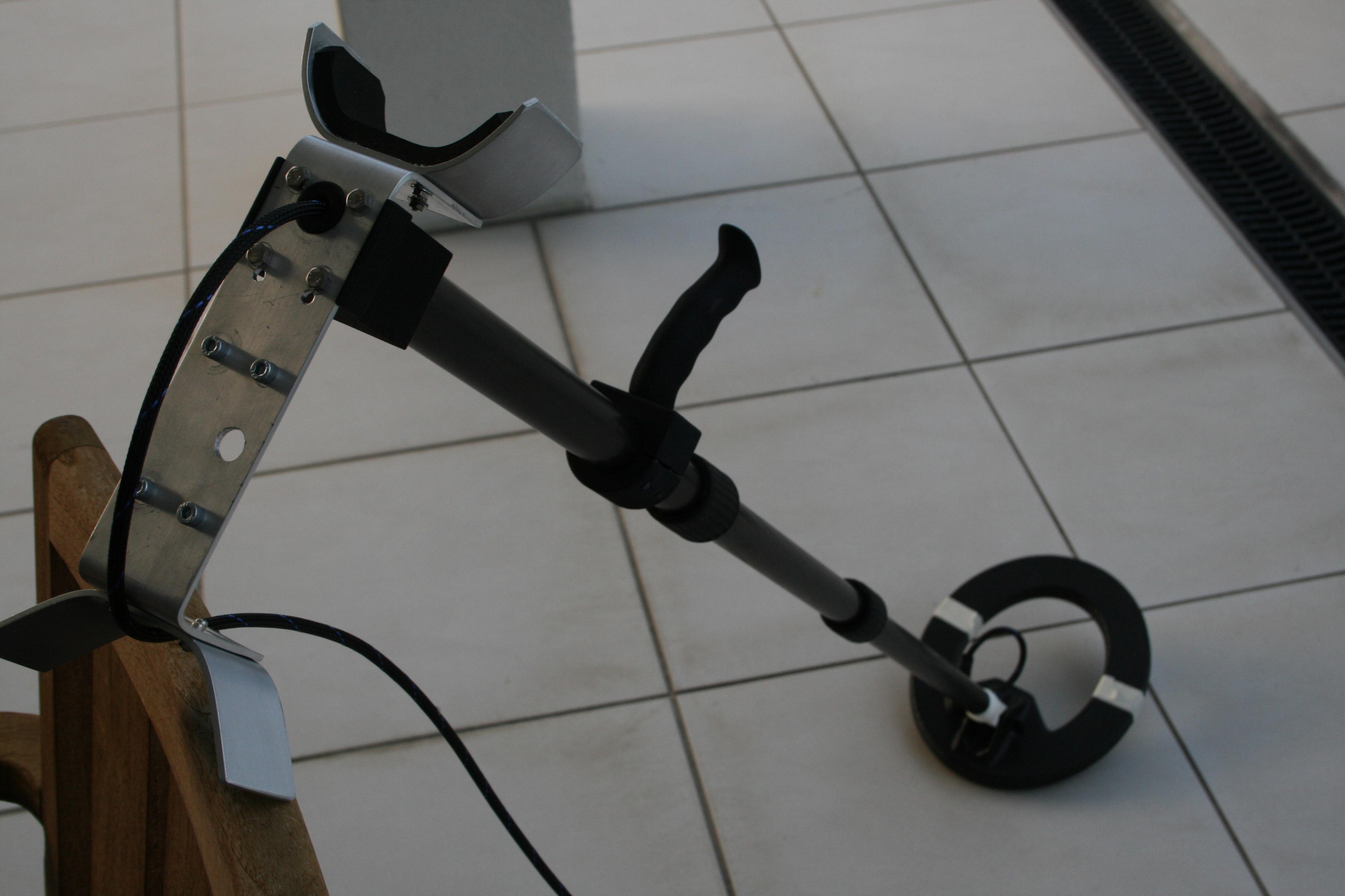

                • Originally posted by Achillion View Post
                  Interesting, thx for the idea - how do you hold it to swing it - any pics?
                    thx green, I think I read your post on this last year. What you say about the effect of the function of the diode makes sense & I'm perplexed on why adding the diodes I tried had no effect in my circuit. I did just get my hands on a MUR460 though so I'll try it soon, maybe the diodes I tried were no good for this circuit...

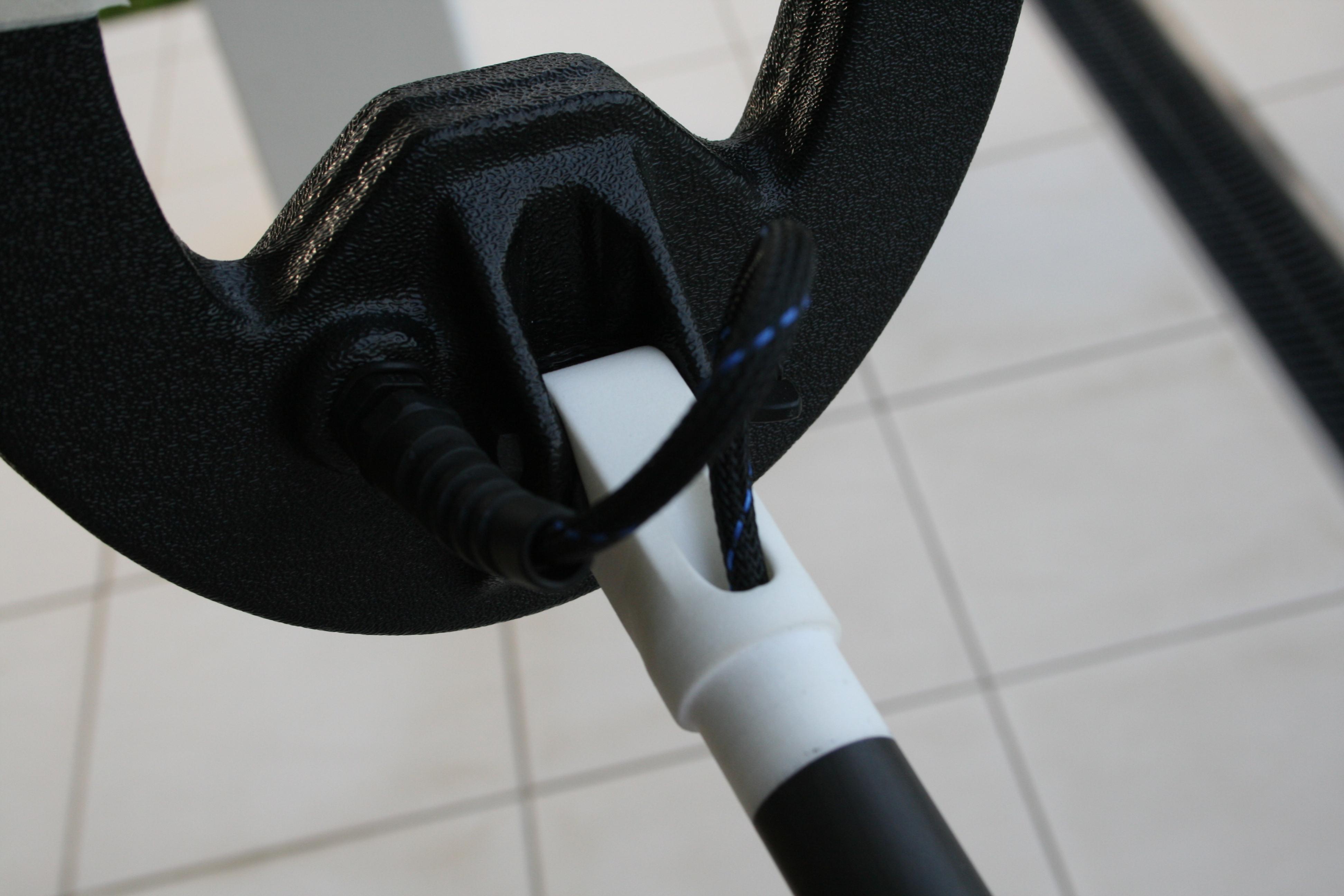

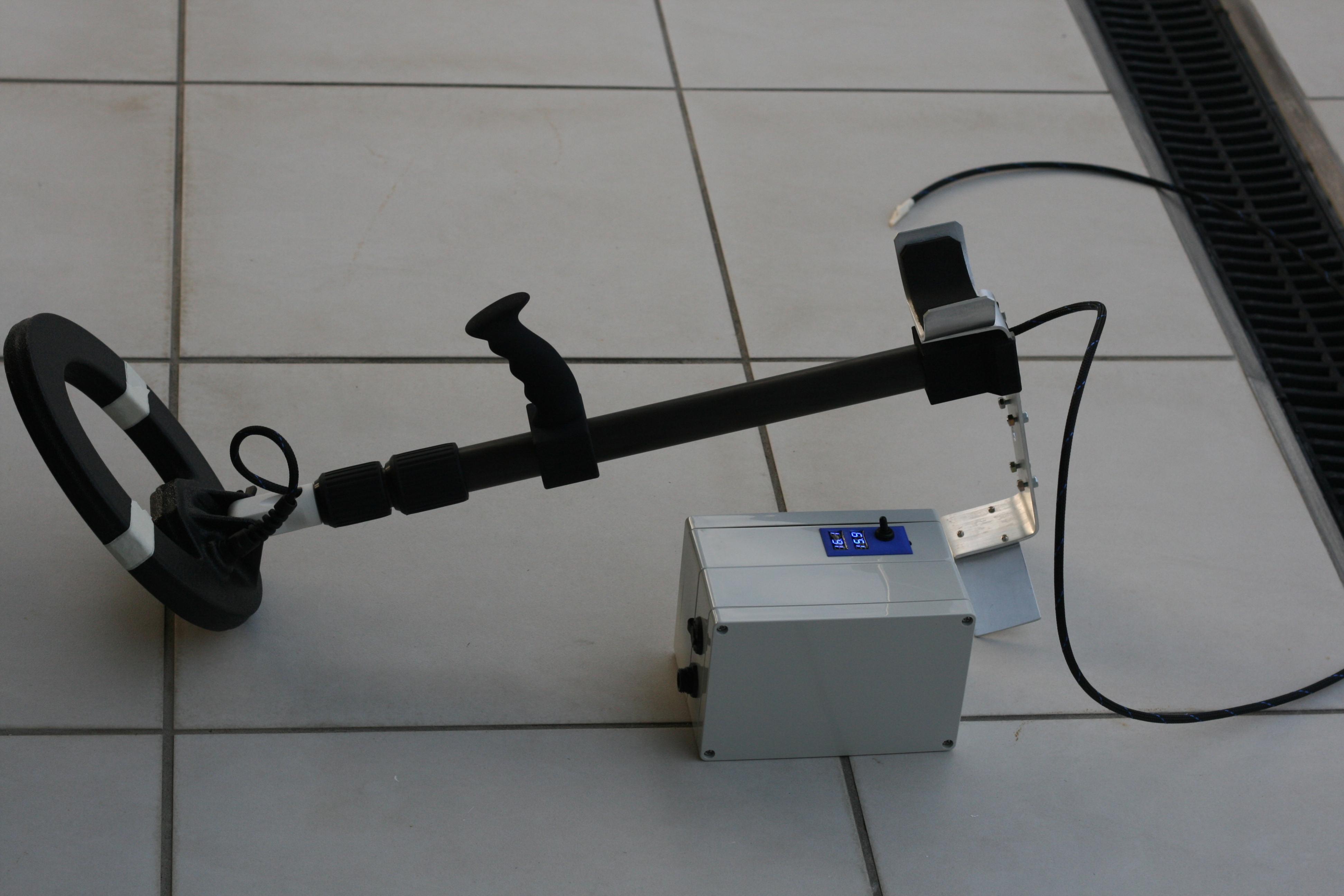

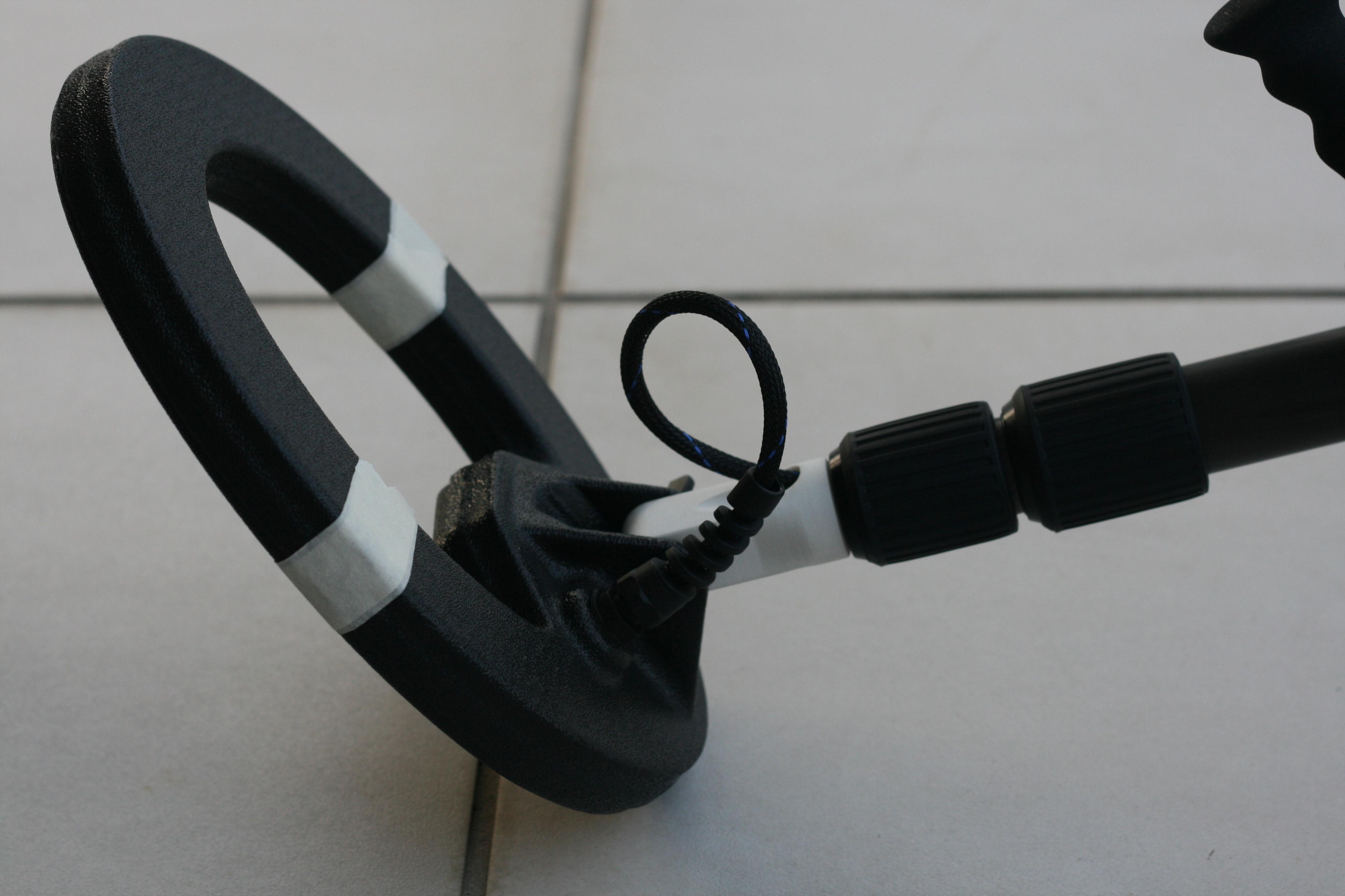

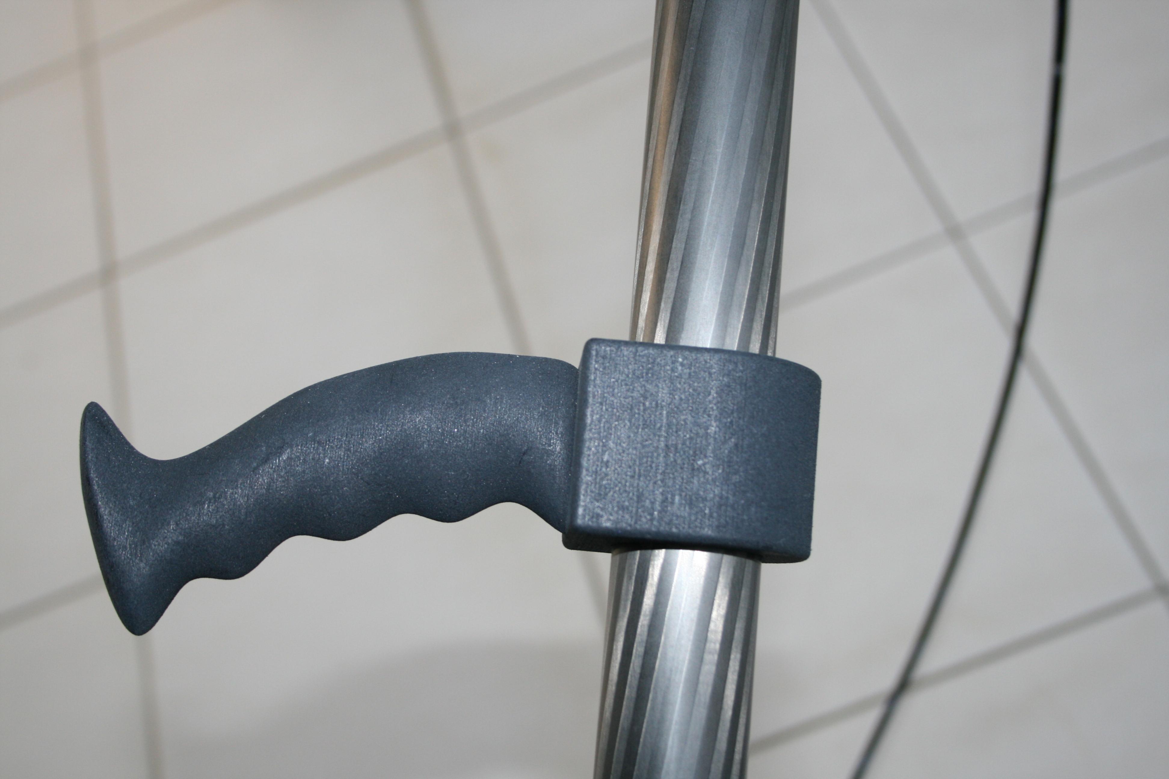

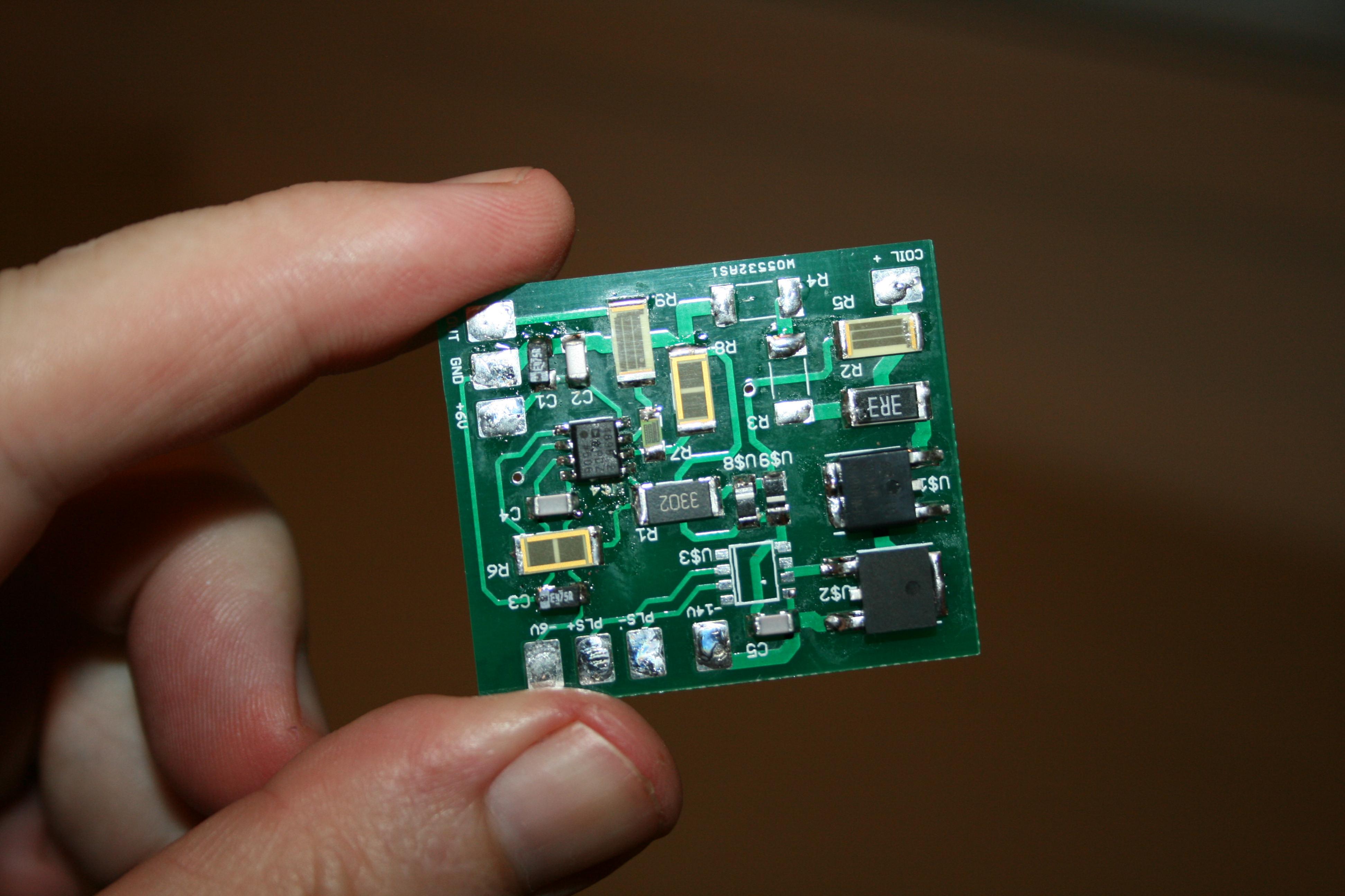

                      Here are some pictures. Control box is not attached yet. Work in progress. The PCB is the MPP front end. I will built this in the coil housing. The plastic handle and connecting parts are developed with Autocad and 3d printed. Never used ACad before but the advantage of a project like this you obtain a few skills along the track. The PCBs are made in China and cost little more than an apple and an egg. Next challenge is to learn programming the MBED. Cheers, JCobb
                        [ATTACH]33170[/ATTACH][ATTACH]33171[/ATTACH][ATTACH]33172[/ATTACH][ATTACH]33173[/ATTACH][ATTACH]33174[/ATTACH][ATTACH]33175[/ATTACH][ATTACH]33176[/ATTACH]
                        Hmmm, nice job & thx for the pics, think I'll watch for a good deal on a monopod...

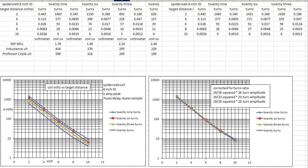

                              Something for thought. A chart I posted in another thread awhile back. I kept the peak coil current constant for the test. Adding turns and increasing inductance might lower peak current and reduce the gain increase by the current ratio. With the same peak current the signal increased with the turns ratio squared. Signal strength should equal ampere turns. With a mono coil turns helps transmit and receive(squared). Gain in distance vs signal strength varies with coil size and shape. The chart shows what I got with my 8 inch round mono coil.
                              • I would not add windings but instead push the sampling delay toward 6 or 7us instead. There is little to be gained I believe in slowing down your coil further. You have plenty of inductance at 324uh. One question is, have you armored your coil yet? If not, it will probably have the effect of slowing down your coil anyway.
