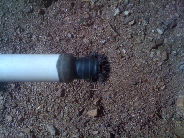

                  Hi KR
                  more interesting results, do you have access to a whites V3I, would be interested in a ground probe reading on your highly iron mineralized ground
                  and what happens when you throw a Neodymium magnet on the ground does the surface material clump around the magnet ?
                    Hi KR

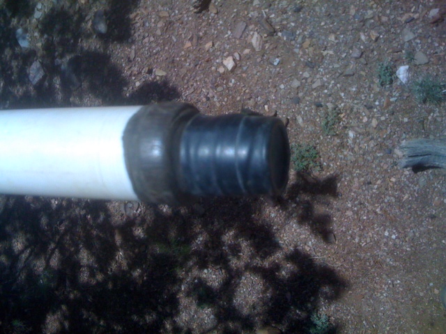

                    No access to a V3I but a GMT shows 82 (mild for this area) to 99 & Overload message at times & a pic says a thousand words - my plunger neodymium magnet is covered with black sand & magnetite after going over about 8 inches (20cm) while held about 1/2 inch (1.25cm) above the ground. This 1st pic is the tool clean, the second with the black fuzz...
