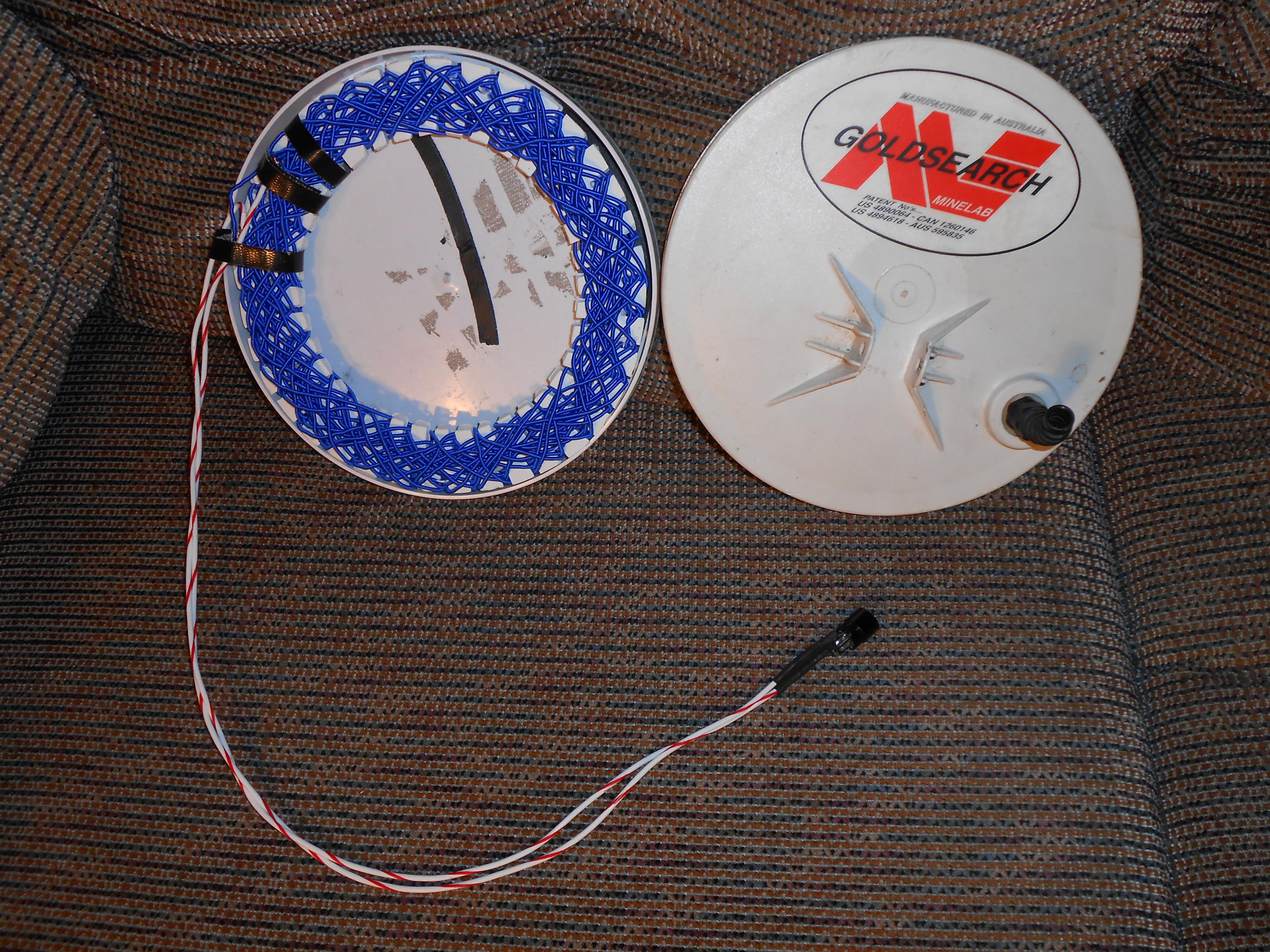

              Hi KRinAZ, Attached is a photo of my coil. It is in an old 8” coil housing that a friend gave me. The coil form was box knifed out of foam filled art board which was lying around. It wasn't strong enough for the wire used so the windings have some BO-BOs from broken or bent sections. Even with the mistakes the principal goal was maintained by having good crossover of the wires (no parallel wires that would cause more coil capacitance). It is wound with 18 gauge Litz wire which was also available in one of my boxes of stuff.
              Qiaozhi has a coil calculator at the top of the Coil Forum. Because of the zig zag pattern this coil will require some additional wire and turns to achieve the required inductance. It is easier to remove extra turns than to add if the inductance is wrong.
              Air is the best dielectric for a fast coil. Sections of foam filer (tubes) used in the Chance PI Postings is a good way to stabilize the windings from bumps against rocks and bushes. Avoid using very much solid material such as epoxy or goop directly within or against the windings.
              The coil works well on the bench. It will be tested outside after through experimenting and devising some kind of Ground Balance circuit. Click on the photo to expand or shrink.
                    Looks good Chet, boy I'd be happy acquiring some of those shells! Thx for those tips - I will heed them. So...I just emailed Don at DBCoilShells with the coil specs (will be 8"OD, appx 1" wide, appx 1/4" thick) to see if he has/can build shells...
