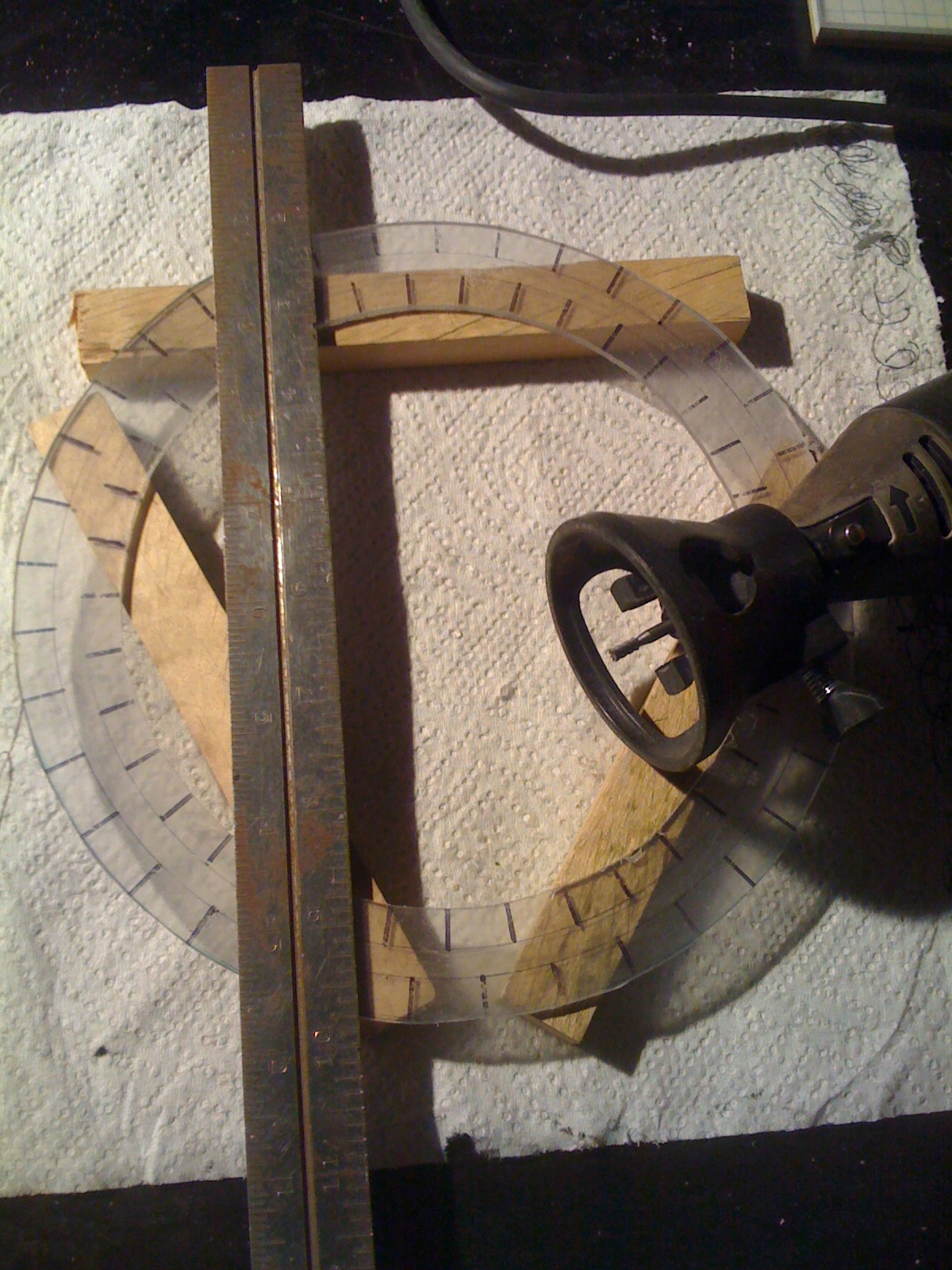

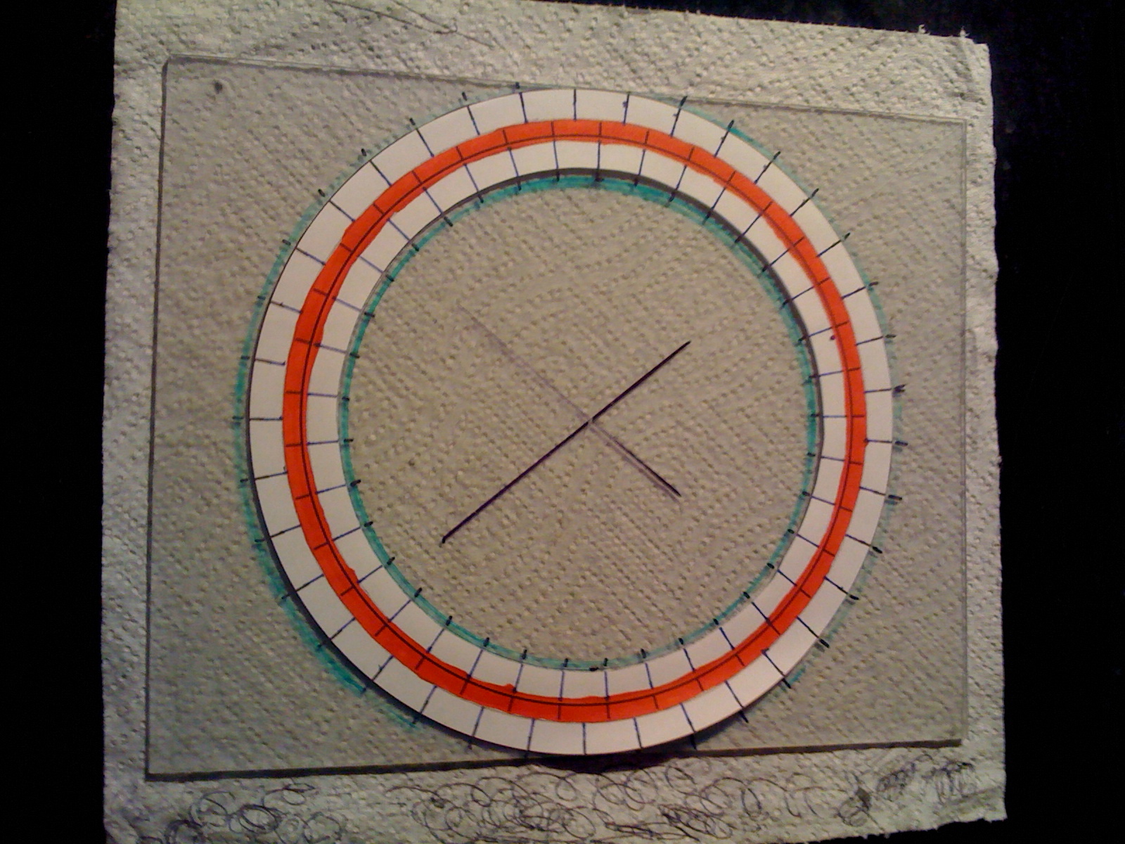

      I started building the basket weave coil - got the form made today - just cut this one by hand so it's far from a nice clean jig produced one but should work. This was a tedious task to complete - so I will continue soon and begin figuring out how to wire it up. For this search coil I'm going to use 26AWG Teflon coated 600V wire and see how it does on capacitance & speed, next one I make may get Litz wire...
      Some photos:
Name:	Coil Form Template.jpg
      Coil form template being transferred to Lexan
Name:	Coil Form Ready To Cut.jpg
      Ready to start cutting

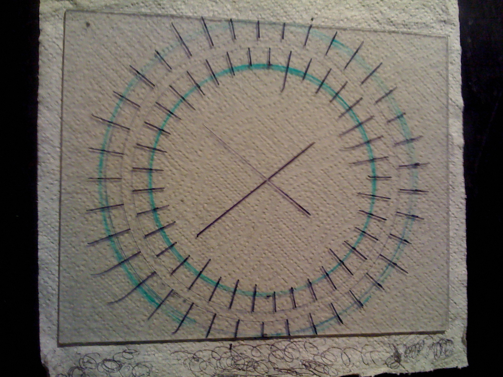

Name:	Coil form Tools.jpg
      Tools used to cut wire slots - I used a jig saw to cut the inner and outer circles, cleaned them up with sharp fine tooth files, that's a 1/8" bit on the Dremel

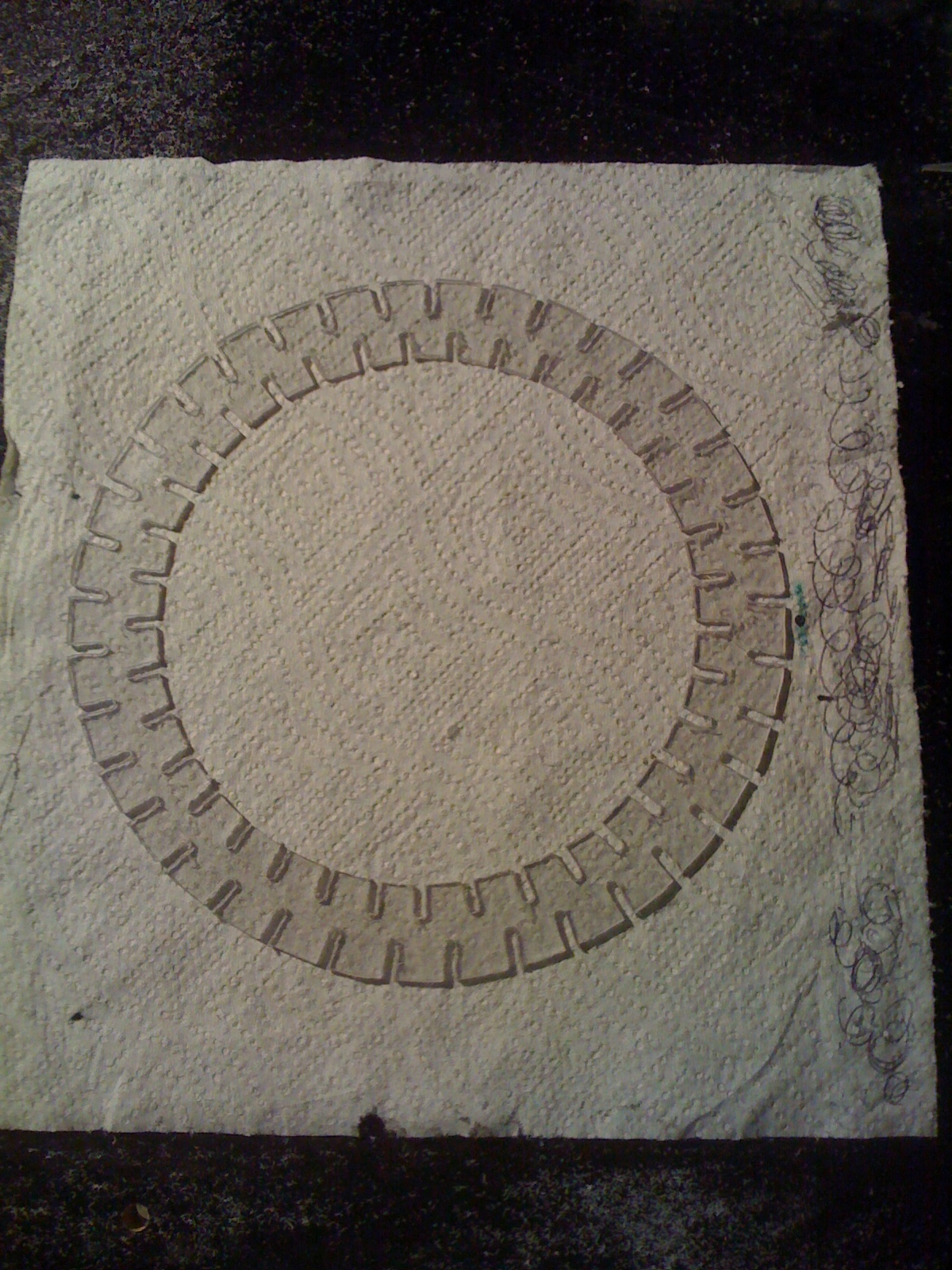

      Coil form is ready to get wired up

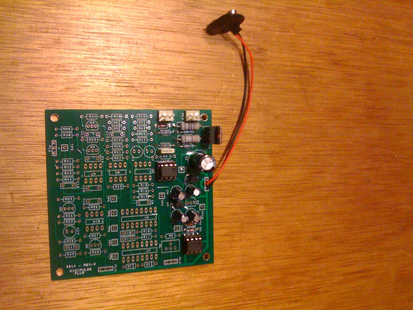

Name:	MPP Build Step 4 Done.jpg
      Steps 1-4 components installed, waiting on coil to finish this step. Interesting to note - the power supplies and transmit circuits installed - obviously most of the board is the received signal processing circuitry

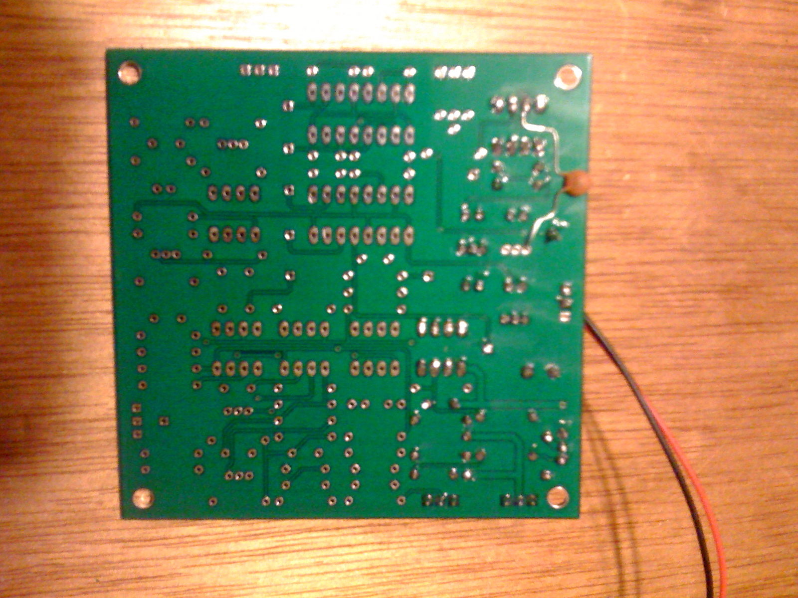

Name:	MPP Build Cxx Placement.jpg
      How I routed/placed the Cxx capacitor (part of Step 3)

        Hi KRinAZ, nice job. How did you build your template so accurate?
          I used some Lits on a quick and dirty coil here; http://www.geotech1.com/forums/showt...over-Litz-Coil
          Preliminary testsing shows a faster response than other wires maybe it's just the case that it cannot see itself?
            Hi Chet, thx!, the template is a printout of the coil form PDF - Coils/Chance PI Coil.../post#7/Plantilla Coil.PDF - I played with printing at different enlargements in my printer settings until the outer was exactly 8", then;
            1) x'd the exact center
            2) Used a compass with pencil to draw my inner diameter of 5 7/8"
            3)Re-drew over 2 of the outer and 2 of the inner existing wire cutout lines as .375" long - opposite sides of each other - to establish where the rings of the insides of the wire cutouts are
            4)Re-drew each wire cutout line from the template edge (inside or outside as appropriate) to the ring that is .375" in from it.
            This made it easy to make all the wire cutout lines in the right place and the right length.
            If desired I can make another template and photo each of the steps.
              Hi KRinAZ, using the printer---neat trick. The rest of the steps are very clear.

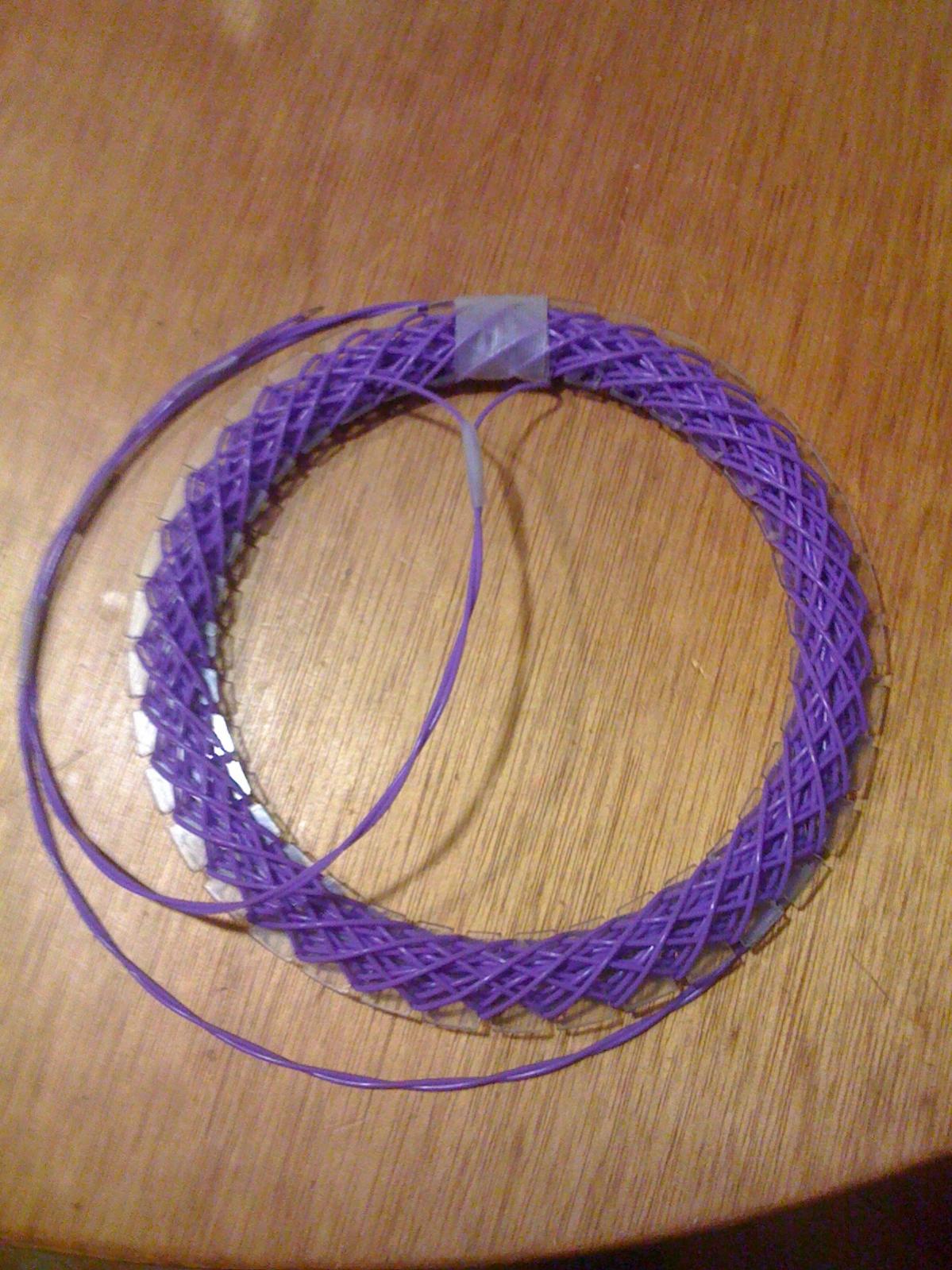

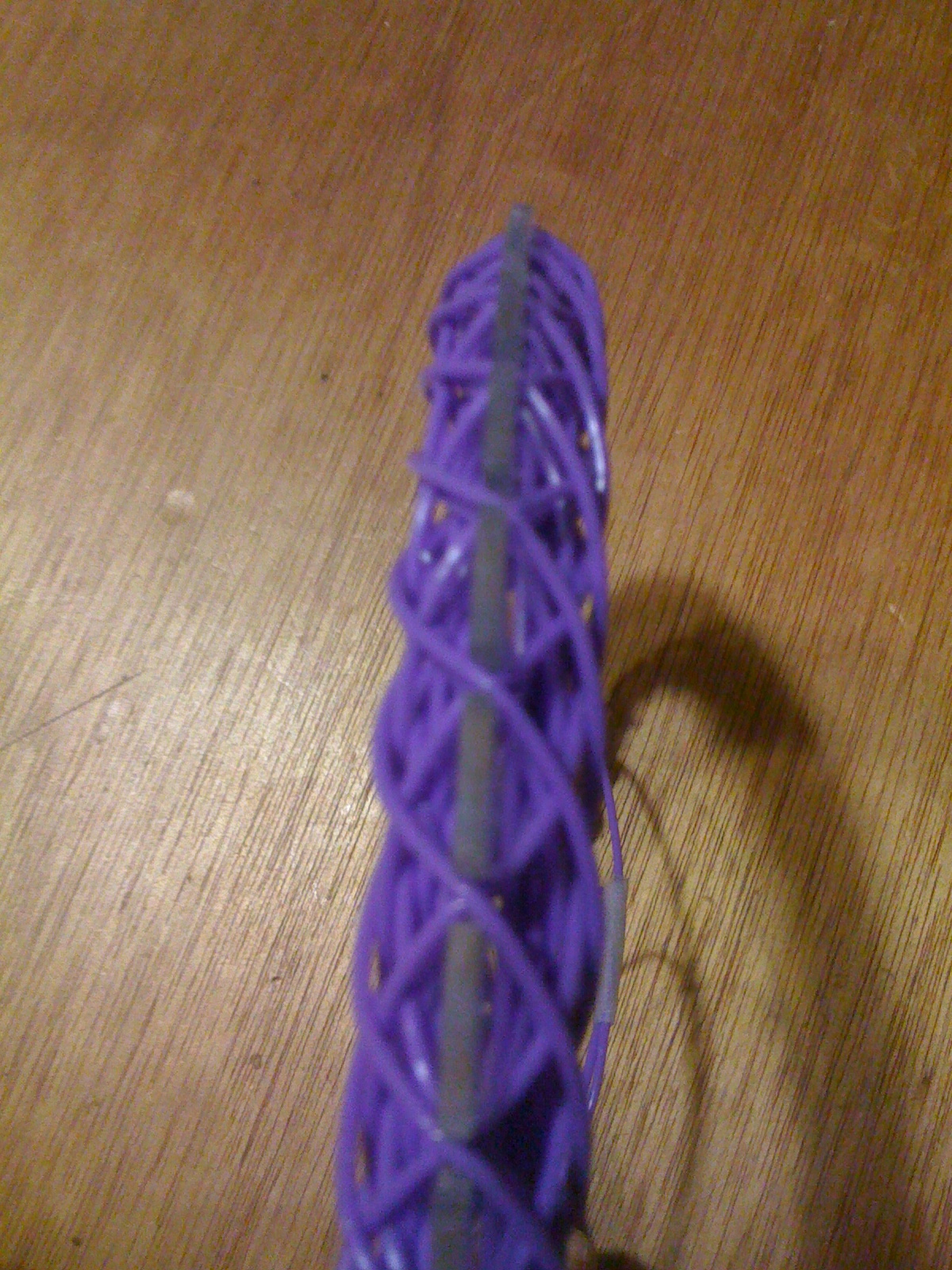

                      OK!, Behold!, my very first coil wind is a basket weave and it works! No errors on the lacing (thanks completely to all the pointers I got from you all), but I did make an error on the form that wasn't apparent until the end of the lacing - I somehow cut the inner wire slots more shallow than the intended .375" and there wasn't enough room for the 6th layer, so it's got 5 layers for 25 windings. I guess it gives me an opportunity to see how a low inductance coil behaves. I will be much more careful about measuring and squaring cuts when I build the next form. Pics of course:
Name:	KR Coil v1-1.jpg
Name:	KR Coil v1-2.jpg
                      So the wire turned out to be stranded instead of solid core - was a surprise to me & hope it works out better than solid core would have, it has a very thick insulation jacket, overall diameter is about 1.9mm.
                      It's specs:
                      180uH
                      2.1 ohms
                      My capacitance meter wasn't able to give a reading so don't know the static capacitance.
                      Out of curiosity I plugged the coil's parameters into Qiaozhi's Coil Calculator and they came out pretty close - it said should be 193uH - I'm guessing the difference is the basket weave instead of a standard tight wound coil - and the difference seems close to the difference between a standard and a D shaped coil (from what I read in the Coil threads).
                      Hooked it up and it does work. The flyback voltage is about 450 volts (my scope w/10x probe only goes to 400V so I'm guesstimating by how much I had to turn the position knob to find the peak of the pulse) - is that OK? The manual says it should be about 350 volts, that's a lot higher, could the 100V higher flyback be related to the low inductance?

                          OK that makes sense Silver Dollar, so this coil at it's low inductance isn't of much use since I don't want to run higher than needed current & I'll re-use the wire for something else. I think I'll add a resistor to lower the current and use it to finish the MPP for now while I'm making a new coil.
                          Nice job on the coil! Pics! It sounds like from what you said that the lower the damping resistor the faster the coil? Good to know...
                          The dimensions on the form on this coil:
                          8" outer diameter of lexan ring
                          5 7/8" inner diameter of lexan ring
                          Wire OD 1.9mm I believe, will verify later today
                          37 slots cut inside & outside, 3/8" deep
                          Note - for this particular (very thick OD) wire and to make the 7 layers/35 turns I plan to use next time - the form will need 1/2" deep slots
                          I will get my mic out today and get an accurate wire OD measurement, & curious what the OD is of your Litz
