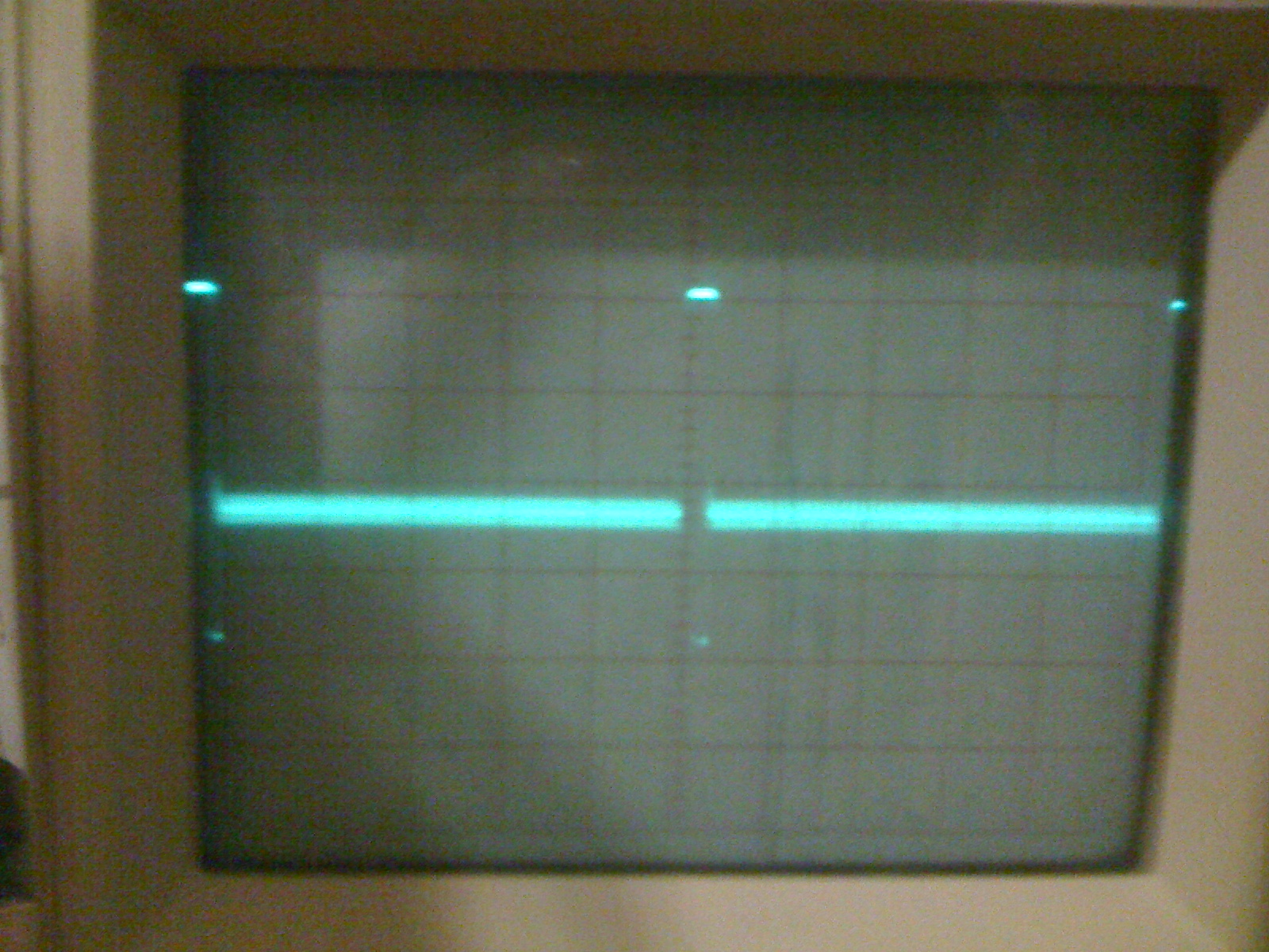

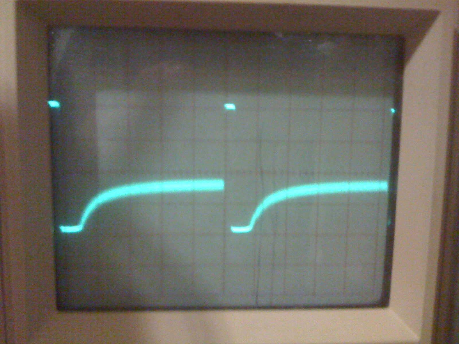

                          I wonder if someone could confirm this is what TP3 should look like after step 5 of the MPP build completed - or if this is not good if I could get a scope photo of your TP3 - thx!
                          I'm running the 180uH basket weave coil, just using the 470 damping resistor for now, no ringing in the flyback
                          The manual says should be about 1VDC offset with no target near coil, I'm seeing about (-.6VDC), with lots of noise making it hard to see the actual offset level, and the Rx pulses also.
                          For these photos my scope is set to 2V/Div with 0V at the center line & DC coupled, .2ms/Div time base:
Name:	Step5 TP3 NT.JPG
                          No intended target near, but this is in a work area with metal objects everywhere, and lots of nearby electrical noise (I don't have a "cleaner" work area at the moment)
Name:	Step5 TP3 T.JPG
                          Heavy 4" looped rusted iron wire right against coil

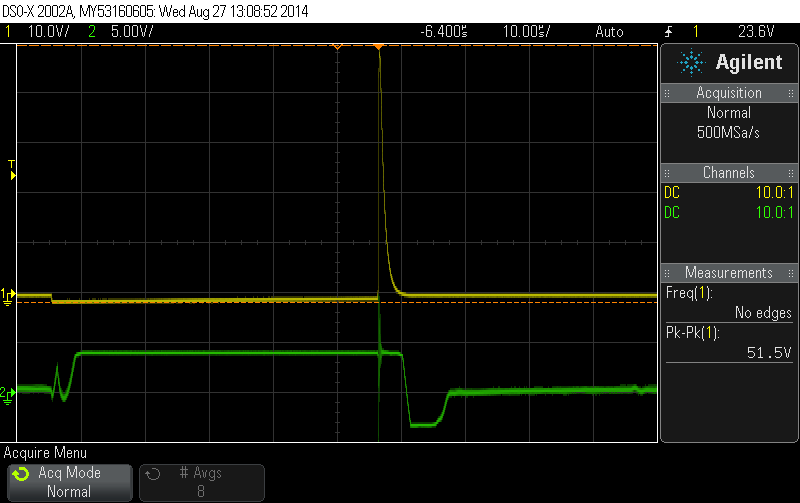

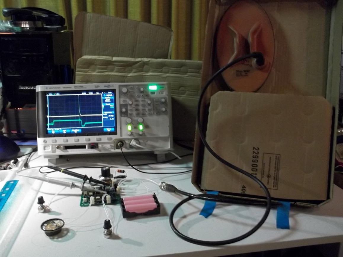

                            Hi KRinAZ, Attached is a shot of TP3 with the flyback pulse on top. The frequency of your coil should be much higher. The capacitance is to high for it to be the coil only. The cable between the circuit board and the coil may be adding to much capacitance. Also your scope test lead may be paralleling it with capacitance. Try the frequency test again by just laying the probe near the coil circuit so there is no direct connection except the ground clip attached to the Minipulse ground. The 400v signal will couple to your probe through the air just fine.
                            The high frequency noise at TP3 looks like florescent light, TV or some other similar source. Try turning stuff off to see if you can locate the source.
                            Are you using a bench power supply? If so try batteries instead.

                                Hi KRinAZ, Attached is a shot of TP3 with the flyback pulse on top. The frequency of your coil should be much higher. That's whaThe capacitance is to high for it to be the coil only. The cable between the circuit board and the coil may be adding to much capacitance. Also your scope test lead may be paralleling it with capacitance. Try the frequency test again by just laying the probe near the coil circuit so there is no direct connection except the ground clip attached to the Minipulse ground. The 400v signal will couple to your probe through the air just fine.
                                Thx Chet! I'm using a battery pack to power it, but the room is lit by fluorescent's, the soldering station is near, as is my CRT scope (which I would hope contains it's noise but maybe not), I'll try to isolate as much noise as possible. Thx for the scope shots. I made the coil with 4' of the wire as the leads back to the detector to eliminate using coax or a cable, and put the 3 turns per inch in the wires so I would hope the cable is as low capacitance as it can be. I'll do some more testing this eve and see if I can get a clean signal...
