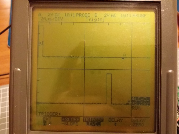

                  OK. I've replaced this pot with 470R resistor and soldieret Step 6.

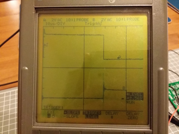

                  I've set main sample delay at 22us. But i have following readings from my scopometer:
                  secondary sample delay 117us instead of 160us
                  main and secondary sample pulse width 8us instead of 58us.
                  Here are screenshots from my oscilloscope: https://drive.google.com/open?id=0B3...ejg&authuser=0
                  Any ideas what went wrong?
                    I guess that these incorrect values are because of differences between nominal and real capacitance of C10 and C11.
                    Should I fit some capacitors to achive correct pulse widths and delays or these values are OK?

                      Hi egonw3
                      8us sample gates are fine for now. I think step 6 is incorrect for stating the 58us sample pulse widths. Look at figure #10 for a proportional view of the pulse widths. I have adjusted the value of C11 and R11 for 5us sample gates. For the 160us delay check the values of C10 and R10 for the correct values. 117us is also ok for now.

                        The main and secondary sample pulse widths of 8us are incorrect. The correct value(s) should be 58us, as stated in the Build Document.
                        The secondary sample delay has a dependence on the main sample delay. The secondary delay is set by R18 and C10. (i.e. 10k * 10n = 100us) But, you need to add the main sample delay to this value. In your case, it appears that you have this set to 17us. Obviously there will be some variation between builds for the value of 100us due to component tolerances, but the actual result should be close. The value of 160us is not correct. That probably came from either the REV-A or REV-B version.
                        The main and secondary pulse widths are defined by R11 and C11. (i.e. 22k * 2n2 = 48.4ns) However, due to the presence of D4 and D7, this delay will be extended somewhat. In this instance, the delay should 58us. I suspect you have a 220pF capacitor fitted in place of C11, instead of a 2n2 (2.2nF).
                          I've double checked and C11 is 2n2 (marked 222 = 2200pF).

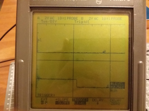

                          At TP1 pulse width is 58us so TX Pulse width is correct (here channel A is TP1 and channel B is TP5).
Name:	TP1 TP5 trig TP1 raising.jpg
                          At TP5 pulse width is 22us and this pulse starts when TP1 pulse ends ((here channel A is TP1 and channel B is TP5, trigger on TP1s falling edge).
Name:	TP1 TP5 trig TP1 falling.jpg

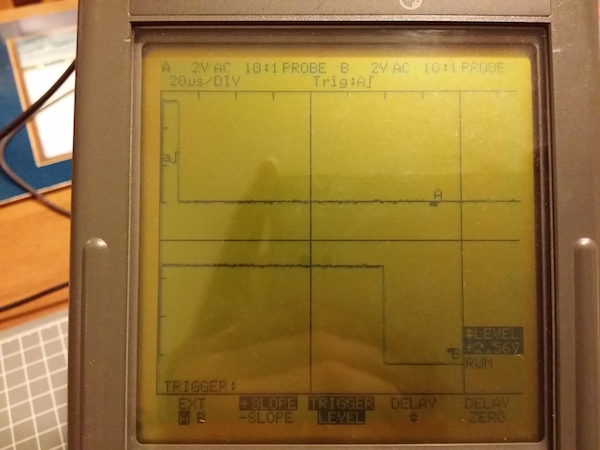

                          TP6 according to documentation is equal to second sample delay. TP6 pulse width in my MPP is 117us (here channel A is TP7 and channel B is TP6):
Name:	TP7 TP6 trig TP7 raising.jpg
                          So we can see, that second sample starts 117us after main sample (here channel A is TP7 and channel B is TP:
Name:	TP7 TP8 trig TP7 raising.jpg
                            I think I've found a mistake: R11 is 2,2k and should be 22k...

                              From your final scope picture, both the main and secondary pulse widths are the same (~8us), but they should be ~58us.
                              How about the value of R11?
                              Have a look at the attached datasheet for the MC14538B monostable, and you will see that the output pulse width is defined by Rx * Cx.
                              On the first page it states that R is in kohms, and C is in uF, which is completely misleading, since R is actually in ohms and C is in farads as far as the calculation is concerned. You can readily confirm this by examination of Figure 5, where Rx=100k and C=0.1uF, yielding a nominal output pulse width of 10ms.
