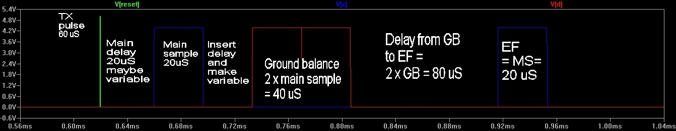

                    Davor, I've been running a lot of sims with your spice file with the pulse from the 555 matching the pulse from my MPP,
                    and using different values of the delay and time base pots, and recording the timing.
                    I've made a graphic based on your micro description from post #21 , which has a variable delay between the main sample and ground balance sample
                    while keeping the pulse width ratio's the same as the cd4011, does it look correct ?
                                The timing is not correct.
                                If you use a delay between main sample and GB sample, the duration of GB sample in the example picture should be 3x main sample. If main sample to main delay ratio is 1:1, the GB sample to (main delay+main sample+insert delay) should also be 1:1. Or better say 3:3, but in your picture it is 3:2. To make it correct, you need GB=60us, and EF=40us.
                                My analogue solution does not have any delay between main and GB samples, and hence GB duration is 2x main duration. This scheme is the most compact of all, but apparently the target attenuation achieved this way is the biggest. So pushing GB sample further in time may be beneficial, of course with keeping the duration ratios.
