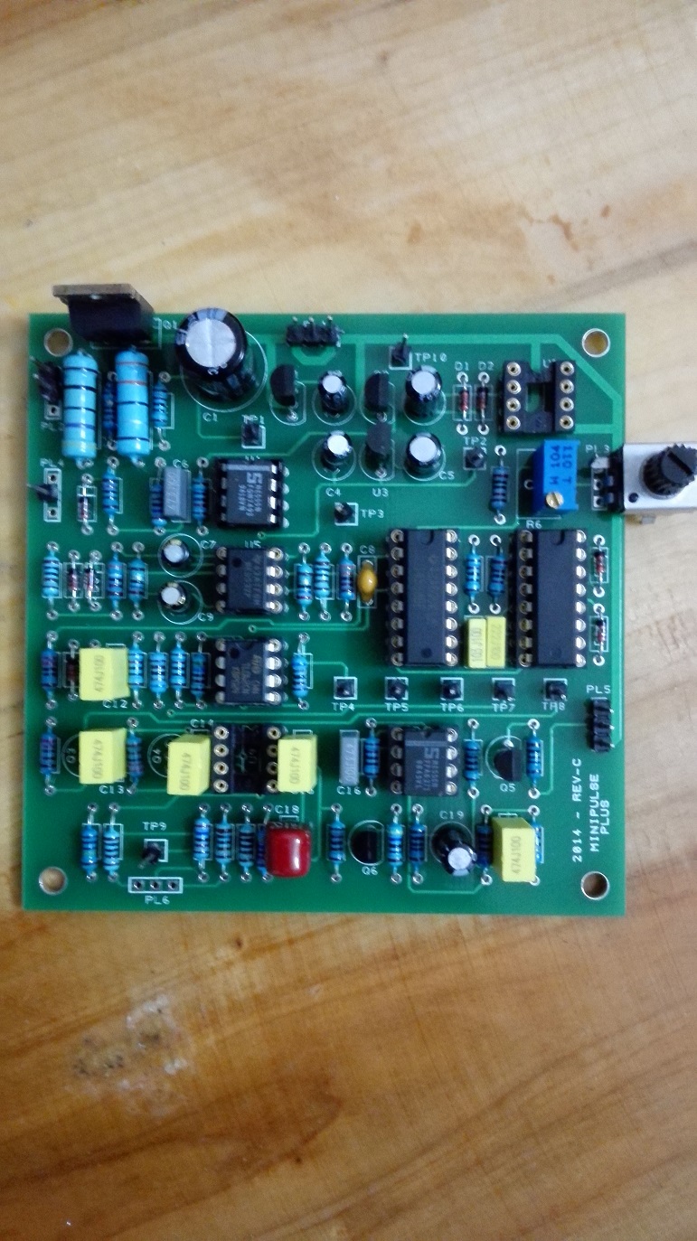

            Allmost done. Click image for larger version
              Have problem at step 7, for Q3 and Q4, I use pn4393. I can't change the Voltage of TP4 to 500mv by adjusting R6. It always -0.03v.
                Did you short the pin 2 to pin 1 or 3 at PL3
                  Yes, I shorted PL3 at step 6.
                    I wonder if the gate cutoff source voltage ratings on those PN4393 could be a problem ?
                    Datasheet shows :
                    J111/PN4393 has Vgs(off) of -3v to -10v
                    J113 has Vgs(off) of -0.5v to -3v
                      If Vgs(off) is below the lowest voltage at gate, the FET is constantly conducting, and that is a problem. Ideally the Vgs(off) is around midpoint between high and low voltages at gate.
                        Allthough my MPP can detect metal.
                        I'll get J113 anyway...
                          I have the same issue with my RevC MPP, & I have the J113 in the circuit, so I just ignored the voltage at TP4 since I used an o-scope for all calibrations - my MPP works fine regardless of the voltage at TP4.
