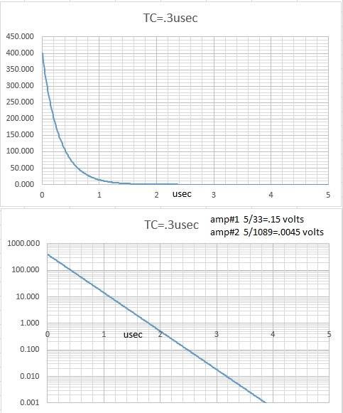

          LM4562, 55Mhz, 20v/usec. Probably explains some of it.
          Charted an exponential decay from 400volts with linear and log amplitude for an example. 300uH/1k=.3usecTC. The linear trace looks like it goes to zero at about 1.5usec. With a 5volt rail the coil volts has to decay 5/33=.15volts for amp#1, 5/1089=.0045volts for amp#2. Adds about 1usec for each stage with this example.
            LM4562, 55Mhz, 20v/usec. Probably explains some of it. Charted an exponential decay from 400volts with linear and log amplitude for an example. 300uH/1k=.3usecTC. The linear trace looks like it goes to zero at about 1.5usec. With a 5volt rail the coil volts has to decay 5/33=.15volts for amp#1, 5/1089=.0045volts for amp#2. Adds about 1usec for each stage with this example.
            Thx, would the 5532 introduce less delay, or am I better off staying with the 4562? I'm under the impression the 4562 itself gives a bit more sensitivity - which is why I 'm using it.
                  The 4562 should be better.
