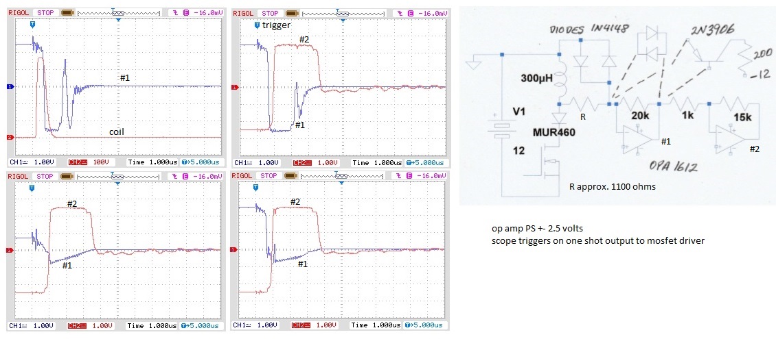

          Ran the time constant for a piece of lead, little over 2x2mm by1mm thick(.8 grains) TC=.8usec. Made another amplifier. Have been using LT6237(90 Mhz), used a opa1612 closer to a LM4562. Not as much gain as your MPP. Tried with nothing across the feedback resistor, back to back diodes and a 2N3906 emitter base across the feedback resistor. Don't see much difference. With spice I see some difference. Still need to work on the circuit to eliminate the ripple(repeats, maybe from the power supplies) . Connecting the scope to the coil effected #1 decay a little(top 2 scope traces). Circuit speed close to what I get with spice.

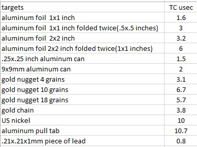

            Green - Somewhere you stated that the decay constant for a US nickel was 10us. When I asked about a target versus time constant chart, I was really looking for something similar for different targets. For example: nickel, dime, pulltab, bottle cap, gold nuggets (or aluminium can squares), etc. I wanted to compare this with the LTSPICE simulation I created from John Alldred's paper. This would then provide a guide as to how practical it would be to detect certain low conductivity targets, and what settings may be required. In other words, the request is simply for a table with 2 columns: Target type and Decay Constant. Do you have such a thing?
                http://www.geotech1.com/forums/showt...715#post207715
                Made some observations in above reply, maybe not correct. Was going to list the time constants but didn't know how for a lot of the targets. What is the time constant for the dime, quarter, aluminum slugs, etc that don't have an exponential decay?
                  A list of targets with exponential decay. Could add more if someone wants a particular target. Lead piece should be 2.1x2.1x1mm not .21x.21
                      green. Excellent work.
                      Probably you have small titanium screws (as used with bicycle, material Ti-6Al-4V) dimensions M5x10 mm or smaller to test time constant?

                        I will try to get one, might be awhile. A couple targets, 1x1 inch aluminum can(5usec), .5x.5 inch aluminum can(2.9usec). I'll add to chart when I get a few more.

                          Can you remind me how you were able to take these measurements, and what hardware you used?
                          I've scanned over your past posts, but cannot seem to find the details.
                          Thanks.

                            Used a 2 stage amplifier, Gain each stage(15 to 20) direct coupled, LT6237 amp(90Mhz) probably higher than needed, but when I started I didn't know better. Used a different coil diameter to get enough signal for the target if needed. Used DSO to record amplifier out with no target, record with target, subtract no target recording from target recording with Excel and chart. I found it's better if the scope doesn't over scale so I added two more stages of gain after the preamp x9 each for added resolution if needed when recording longer decay times, over 100usec.(record no target and target at each gain output before subtracting and dividing by the added gain before adding to the chart). Can chart linear-log to see if exponential decay and log-log if not exponential. I think it's easier to compare targets that don't have an exponential decay log-log.

                              Thanks. I understand what you're doing now. I'm surprised you can get any meaningful measurements on some of the smaller targets.
                              What is the TX pulse width? I guess it must be quite narrow, otherwise the preamps will go into saturation and you'll miss the smaller targets completely.

                                The pulse width has varied. Have used 40 to 240usec Tx pulse width. Starting out I varied the power supply voltage or added a resistor to keep peak current between 1 to 2 amps. The mosfet always avalanches. Lately coil current is in a servo loop, either peak current or constant rate, typically for 1 amp peak. Allows me to compare coils by keeping the same current profile. I trigger on the mosfet driver going low(zero time), usually takes about 4usec for the amp to come out of saturation. Had to use a 1.25 inch diameter coil for the .8 grain lead(.8usec TC) to get enough signal. I have compared decay curves with different coils and diameter doesn't seem to matter. Scope pictures of amplifier out with no target in reply#34. Some over shoot but taking the difference between a target and no target recording seems to solve it.
