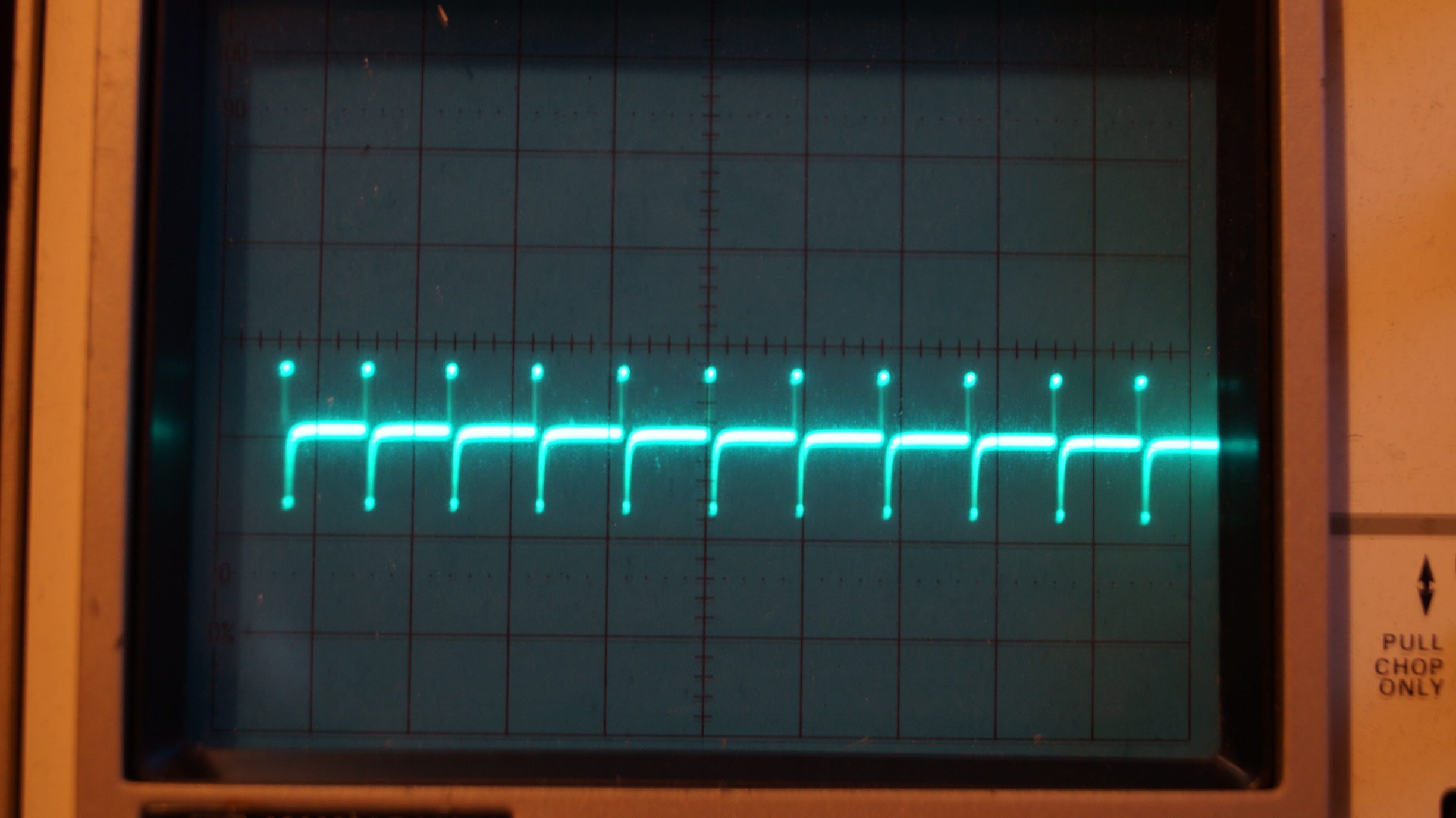

    Ok, before I state my findings I guess I should describe the problem(s); first of all I can hear an annoying, constant, steady, high pitch tone in addition to the expected audio. This whine does not change when adjusting the Audio Threshold and I suspect it is bleeding through from somewhere. Secondly, the response to a target seems highly erratic - sensitivity seems to drop off very close to the coil (there seems to be a dead spot at less than 4cm from the center) and is generally quite poor although I have managed to get a response at around 250mm with a 10cm square of copper clad board.
    Results of poking around with the scope; all test points read pretty much as spec except for TX pulse width of 47uS, and TP3 where I expect to see a DC voltage but see a waveform. ( I know I had a DC voltage during the build but now I see this ... Click image for larger version

ID:	344872 ... and I don't see any change in the DC level when bringing an object close to the coil.

        What results do you get with the coil disconnected?
        Is there still a constant audio tone?

          the constant tone is not there with the coil disconnected. It is 230mm Dia, 22 turns of 26AWG 7 strand PTFE, spiral wrapped and Graphite/acrylic base shield.
          I haven't yet tried to adjust the damping resistor but it looks fine on the scope so I guess if anything it could be overdamping. Could this be the cause?
          It's a bit late in the day to start testing but I'll try to get some scope shots of the audio output tomorrow, with and without the coil attached.

            Have you shielded the coil with aluminium foil by any chance? And if so, did you leave a gap?
            Without a gap the shield will act like a shorted turn.
              The coil is shielded with graphite powder/acrylic base. 2cm gap.
