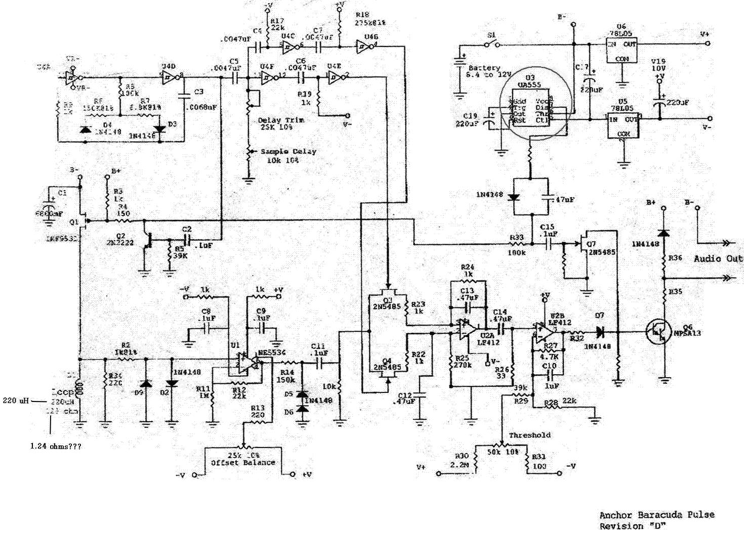

          Do you have the schematic for the original Baracuda design?
          If the original is ok, then somewhere along the line there have been a number of modifications which have made it "less than perfect".
          The only so-called "original" is very difficult to read, as some of the net names and component values are corrupted.
              George, IMO the schematic was especially changed by somebody doing it wrong. so it has mistakes.
              but the generator seems maybe has right values. i still hope to get the pcb pics of revision D (papa alex's board revision is B)
              to see more.

                  In the original schematic that I posted it looks like the 40106 is actually connected between +5V and -5V, and some of the pull-up resistors are connected to +5V, and the pull-down resistors to -5V. It would be nice to know how the original design was configured. Someone appears to have taken the design and made a real screw-up.

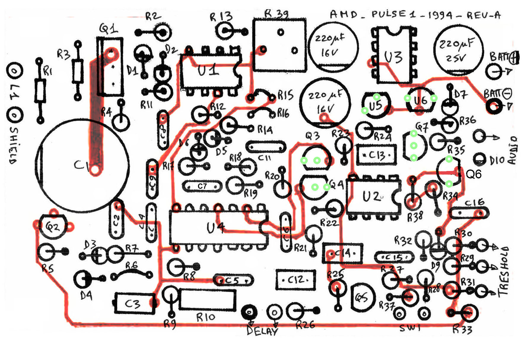

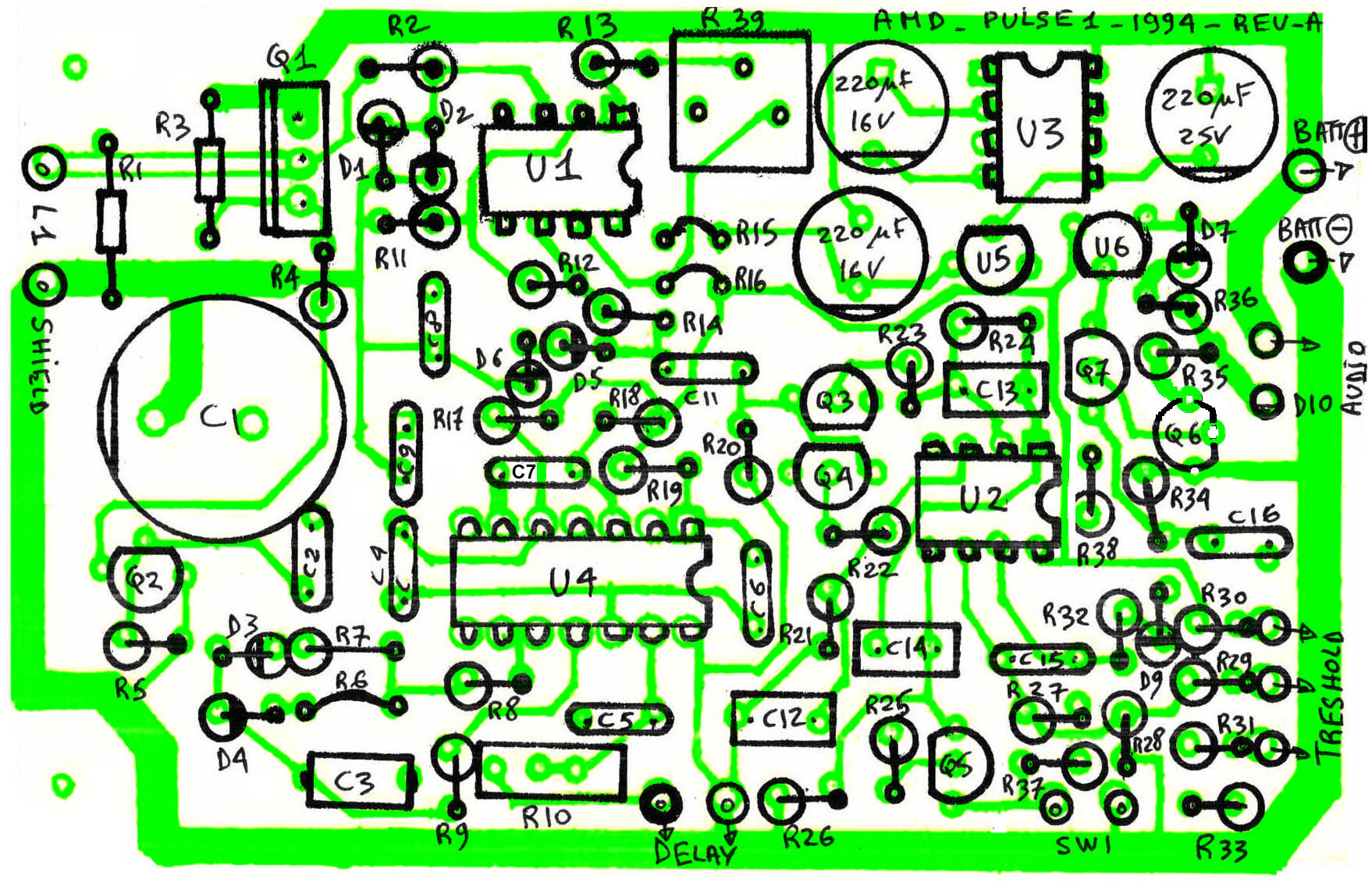

                  • #54
                    its wrond and that i mean above. i detaily did learn papa alexis board pics and his schematics. 40106 is connected to -5V and gnd.
                    pics of layout of both sides are perfect, no mistakes. i did a superposion of his pics in photoshop
                    and they are sure accurate.
ID:	345423Click image for larger version
                    yes. no doubts.

                      N-JFET sample switches are further proof of timing logic being supplied at 0/-5V. Their gates are directly connected to cmos logic outputs, they would forward bias the JFET gates if run between +5V/-5V. This would couple logic output into integrator input through the gate diode.
                          Exactly. I did point that out earlier when I first took a look at the Baracuda design. The confusing thing is that the so-called "original" schematic doesn't show that. Perhaps it's never been correct, and that's why it was changed to 0V and -5V for the supplies, but whoever did that forgot to correct the pull-up resistors.

                            I'm somewhat inclined to take the Apberp REV-2 version and fix it so that everything functions correctly, without making so many changes that it's not the same design. Then create a "Geotech Baracuda REV-A" version, as I think simply changing it to REV-3 will confuse everyone. IMHO it would best just to draw a line under the existing stuff and start again.
                              Maybe we should just stay with the 0 and -5V design. Ray has proven that this works if the pull up values are adjusted. But as mentioned in my last post we should not conclude that this is engineering that will produce a repeatable design. Unless someone has and commits the time to verify it will work under all conditions, this is more of a variant.
