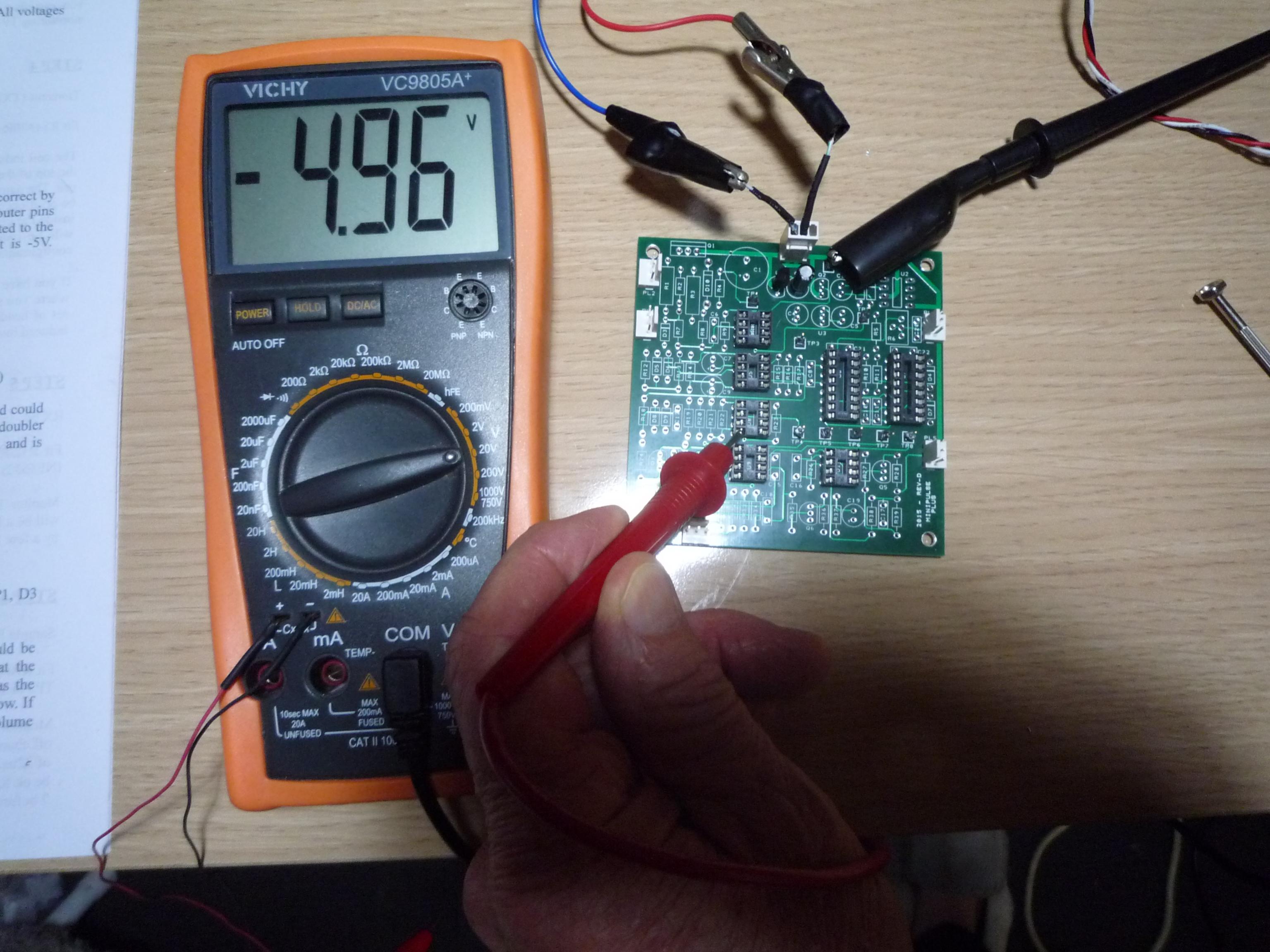

    Received my Minipulse Rev D board today, thank you Silverdog. Very nice.

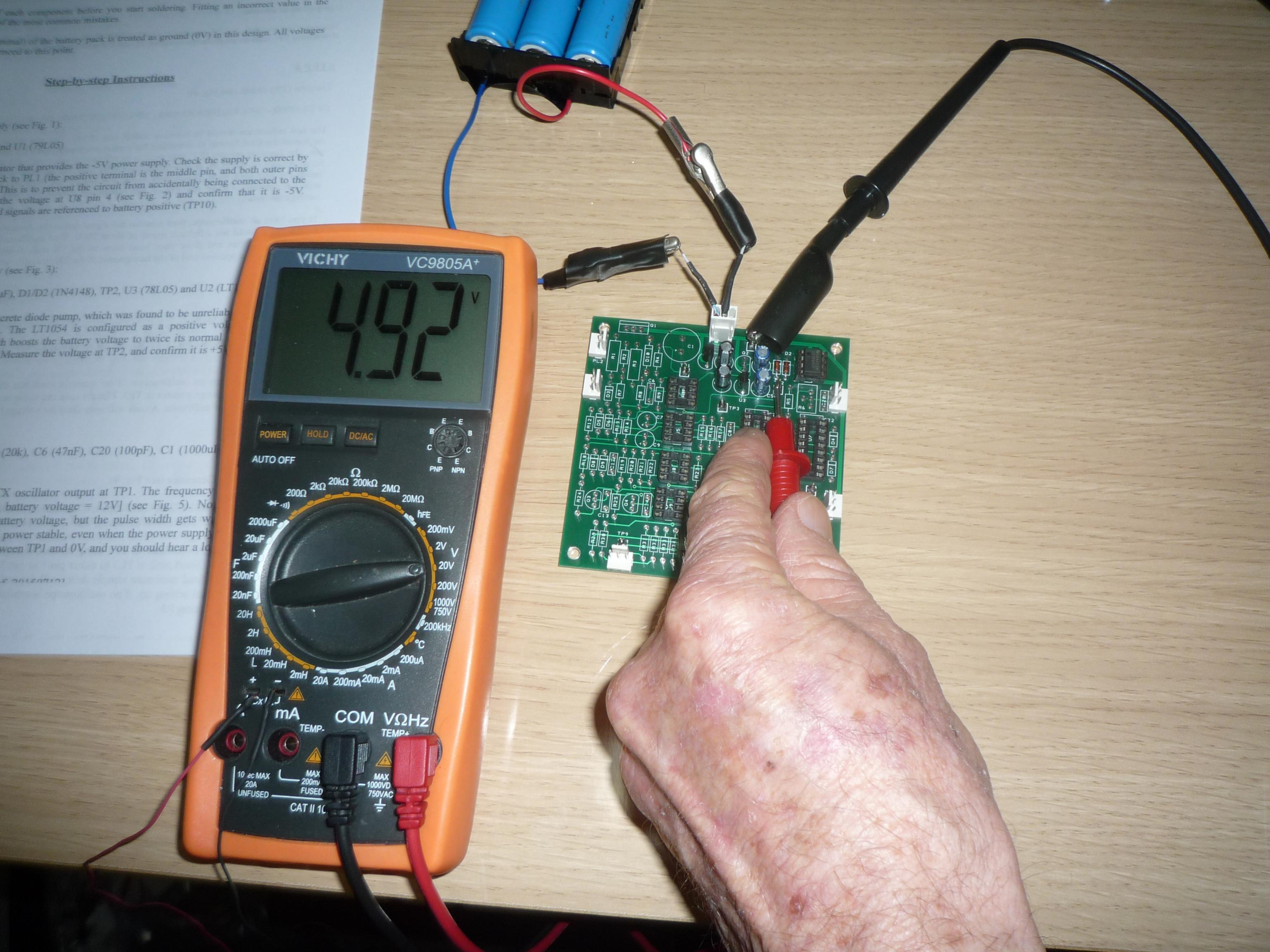

    Completed step 1 and have -4.96v
    Finished step 2, all good with 4.92v

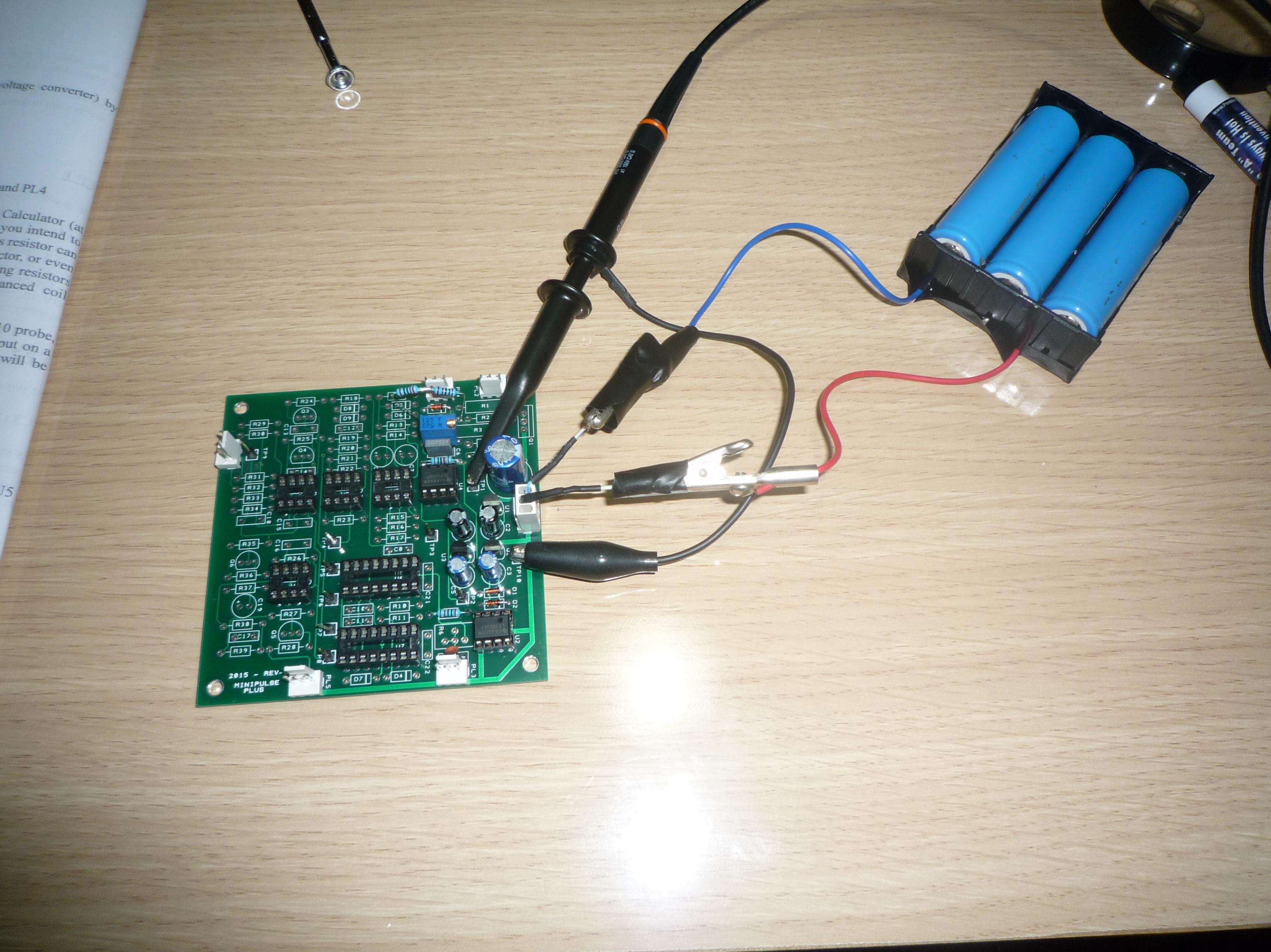

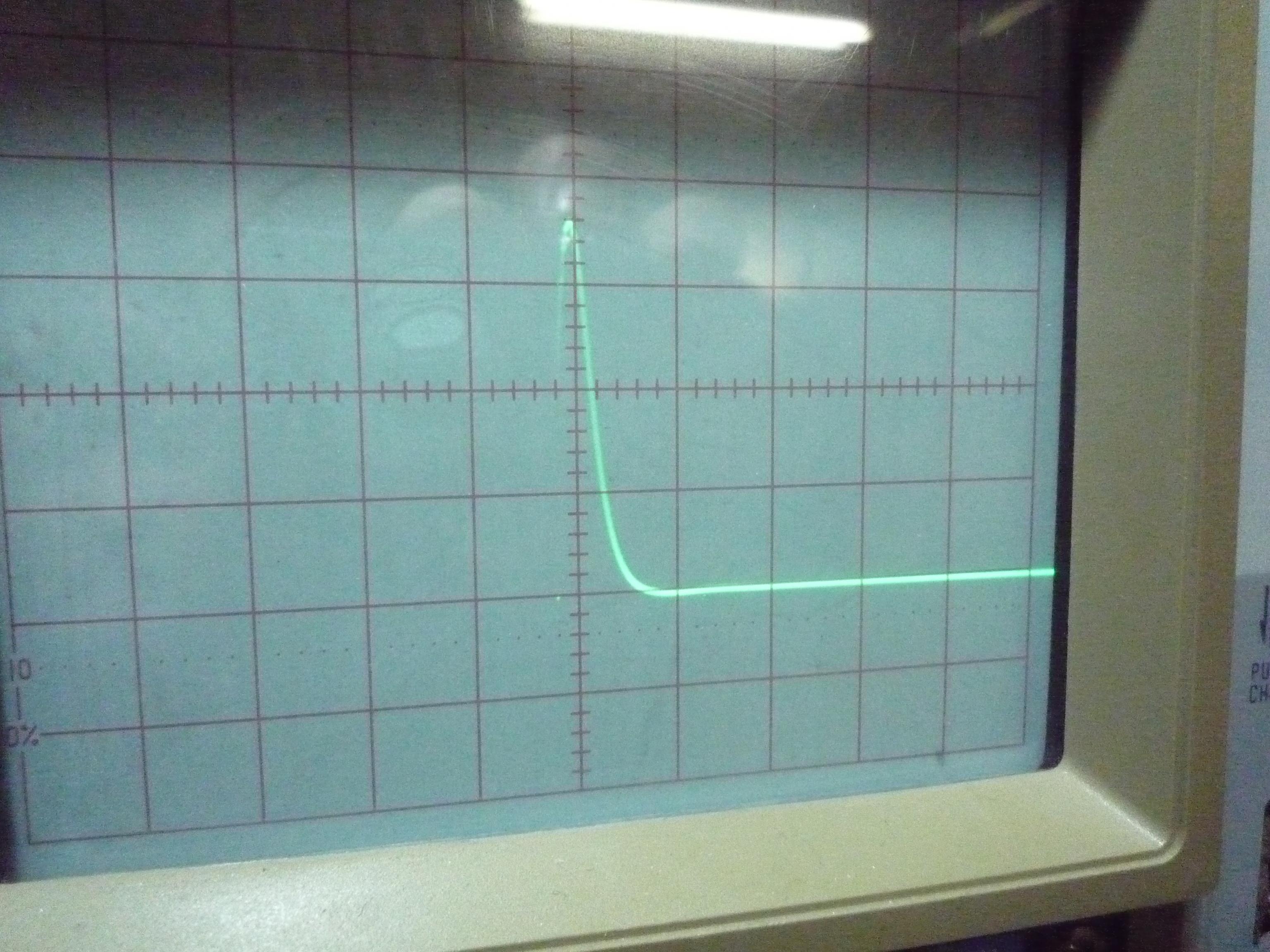

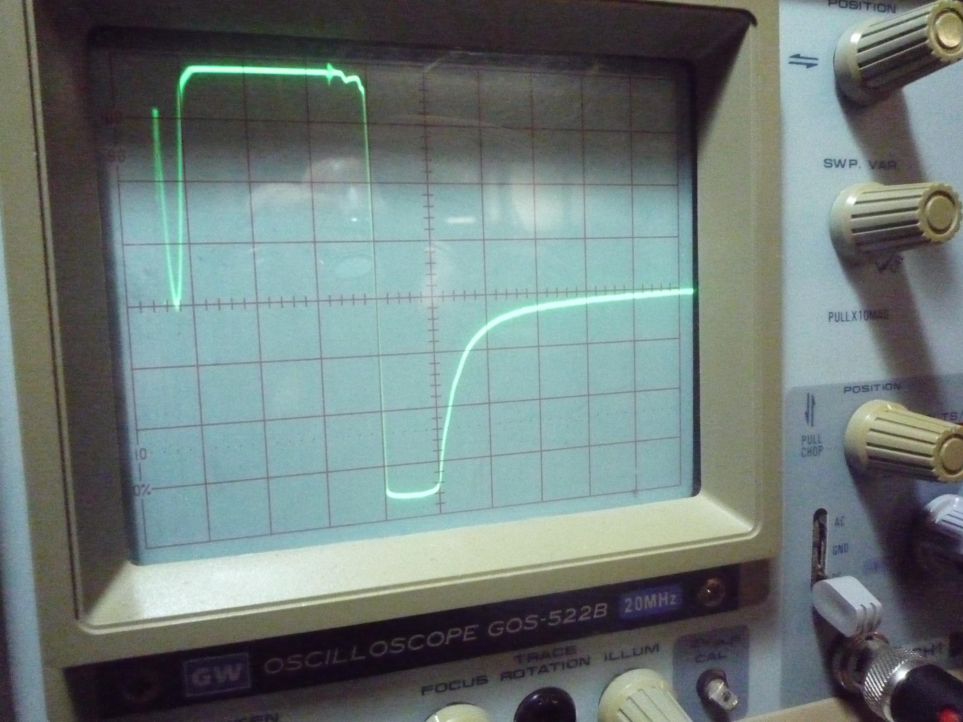

      Completed steps 4 & 5
      Step 4 not sure if the voltage is as it should be, I make it about 180v.
      Oscope Volts set at 5 x 10 & time set at 2us
      Step 5 looks OK to my untrained eye.
      Oscope volts set at 0.1 x 10 & Time set at 5us

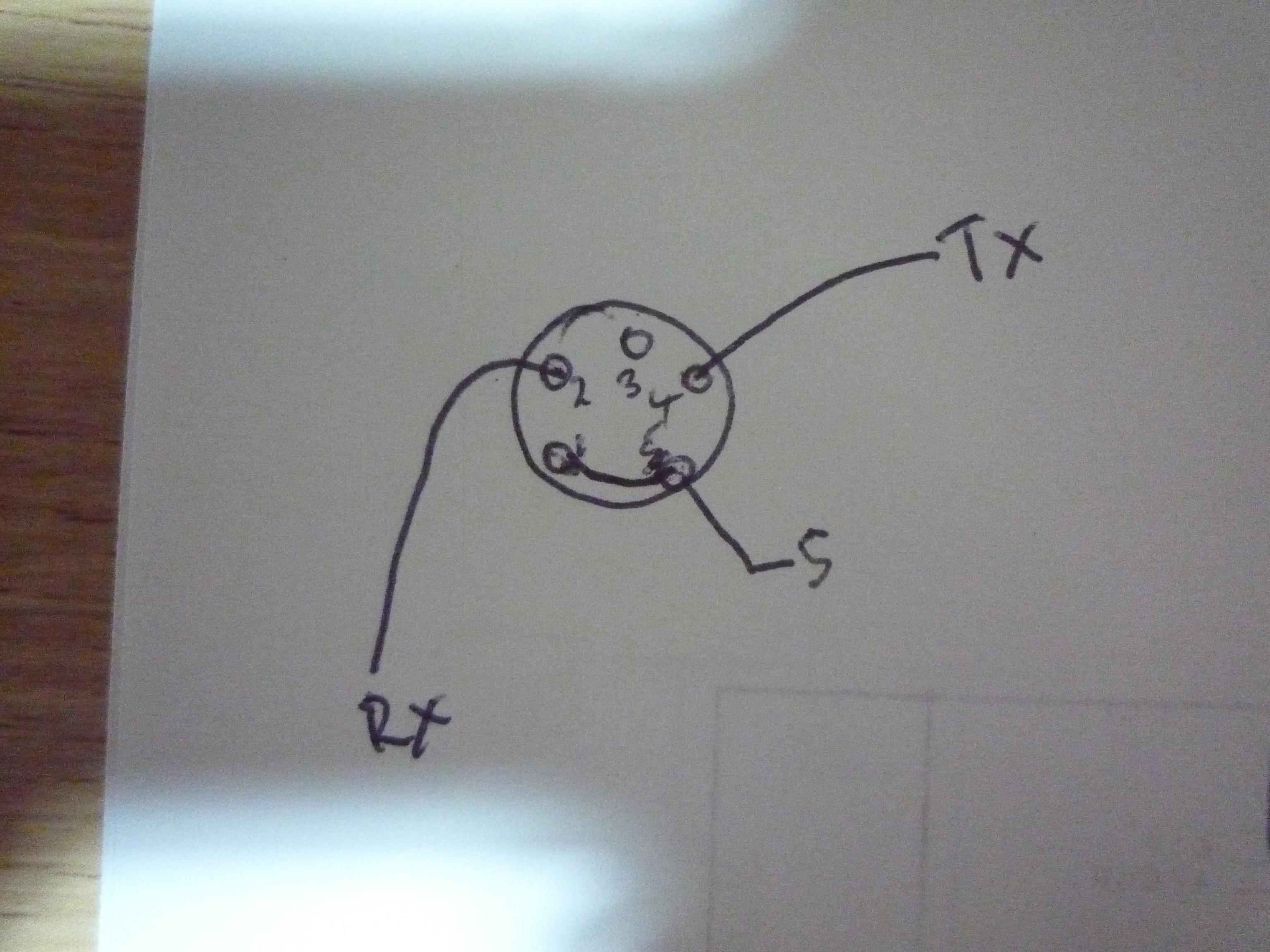

      Wired the coil plug up to suit (in my mind anyway, correct me if I'm wrong) my commercial NF mono coil which is around 340uH & 0.4 ohms.
      Don't have a DD coil to test but hope this will work.
      Will press on anyway

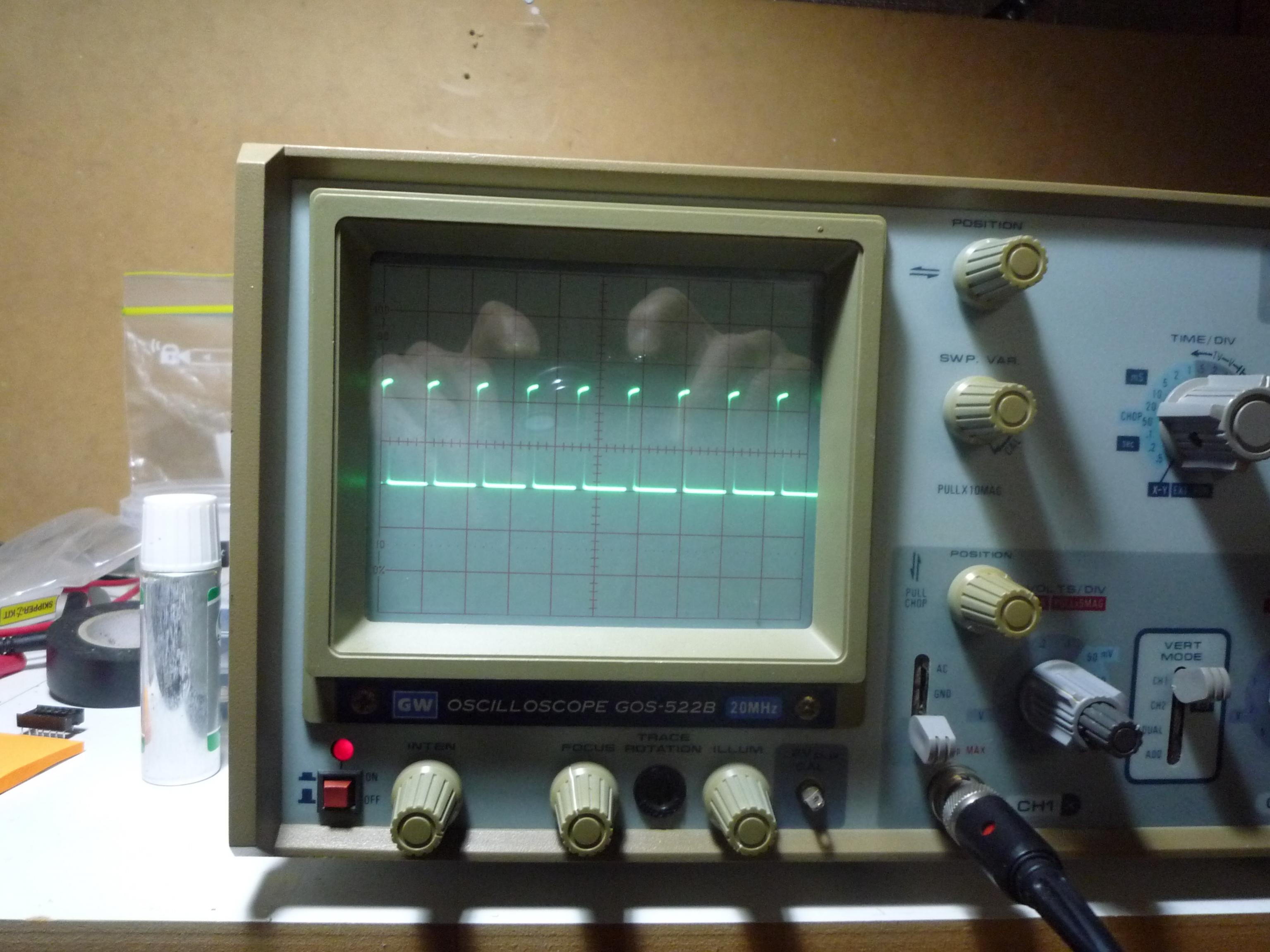

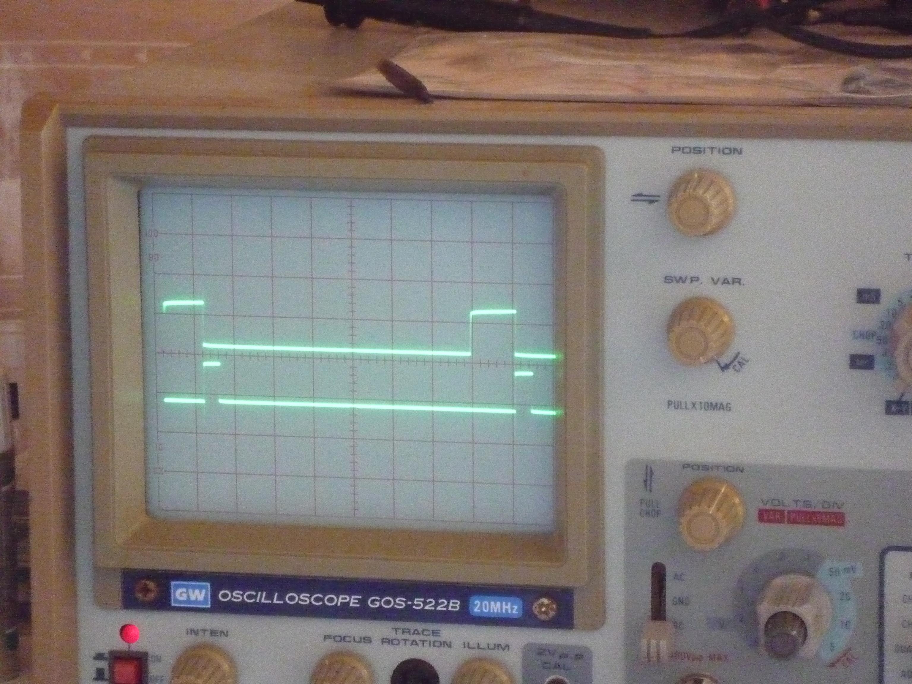

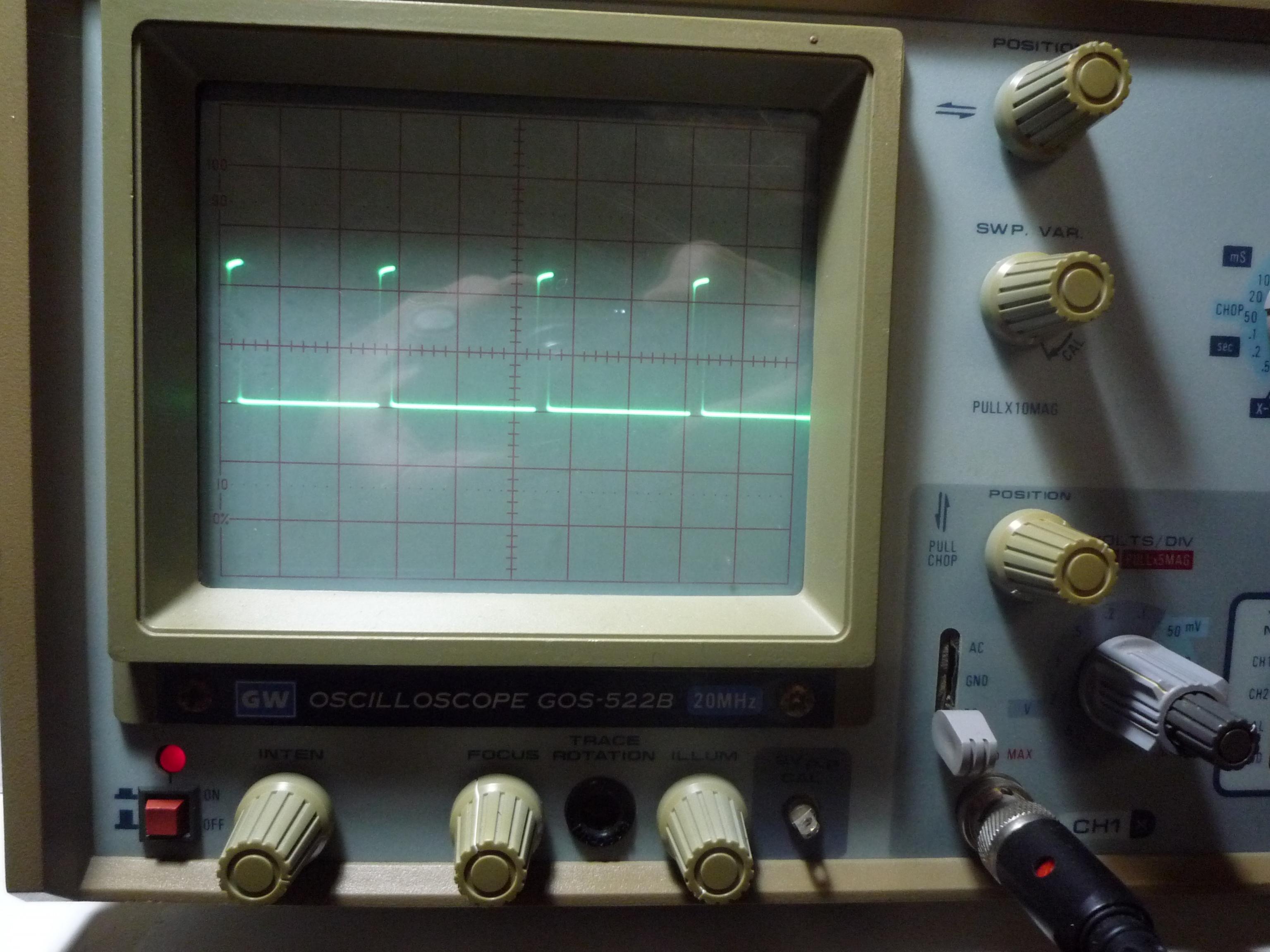

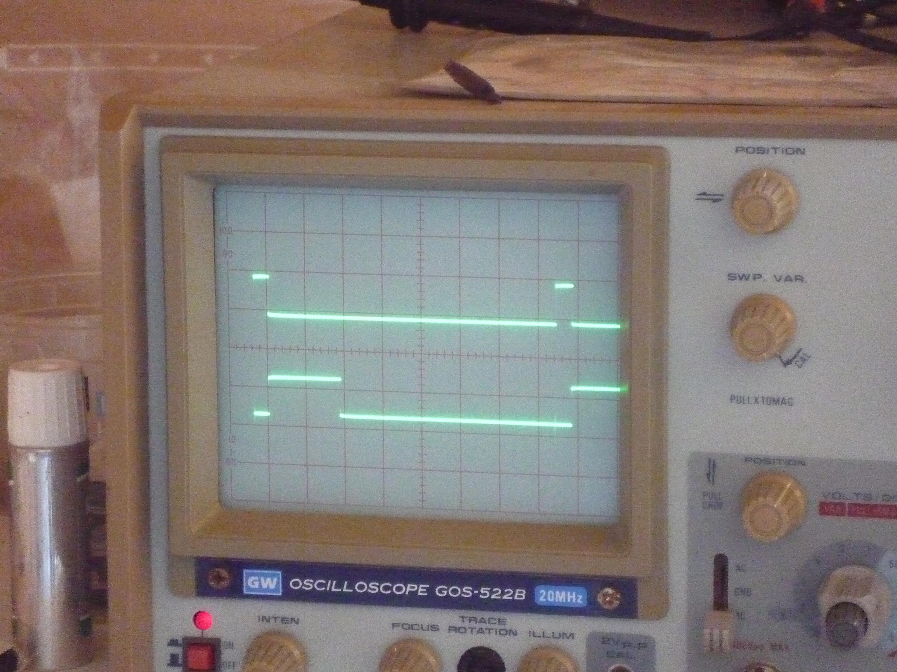

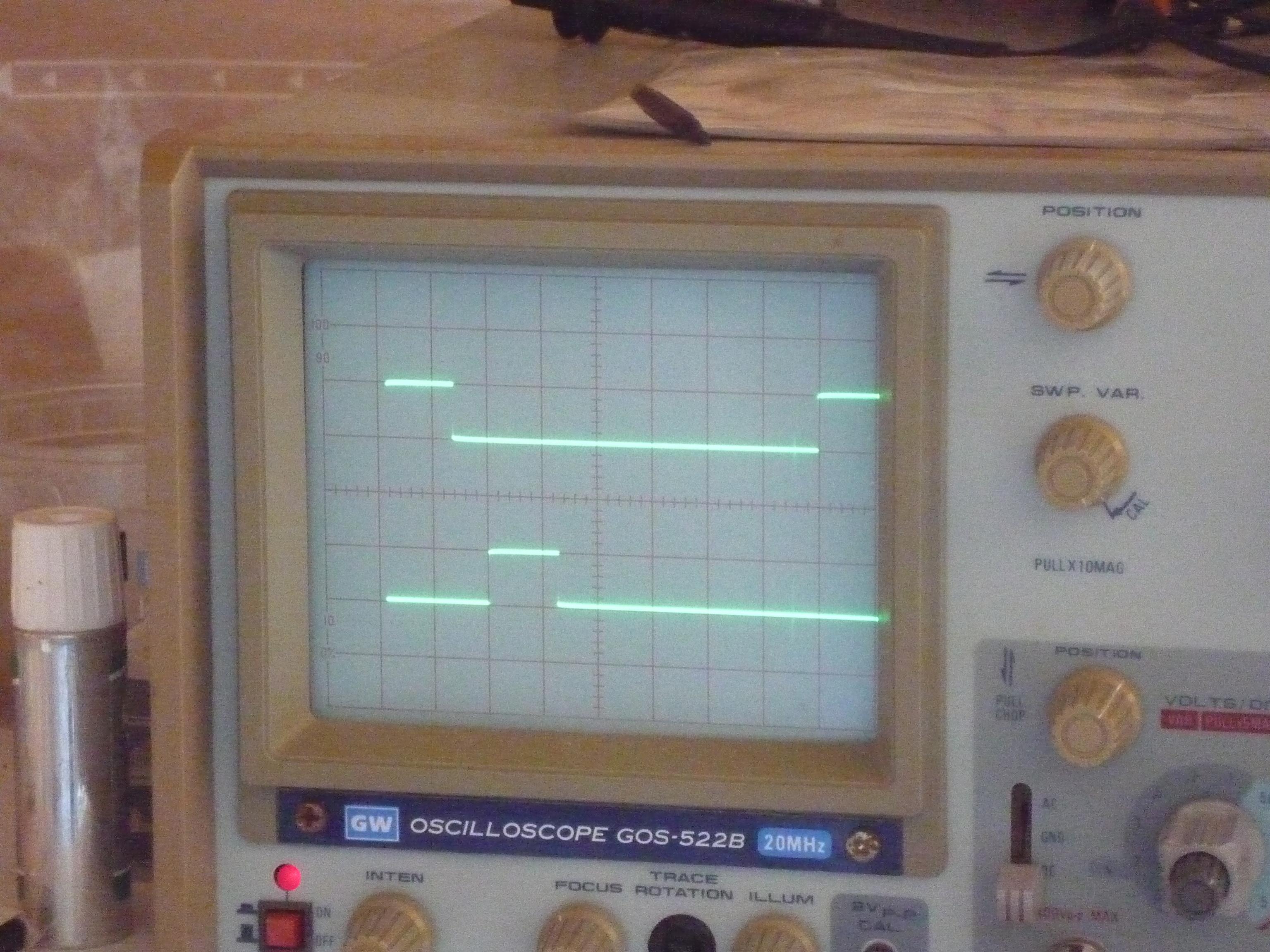

        Step 6 complete. All looks OK to me.
        First photo is TP1 & TP5 showing pulse width on top and main sample delay below.
        Was a bit confused with the sample delay trace thinking it was the width I was looking at.
        Oscope settings of 50us and 0.5v x 10 for all photos.
        Second photo is TP5 & TP6 showing main sample delay and secondary sample delay.
        Third photo is TP7 & TP8 showing main sample pulse width & secondary sample pulse width.
