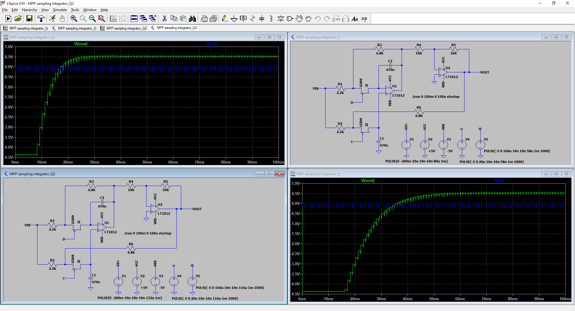

    This is an LTSpice simulation of the sampling integrator used in the MPP.

        For a long time I thought increasing sample time to GB wouldn't work with the MPP. Members were posting they had success and I convinced myself I was wrong. Was playing with Qiaozhi"s simulation and didn't get the gain to double when I doubled sample time. What am I doing wrong?
          The integrators are NOT Linear. They also have a Maximum V out regardless of intgration time periods.
          You are looking at this wrong.
          Instead of looking at the 'final' output V look to the output Voltage at say 20msec after a change of the input Voltage.
          Your simulations show a huge increase of output Voltage with the longer integration time at 20ms, ~.25V for 116us verse -2.75V for 58us.
          Also remember how long a Target is under the coil when sweeping the coil across the ground. For a 1 meter/second sweep rate and a coil sensitive size of 2cm, the detector has 20ms max to respond to the target.

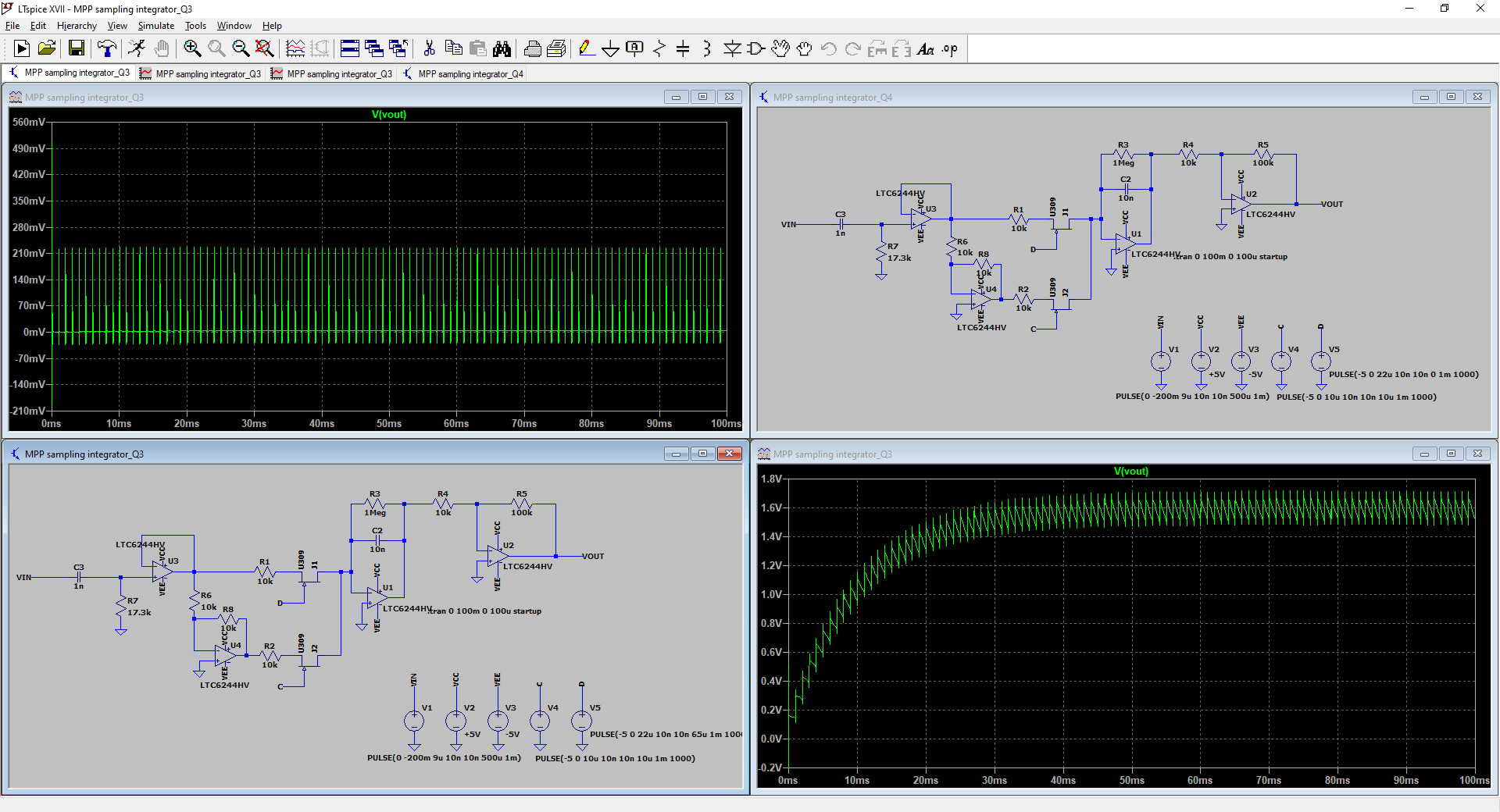

            I think you're incorrectly expecting the output voltage of the sampling integrator is going to increase in amplitude with increasing sample pulse width. This is not the case. Run the attached simulation, and note that the sampling integrator has a faster response with increasing sample pulse width. This allows it to respond to weaker targets. Remember also that the sampling stage is followed by a self-adjusting threshold and a further integrator stage.
            The simulation has been modified to use 10us, 20us, 60us and 120us sample pulse widths for comparison, and the input signal has been reduced to 1mV.
            The simulation results also shows VOUT has a faster rise time with longer sample pulses. Note that the apparent increase in gain (sensitivity) is not linear.

              Also the original simulation is really only showing the 'start up' settling of the integrator.
              Another way to run the simulation is add a 'pulse' to the input that is delay by a 500 msec. Make the pulse 1mV and 10ms to see how the integrator responds to a target sweep under the coil.

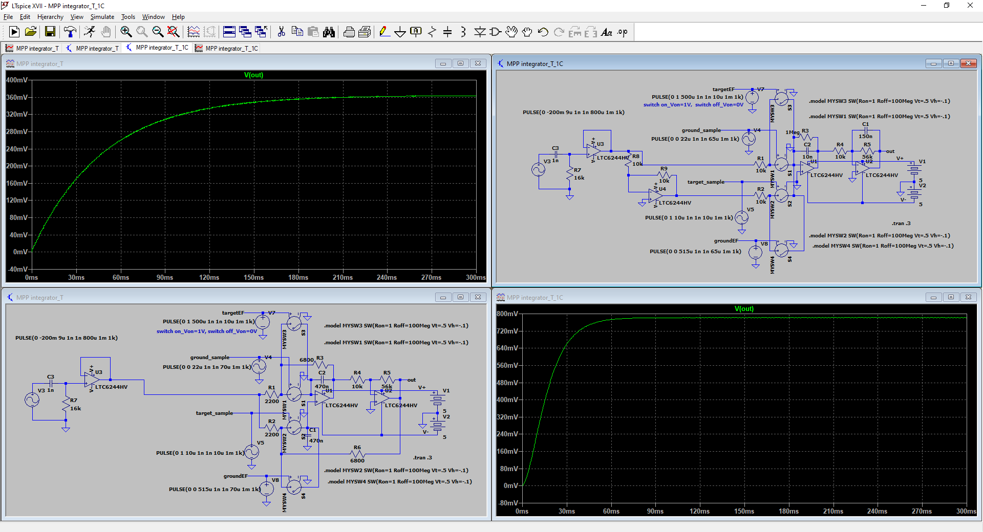

                I think the original simulation shows the response and gain of the integrator. Reason I changed the input to include zero volts. Gain is output/input. Step response changes with sample time, gain doesn't. Not seeing how the integrator can cancel a ground signal by having a different target sample time and ground sample time. Think I remember making a MPP simulation where changing second sample time would GB but don't remember how.
                Changed the simulation to 1C integrator. GB has a hole so I adjusted target TC and second sample time to find the hole. Is there a way to simulate the MPP integrator to have a hole?
                  I am following this with great interest thanks.
                    Found the simulation that I thought GB. Replaced the target and ground signal with the decaying target to see if there was a hole. Low signal but when I reduced the input TC in in half still a low signal compared to the 1C integrator. Don't know if the real circuit can GB but so far I can't get the simulation to GB. Including the simulation with target, ground, target EF and ground EF samples. Maybe someone can see where I went wrong with the simulations. When I first tried I thought adding the EF samples solved the problem, now I don't think so.
                      Still trying to understand the MPP integrator. Made a 1C integrator almost same schematic for comparison. 1C first stage gain=Rfdbk/Rin*sample time*sample rate, second stage gain=Rfdbk/Rin, total gain=5.6. Thought MPP gain was Rfdbk/Rin second stage, 5.6, appears to be 2.6. Anyone know formula for MPP integrator gain? Simulations with ground sample and ground EF sample off, target and target EF only. Anyone see any errors in the simulations?
                            1C integrator gain same as Carl's formula? Calculates same as simulation for 1C integrator. reply#11
                              Thanks for the replies, I was asking for MPP integrator gain. reply #11, doesn't appear to be the same as 1C or 2C integrator
                              Think MPP integrator gain formula is (R3/R1)*((R5/(R4+R5)) https://www.geotech1.com/forums/atta...8&d=1574962175 MPP is left side, 1C integrator is right side
