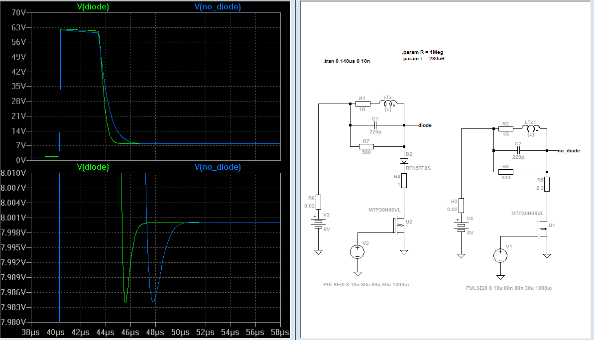

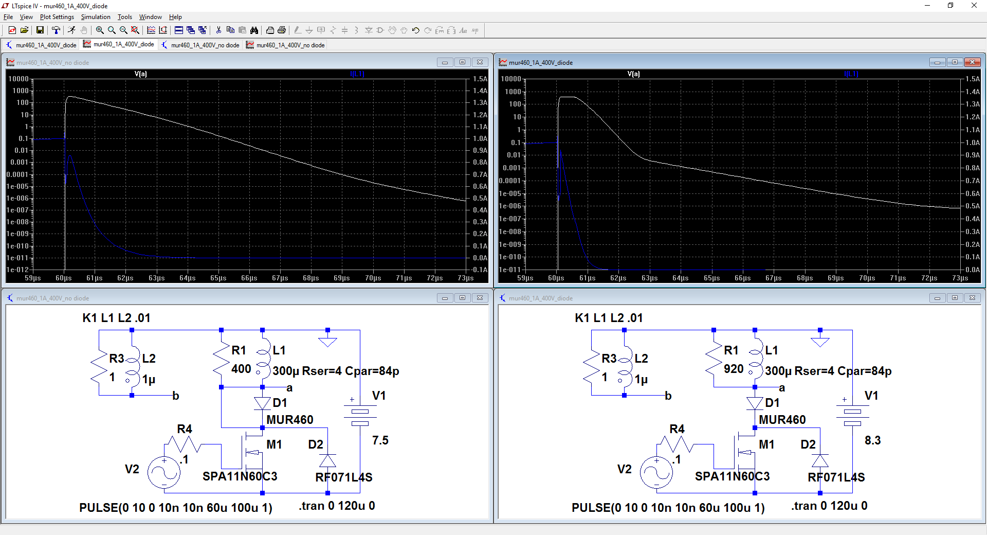

          Spice simulation. Both 1 amp peak current. 1MHz coil. Coil volts has to decay to 10mv before amplifier can start to come out of saturation. 2.5usec with diode, 6.5usec no diode.
            Of course, there's little point playing around with the diode anyway, if your MOSFET is going into avalanche mode. Then it's more important to either replace it with a higher Vds MOSFET, or reduce the TX-on time to prevent it avalanching.
            At lower Vds the Coss is larger and the effect of the diode more noticeable.
            Example with avalanching MTP30N06VL (60V mosfet), decay is over 2us faster with diode.

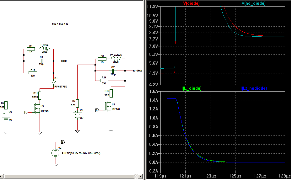

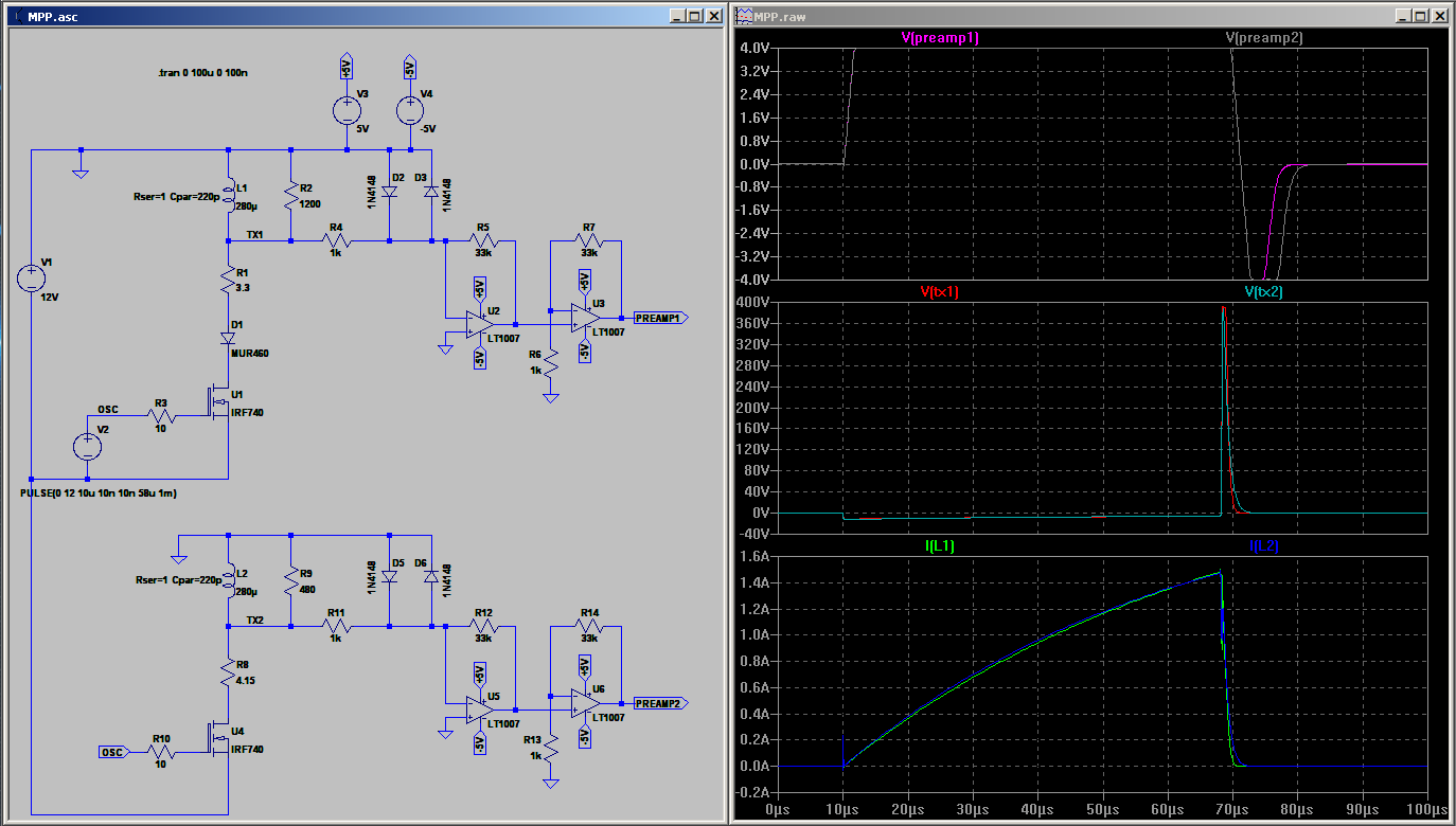

                  As the original question was about the diode in the MPP, I have simulated that part up to the preamp output. See attached simulation file.
                  As you can see, there is a definite improvement in the ability to early sample when the diode is present.
                  For this simulation you need the following parameters:
                  MOSFET = IRF740
                  Coss effective = 211pF
                  With diode: Rd = 1200, Rs = 3R3, preamp comes out of saturation at 6.7us
                  Without diode: Rd = 480, Rs = 4R15, preamp comes out of saturation at 8.8us
                  Then, replace the MOSFET for an IRFIBF30G:
                  Coss effective = 103pF
                  With diode: Rd = 1200, Rs = 3R3, preamp comes out of saturation at 6.5us
                  Without diode: Rd = 1200, Rs = 4R15, preamp comes out of saturation at 6.5us
                  In this second example, there is no difference with or without the diode.
                  Note that you need the MOSFET libraries posted by Teleno in an earlier thread.

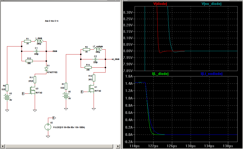

                        My previous experiment (with a different circuit) showed that inserting the diode actually produced a slower response, which was contrary to what was expected. I need to revisit that experiment to understand what's going on.
                        My explanation.
                        The damping factor of a parallel RLC circuit is:
                        ; (higher damping factor = slower decay)
                        If R remains the same, lowering C increases the damping factor (= slower decay)
                        If you only add the series diode the response deteriorates, you must also increase the damping resistor R.
                        Simulation adding the diode and keeping R the same:
                        Simulation adding the diode and increasing R:

                          I agree. That's why I also increased the damping resistor in my simulation. For each change, I set Rd for critical damping.
                          Another thing you can try, is to replace the MOSFET with an ideal switch, and put a 211pF capacitor across it. With the diode, the preamp comes out of saturation just slightly under 6.5us, whereas the IRF740 was measured as 6.7us. Interestingly, lowering the parallel capacitance to 103pF (to match the IRFIBF30G) also results in 6.5us.
                          I think the final conclusion (at least from a SPICE simulation) is that the series diode does improve the ability to early sample. How much you gain depends on a number of factors.
                          What I don't understand at the moment is why my practical experiment produced results that were opposite to what was expected. I need to revisit that soon. Perhaps I hadn't optimised the damping resistor properly, or something else is going on.
