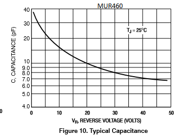

            A picture of capacitance vs reverse volts from a spec. sheet. The reverse volts across the diode is over 200volts 10usec after coil turnoff. I'm thinking diode capacitance is less than 7pf, maybe wrong.

              In the On-semi datasheet for the MUR460, the diffusion capacitance is show in the graph as 36pF at 50V, and over 100pF at the lowest voltage. The problem here is that both the MOSFET Coss and the diode diffusion capacitance vary non-linearly with applied voltage. Unless we want to solve the full equations, we can only estimate some of these values. At the moment, SPICE simulation agrees more or less with my real world measurements, and my conclusion is as before:

                The picture was from the On-semi datasheet. If the reverse volts is over 200volts why are you concerned about capacitance at 50v and less? I'm thinking if the resonance with the diode is greater than with the scope connected to the coil the capacitance has to be less than scope probe capacitance, typically less than 15pf with a x10 probe. Just trying to understand what is happening.

                  Think you are looking at graph for the MUR405,410,415 and 420 not the MUR460.
                  Haha! ... you're correct. Looking at graphs late at night is not a good idea.

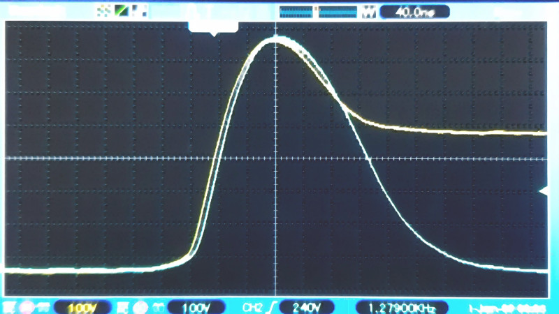

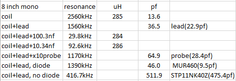

                    Interesting test. The coil with cable resonance(94pf, 432uH) should be 789kHz. I've been testing resonance exciting the test coil and cable with an operating PI. Wondering if you could remove the 432uH coil and cable from your test circuit. Connect a different coil and cable to the test circuit. While monitoring amplifier out for resonance bring the 432uH coil and cable near the operating coil to see how close to 789kHz the resonance is using this method.
                    Thought I would try the procedure with my bench circuit with a 8 inch mono coil shielded top and bottom with graphite paint. Top 5 lines, resonance was measured exciting test coil with the bench circuit(IB coil). Bottom 2 lines test coil was connected to bench circuit(replaced IB TX with 8 inch mono, Rd not connected). x10 probe is labeled 13.5pf, don't know why test calculates 28.4pf. Diode is less than probe and calculates close to the 7pf the MUR460 chart suggests. Coil inductance was calculated from resonance using two different capacitors that two different multi meters read close to the same values. Coil lead, 31 inches twisted pair that measures about .9pf/inch with the multi meter.

                      In my recent experience I found out that whether the diode helps or not depends on its reverse recovery time.
                      A transient in PI is more or less a half cosine with a duration between 300ns-1us. The diode is reverse biased in the second half and it has 150ns -500ns to do the blocking. Its reverse recovery time has to be significantly shorter otherwise it would simply conduct instead of block. Rather than an improvement you get a slight deterioration and power waste because of the voltage drop it introduces when in series with the MOSFET.
                      There are several possibilities but every one of them implies some kind of trade off. A regular silicon diode (rectifier) is to be avoided at all costs, their recovery times are in the us range. We're left with either fast/ultrafast recovery diodes (25ns -100ns) or schottky diodes (zero recovery because they're based on majority carriers).
                      The fast/ultrafast recovery diodes have a larger forward voltage (1.3V to 3.6V) which gets larger as the voltage rating gets higher. The drop will be in series with the MOSFET reducing power efficiency significantly.
                      The schottky diodes have zero recovery time and only their intrinsic capacitance will delay the blocking. Forward voltage is around 1.5V maximum. Higher voltages are hard to come by, usually SiC for tens of amperes with capacitances in the order of 200pF.
                      I've tried the ultrafast MURS160 (50ns recovery, 10pF) with good results (see the video I posted here: https://www.geotech1.com/forums/show...272#post289272 ). The transient in this case is 700V with a duration of 300ns of which 100ns are actually blocked.
