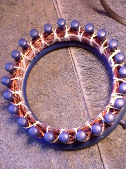

            Not built it as of this time . Have two PCB and all parts set up to go. I would try a basket coil on that thing. This is a 5" I'm playing with for the Barracuda. Pretty much same requirements.
            5 inch form
            24 SWG copper
            Unknown Turns
            410uH
            1.4 Ohms
                  5 inch form
                  24 SWG copper
                  Unknown Turns
                  410uH
                  1.4 Ohms

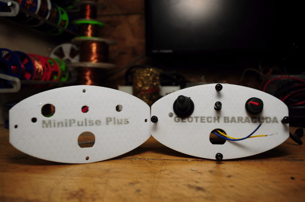

                  Have you made the Case for the Barracuda and MiniPulse Plus yet? If you have access to a 3D printer I would be more then happy to share the STL files for the case I made, Later on this morning I will Link a few photo on the this thread for you to see what it looks like, It pretty nifty with 3X 18650 battery pack imbedded in the back cover. both the BABA and the Miniplus use the same case with only difference being the faceplate.
                    I do not have a Printer but may have access to one. Yes, Please post what yours looks like.
                      four parts one of which ( white handle gripper ) is glue on to the main case. like I said the main faceplate/ board holder is the only difference from the Baracuda and the Minipulse plus I made mine for what I use, the holes for the pots are for normal 8 mm shafts and the light hole is for a 5mm led, I only used two pots but I can add two more holes for a 4 pot config, also the front cover has the hole for a IP68 Connector which is what I use to plug the head set and some hole size in back cover for the Coil coax.
                      It was easier to make a drop box link for the photos, Let me know if you can see them please. https://www.dropbox.com/sh/5thzm8mxu...2mue-41Ta?dl=0

                        Cool Stuff. Bounty Hunter Look a LIKE. Good deal on the 18650 battery tray. What was the cost on printing those ?
                          Hahah im not sure if that's an insult or not , I couldn't tell u what a bounty hunter looks like , it does look somewhat cheap and when I designed it, I made it to be easy to print, and so everything would fit nicely. I have to admit the Big case part I printed fast with a big 0.8 nozzle and I had to re layer with Abs slurry and sand the big extrusion lines to make it look somewhat nice. but that didn't take long at all. The batteries are always the biggest head aches to design around. the first case I made was smaller, but the battery pack I had previously made didn't look nice and was not permanently attached which was not good for me.
                          To answer Cost : Its all printed out of ABS , At 25$CAD average price I pay my rolls, in total it cost 12$CAD I doubt I would be able to find something pre made that would fit nicely at that price.

                              holy molly that does indeed look a like huh ! loll looks like im changing the design once more hahaha I Don't know about size, mine still looks rather big to me at 150mmx130mmX75mm or 3"X5"x5 3/4". maybe ill make a box that will clip under the handle linked my a wire to a second better looking shape box thing the will clip on to that will house the led and control knobs only so that part can look more space age.
