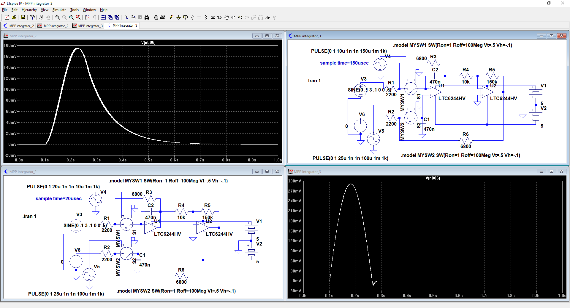

    I'm still trying to understand how the GB circuit works with the MPP integrator. I can't find the spice model of the MPP integrator Qiaozhi posted awhile back. Including a try at a spice model. Target sample(.1 volt, 10 to 20usec). GB sample(.1 volt, 25 to 125usec), no EF samples. To get the target sample and GB sample to cancel I had to make both signals equal value. Normally the GB sample would be maybe 1/10 the target sample amplitude and sampled 10X longer. Maybe someone could explain where I'm going wrong. Thanks

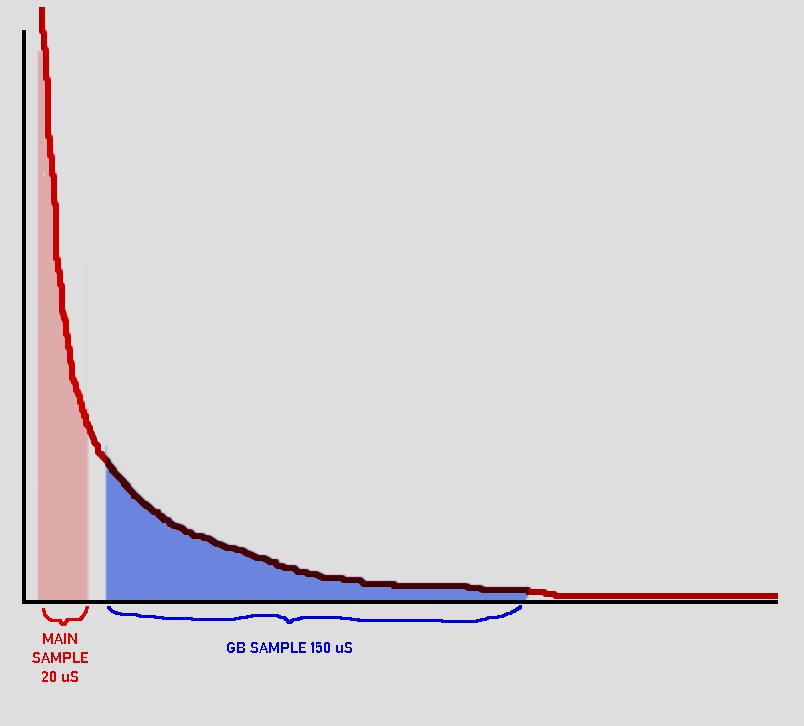

      My simple naive understanding of it is all about area under the curve.
      If the area under the main sample part (pink) is the same as the area under the GB sample part (blue) then they contain the same energy and will charge the two capacitors in the integrator circuit ( C13/C14 ) an equal amount... and the output of the opamp will be zero.
      The shape of the decay curve will vary depending on the soil type, and any combination of main sample time and GB sample time will work to cancel soil as long as the areas under the two parts are equal.

        I like your added circuit for GB. I don't understand how it works with the MPP integrator. The spice model reply #16 cancels with the GB area 10 times the target area. I'm missing something or doing something wrong. Seems like someone on here could help me see why it works.
          Another try at a spice simulation why I think he MPP integrator won't work. Looking at integrator out, same input, 20usec sample time and 150usec sample time. Seems like it wouldn't cancel ground when sweeping the detector with different response times.
          Looking at the simulations I see the first has a 10usec sample instead of 20usec. Play with spice reply#16
            Playing with spice reply#16 I see at least one mistake I made. Should have made the EF sample time same as target sample time and increased EF delay time to 500usec. Still a small difference in response when changing sample times, maybe not enough to matter. Maybe more errors?
              The output you've got for the integrator is a pulse. I've always understood it to be a constant voltage, one that will not change if you dont move the sample (or wave the coil.)
              The sine wave you've got set up on the left, V3, is that mean to simulate the output from the preamp, such as seen at TP3 on the circuit? I'm not sure how that works because on the real circuit, the input (left side) of the resistors R24/R25 are joined together and so fed in phase, but your spice model not doing that. Dont you need your model R1 and R2 to be connected? Look like you're only feeding your R1 with a signal.
              In any case, I just opened up my machine and inspected test point TP4 on the oscilloscope.
              With GB off, TP4 is half a volt or so, and rises to >4 volts if I hold the coin near the coil.
              With GB on and balanced to cancel the coin, TP4 is half a volt or so, and stays at that value if I hold the coin near the coil.

                I'm not saying it won't work with the MPP integrator, just saying I think it won't work. I might have to build a MPP integrator to try with my circuit but first I would like to get a spice model working to learn something. Left some things out with the first spice model that might have caused a problem. Tried another model including target, ground, target EF and ground EF samples. Probably still something wrong, still needs equal amplitude target and ground signals even though the ground sample is 5 times longer to cancel. Maybe someone can see my error.
                Found one error. Looks closer to working, think there might be more. Added another spice model
                The half sine was an attempt at simulating coil swinging over a target.
                  Found another mistake. Looks a lot closer. Now all I have to do is understand where my thinking was wrong.
                    I apologize for suggesting the MPP integrator might not work with GB. Didn't understand how it worked and the spice models I tried had errors.
