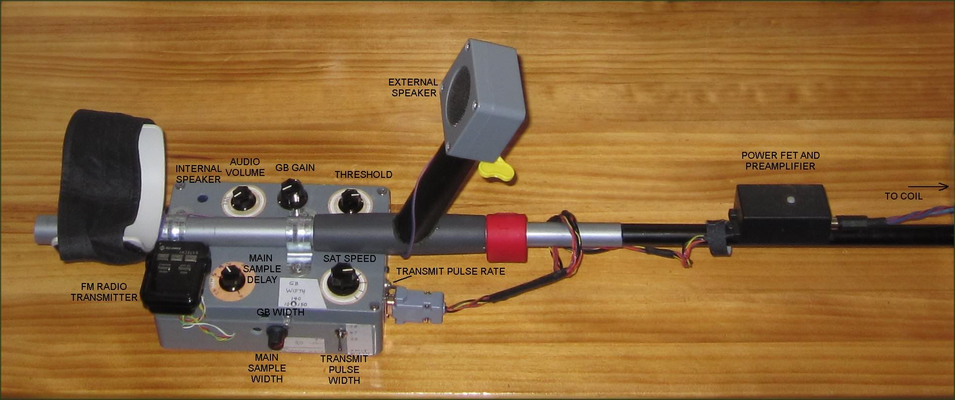

      First the outside, showing knobs and the (see different thread) small box halfway down the shaft with the preamplifier. I've tried various coils, but the one I have at the moment is a spiral wound (from outside to inside, like a vinyl record) 250 uH with no shielding. I tried shielding in the past for other coils but didnt see any benefit, only reduced performance. The added Ground Balance circuit is put in the only available space I had left being directly under the lid. The GB circuit has two controls - the gain control that I will eventually remove and replace with an on/off switch, and the GB width control (on the box side, with no plastic knob).

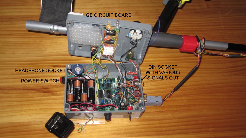

      Inside the box you can see where I have made the new Veroboard based GB circuit and put it under the lid. It only has the two MC14538 chips plus associated resistors and capacitors, and also a header socket for the wires for power and signal in/outputs.

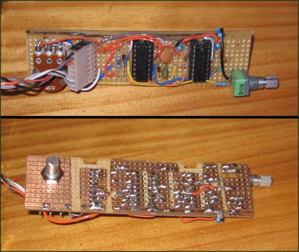

      The top and bottom of the GB circuit board. It is two or three times as large as it really needs to be:

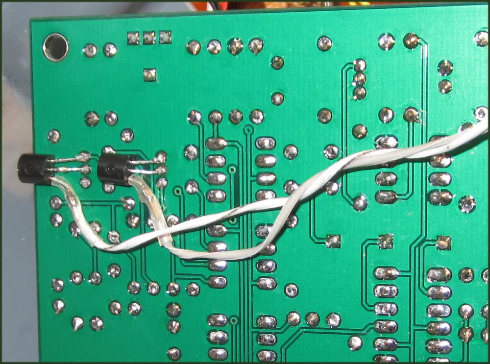

      The underside of the MPP circuit board, showing how I attached the two new FETs in parallel with the existing ones:

      There also a lot to ignore. I havn't found any great difference in performance with Main Sample Pulse rate or width, and the DIN plug just has a bunch of signals (eg. test points) attached to it for ease of access. I'll get rid of all those when I transfer the mess to a fresh new box. Also, the onboard speaker wasnt loud enough, so I have a bigger one temporarily attached via the headphone socket. With any luck, I can also transfer the FM radio transmitter to be inside the box.

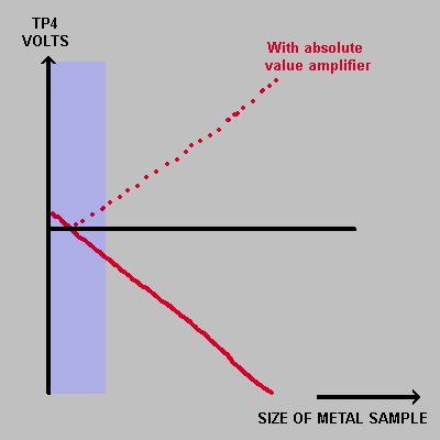

                              As has been mentioned in various threads, one issue found with GB circuits in PI metal detectors is that you can get a hole in the response, depending on the object being detected. The signal created by the GB circuit with the integrator can drive the signal LOW instead of HIGH (as it does normally) making the metal detector go quiet when over metal instead of going beep.
                              A solution often mentioned is an absolute value amplifier, so signals going negative will be reversed and made to go positive as per normal operation. In the MPP, it would be placed after the first integrator (after TP4) but before the second integrator where the comparison to the threshold value is determined. So I built one... but its not a simple answer.
                              In the standard kit, the signal out of the integrator, TP4, is somewhere near zero when no metal is present, and continually rises as a larger chunk of metal is detected:
                              Case1: A small amount of Ground Balance effect.
                              If Ground Balance is switched on but set to a low level, the curve out of TP4 is basically the same except for very large or close objects, when the voltage starts to lower. In other words, an absolute value amplifier is useless because the detected signal is always above the no sample resting baseline.
                              Case2: A medium amount of Ground Balance effect.
                              With more Ground Balance, the drooping signal with larger objects is a larger proportion of the curve. The problem here is that the curve passes back down through the level at which there is no sample, rendering the detected signal quiet again regardless of what kind of amplifier you have. With an absolute value amplifier in circuit (dotted line) you get some signal back with larger objects, but its a hell of a thing to try and calibrate a sensible resting threshold value for.
                              Case3: A large amount of Ground Balance effect.
                              With the dials turned all the way up (large GB pulse width and small main sample pulse width) the curve is the flipped reverse of where we started, the signal increasingly negative going with larger samples being detected.
                              In theory this would be the best case situation because an absolute value amplifier would just flip it back to how the circuit normally operates. In practice it fails because it requires the resting (no signal) value of TP4 to be EXACTLY zero, and also have the absolute value amplifier to have no crossover distortion at zero volts. Neither of these are true in the real world.
                              Consider a MPP kit setup where TP4 reads slightly positive volts with no sample being detected, and this large amount of GB signal inserted. The chart is shown below with the dotted line representing the output from the absolute value amplifier. Because the curve crossed down then back up through the no signal level, the metal detector is unreliably useless (blue shaded area) with small targets.
                              The same problem occurs with a MPP kit setup where TP4 reads slightly negative volts with no sample being detected, because then the machine has the exact same problem when the GB level is low, as per Case 1.
                              So whats the answer? Buggered if I know.
