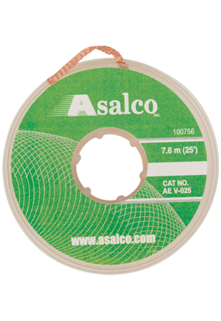

    I managed to upgrade a REV-D MPP to REV-E without damaging any pads or traces. Desoldering components can be a bit of an art (i.e. some swearing is involved).
    Its amazing how good you can get desoldering with the sucker pictured below and Asalco braid http://www.asalco.com/products/elect...oldering-braid
    https://www.youtube.com/watch?v=iWkPNjvPccY
      as opposed to a real de-soldering station like my DS600 ? JS
